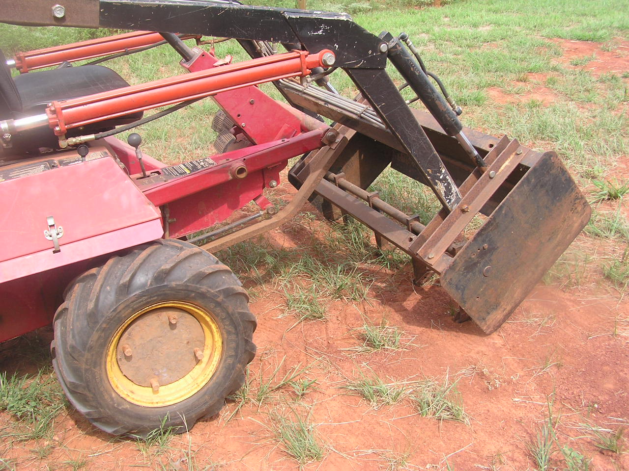

I filled the bottom 1/3 of my busted 60 gallon air compressor with brake disks, drums & other scrap then tossed in a few bags dry. A little water ontop. The rest got filled with sand & dirt. I wanted the cement to help lock in the 3pt hitch bar I welded in a notch I cut on the bottom. It & tape are also is holding a backer chunk of scrap that makes a hole for my QH toplink to fit in.
I didn't fill it all the way due to cost & wanting to be able to adjust weight if I needed to. Or to be able to dump it if it ever fell over (the 60 gal compressor tank is a bit taller than ideal for a ballast box).

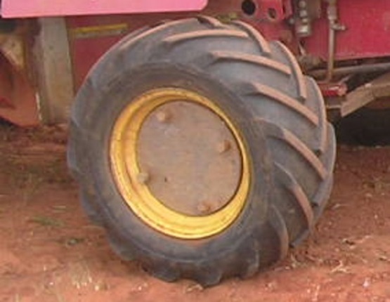

My local cement plant will fill whatever I take down there for free with their overages. I took a ballast box I built down, left it on a trailer, then 2 days later, they called and said it was done. I took them a couple of pizzas for their efforts. I left it on the trailer for about a week to set up, then removed it with my f.e.l. About 2500 lbs. If you have any car repair shops locally, some of them will give away used antifreeze that they store and have to pay someone to haul it off. I put about 100 gallons of it in each of my rear tires. Between that and the ballast box, I can use my JD 542 loader to it's full potential.
Careful if you ever get a leak. Animals love that stuff, but it will destroy their livers & kill them in a painful few days.
