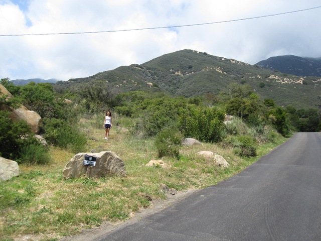

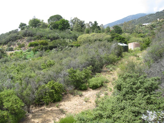

I mentioned 30 year re-growth, I realize in most areas that would be lumber ready for the mill. Here in central California that represents 6 - 8' brush.3-6"
trunks at the base - sage, ceanothis, manzanita, oak,... most of it very hard brittle wood
I will attempt to include a photo of the terrain/vegetation I am working with
Might help to clarify what im up to.
Thanks for any advise

/ Drum vs disc midi excavator
#9
OK, sorry to direct you elseware to view images but best i could figure out.
I hope they help.
water tanks are about 8' tall if it helps for scale.
Thanks again,
Doug
