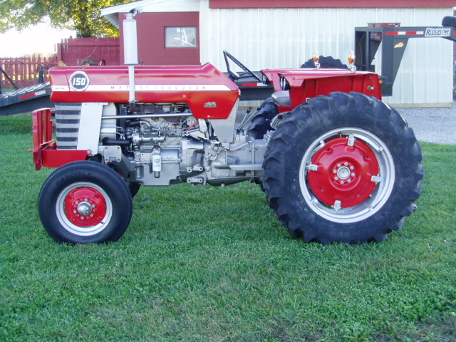

And if you ever decide to remove the ROPS structure, put an airmail stamp on it and send it my way! I sure wish those were available in the US. One needs to be on my 150

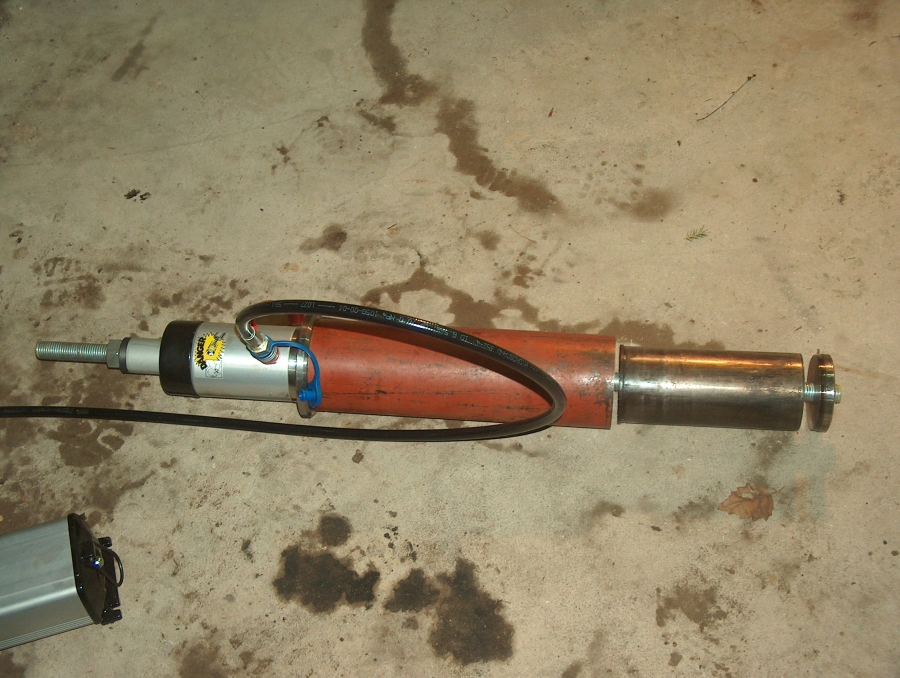

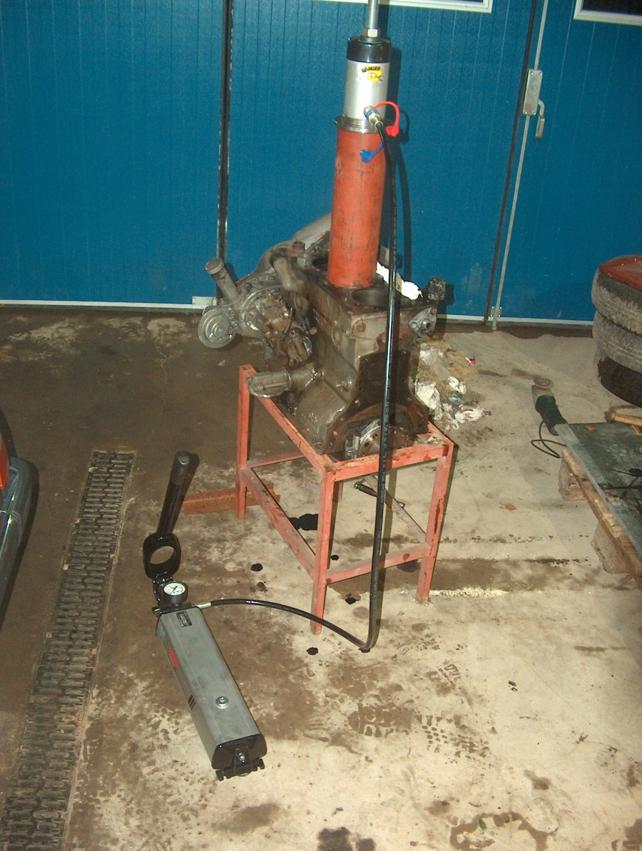

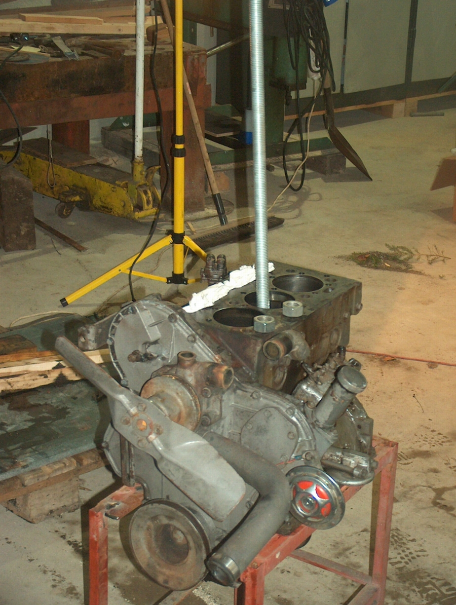

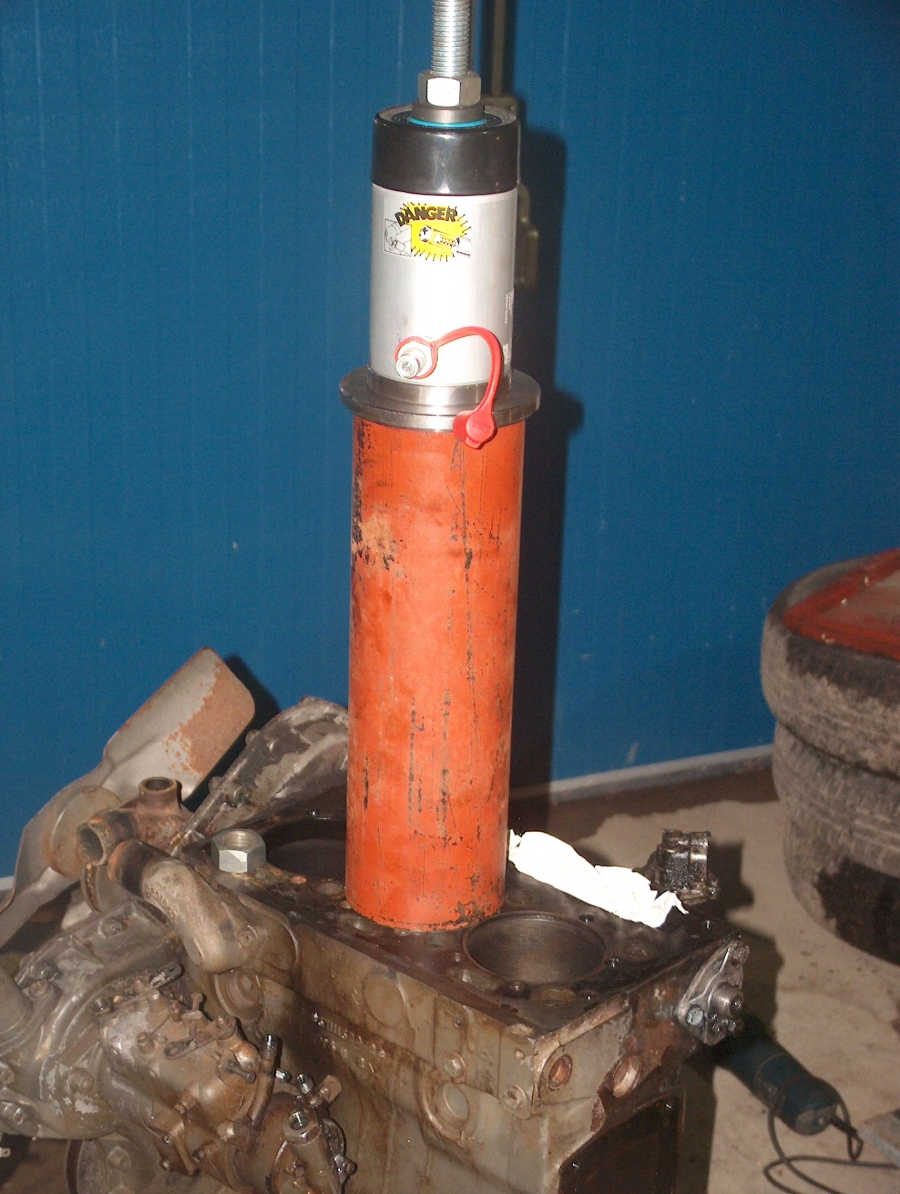

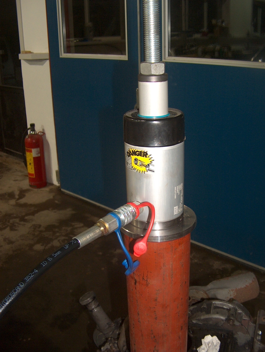

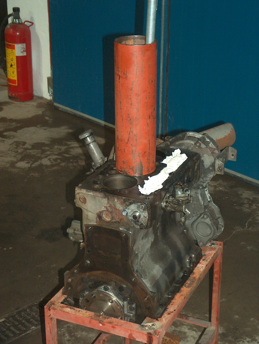

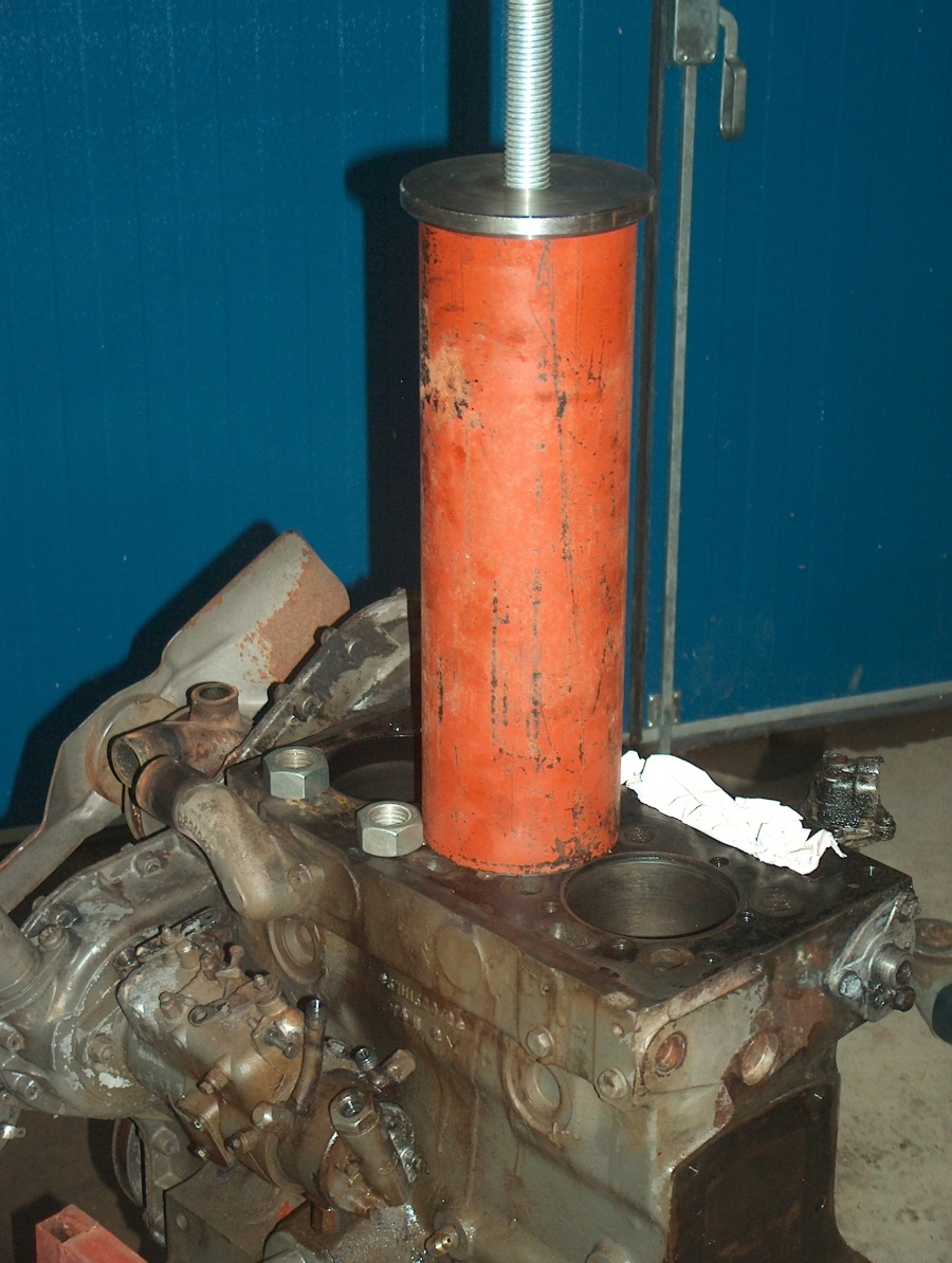

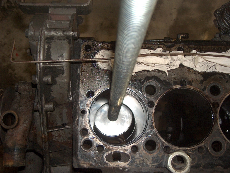

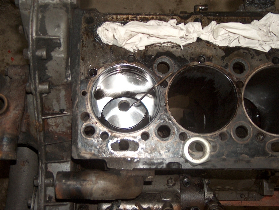

Pulled out the cylinder linings today, using the extractor "I" made the other day.
It worked great!

   / Drug addict and heavy smoker #25
Gunnar-
How's the back of the liners look? Hear about cavition problems and wonder if there is damage. Nice job -Ed
#26
Red55 said:
Gunnar-
These linings are "dry", cavitation cant occur.

   / Drug addict and heavy smoker #28
pack the new liners in dry ice and they should slide right in, we would put a old bulb style drop lamp in the cylinder to give it just a little heat before we put the liners in. worked great for years
   / Drug addict and heavy smoker #29
Liquid oxygen or nitrogen works good too. I would not use it in an enclosed area though.
