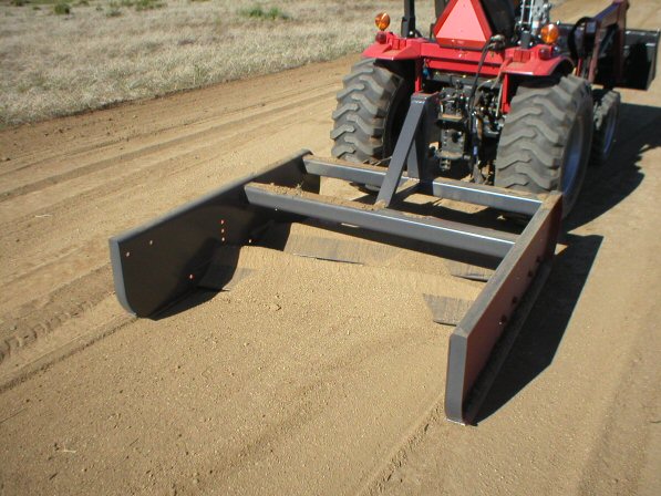

/ driveway #6
If you are up for purchasing a new implement, this type will take care of most of your needs. Typically makes road maintenance a breeze. :thumbsup:

/ driveway
Yes I have seen those land planes but they are pretty pricey. Next purchase will be a quick connect and some weights.
/ driveway #8
That thingamajig old MtnView posted is the ticket!! I have a rear blade, but just got one of those from an old boy in northeast Mississippi for $500, brand new. Another old boy in Alabama makes them. Let me tell you, those things do the job!! Love mine. Land leveler, or some such, that's what I think it's called.

/ driveway #13
I second that vote for a land plane! Mine is the best attachment I've ever bought. It makes quick work of my 1.5 miles of driveway and my neighbors additional 1 mile. This summer I put down 240 tons of roadbase with it.

/ driveway #19
As much as you do not want to spend the money, get yourself a land plane grading scraper (LPGS). You will find that it will cut your road maintenance time by half at the minimum if not more. And because of that, your road will never be bad again, at least not for very long. All of these washboard issues are typically taken care of in a single pass. When the road is nice and takes a small amount of time it keep it that way, you do and therefore is always nice.
Trust us, everyone of us that have LPGSers would not trade it off for anything. :no: Heck, some of us have more than one just for different applications. :thumbsup:
