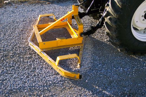

YES, IT IS COMPLETE AND WORKS GREAT.
What size material are you using for the "blades"?
6" C CHANNEL (NOT SURE ON WEIGHT) THAT I HAD IN THE SHOP
If you added some brackets to the front blade, you might be able to add in some small "scarifiers" to help loosen the material up as it's graded. Think they'd only need to go down 2 or so inches, maybe one every 8" or so...........
SO FAR IT WORKS GOOD WITHOUT THE SCARIFIERS BUT IF I RUN INTO PROBLEMS I WILL THINK ABOUT ADDING THEM. I ALSO HAVE A BOX BLADE WITH SCARIFIERS AND A 3 POINT TILLER IF I DO NEED TO LOOSEN THE GROUND.
ATTACHED IS A PICTURE OF A SIMILAR SCRAPER THAT THEY SELL FOR $800 OR SO, I HAD $50 DOLLARS IN MINE.
/ DRIVEWAY SCRAPER #9
Oh, ok, mostly for smoothing of gravel. I had it in mind as a DuraGrader type with dual (abrasion resistant) grader blades (not just plain hot rolled channel). Bet it does work great!
If the channel wore pretty fast, I noticed that my local steel yard has ¼" AR400 steel in 8' wide sheets, sheared to any length for $1.60/# ... that would be a reasonable way to get some quick and easy durable edges.
Cheers!
/ DRIVEWAY SCRAPER
I THOUGHT ABOUT THE WEAR PROBLEM AND IF IT DOES I WILL JUST BOLT ON SOME ABRASION RESISTANT STEEL PLATES TO THE C CHANNEL.
