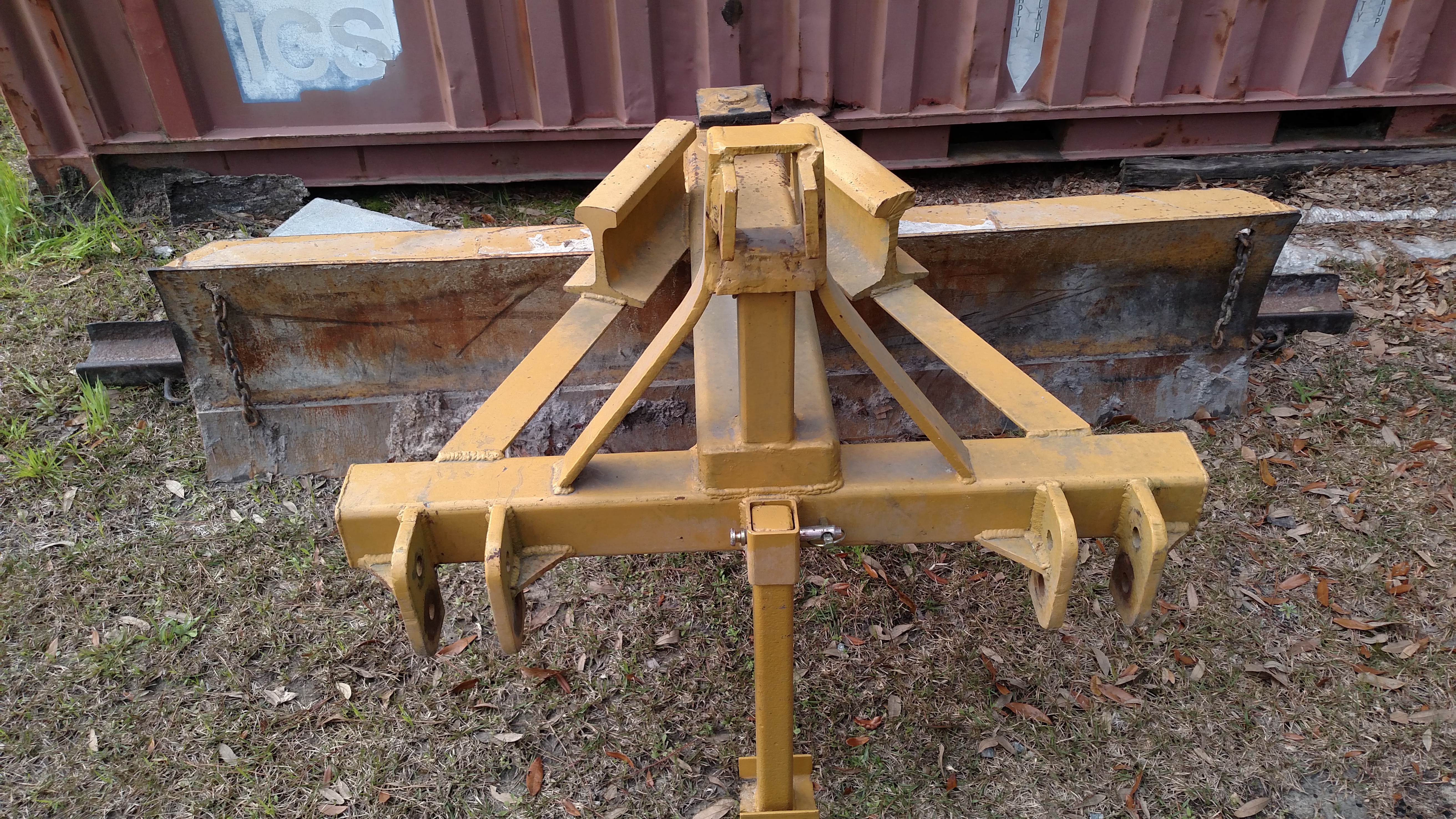

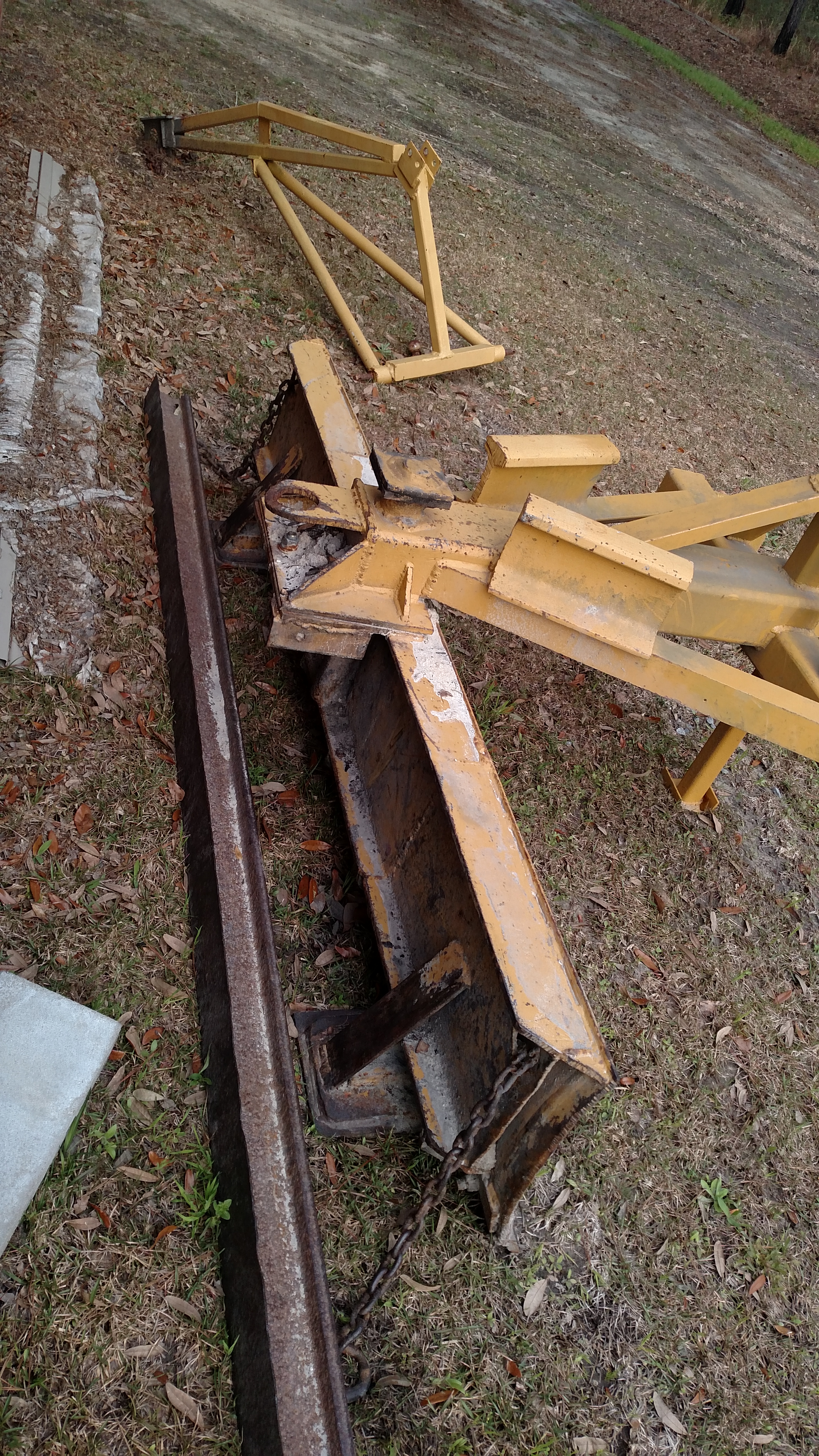

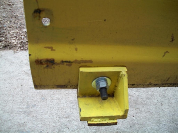

Never used agritek... I just have a very heavy scrape blade, I welded drag pads basically flat plate steel to the back... Then if I don't want a big bite on the blade, I just adjust the top link out a bit. But those look like they would work fine, on the woods are the rippers removable?
Added some pics for y'all's viewing pleasure.
