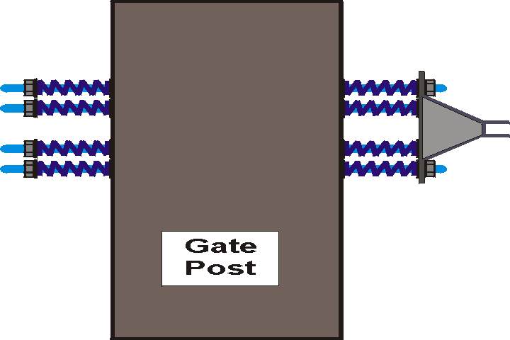

/ Driveway gate openers ??? #10
</font><font color="blue" class="small">( Also, I think I have an idea for a spring-loaded mounting of the actuator to the post which will reduce the instantaneous shock load to the actuator. ...and yes, it looks like the Mule from TSC.)</font>
It isn't the shock that kills the operator. It's the operator is a knife in a gun fight. Look at the mounting hardware and bracketry of a good operator and then at what the Mule comes with. It'll become instantly crystal clear.
Sometime grab a heavy gate where the operator attaches to it. It takes a real piece of equipment to initiate movement and even more to stop it.

/ Driveway gate openers ??? #20
As you can see from my last post, the operator has no shock damping whatsoever. What I'm suggesting to absorb some of the shock is shown in this attachment. I've exaggerated the lengths of the fasteners for illustration. The attaching hardware for the operator would be able to move against the springs and not have a sudden shock to the aluminum cast parts.
