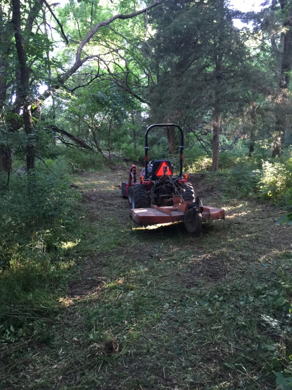

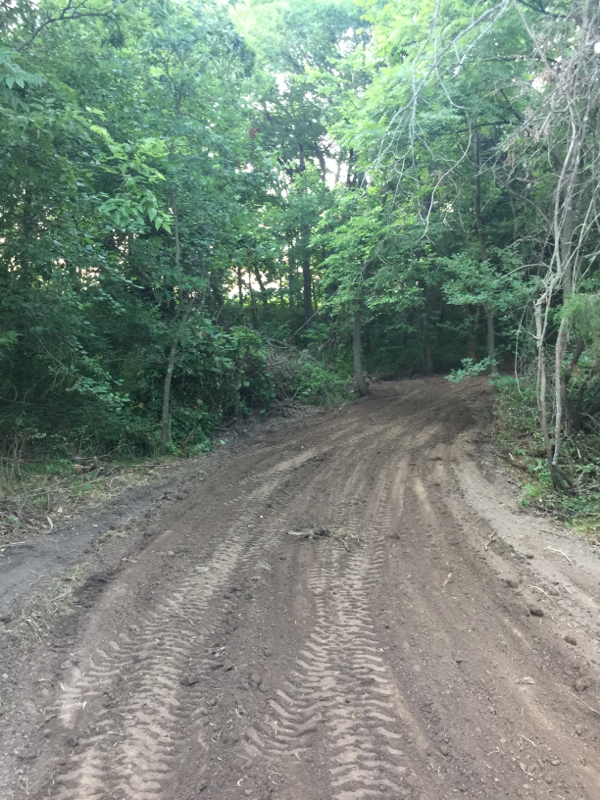

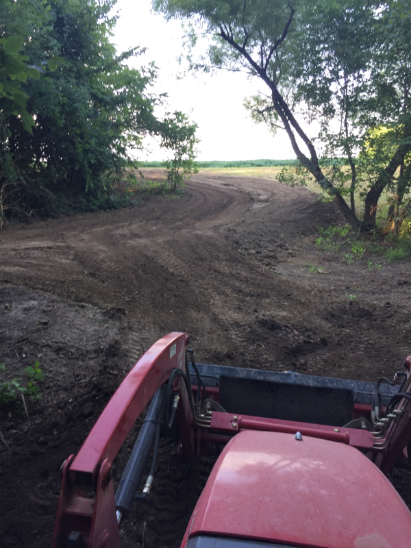

This is the start of the driveway for our new house build. I'm using my Mahindra Max 26 and a 5' box blade.

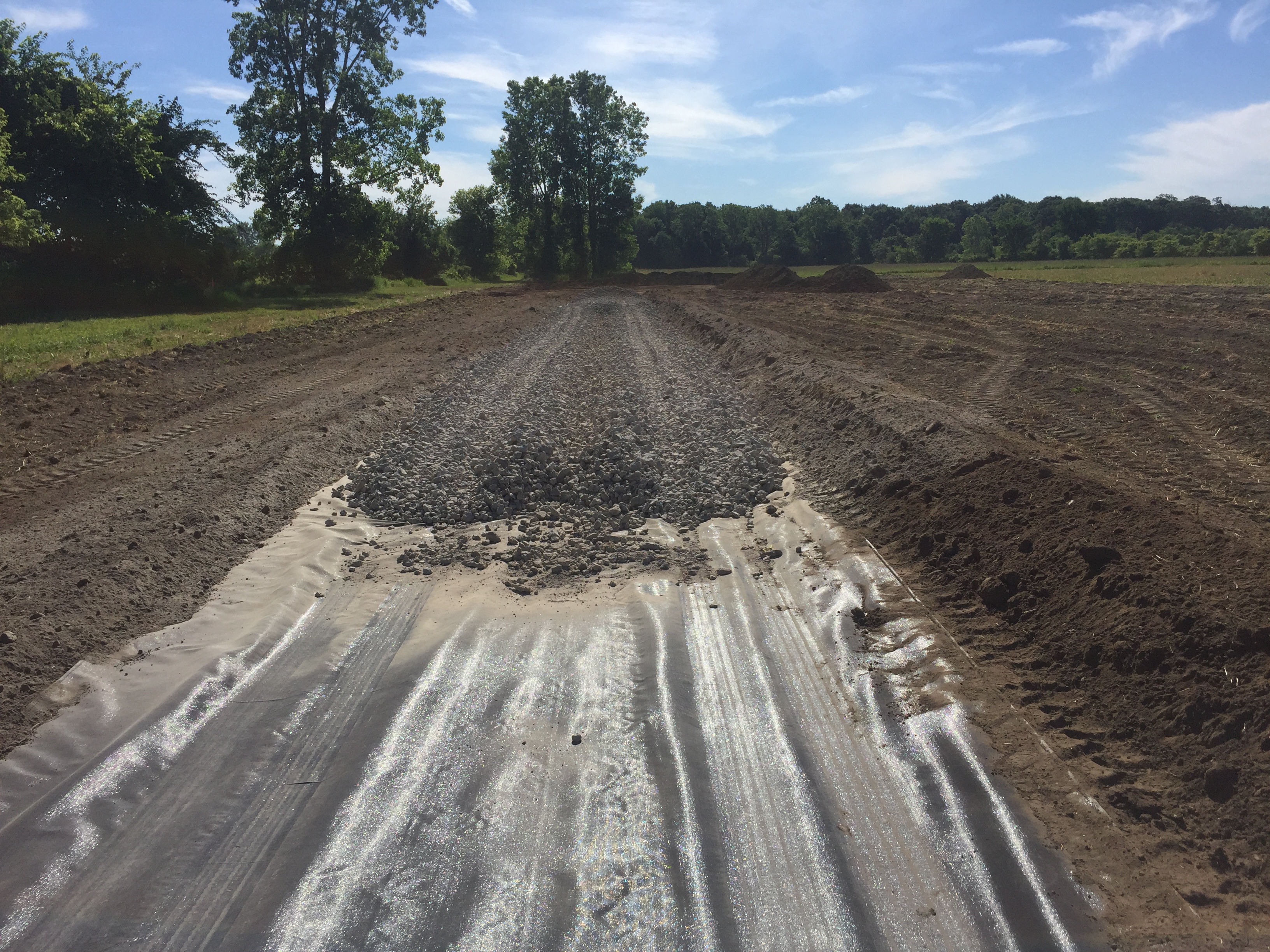

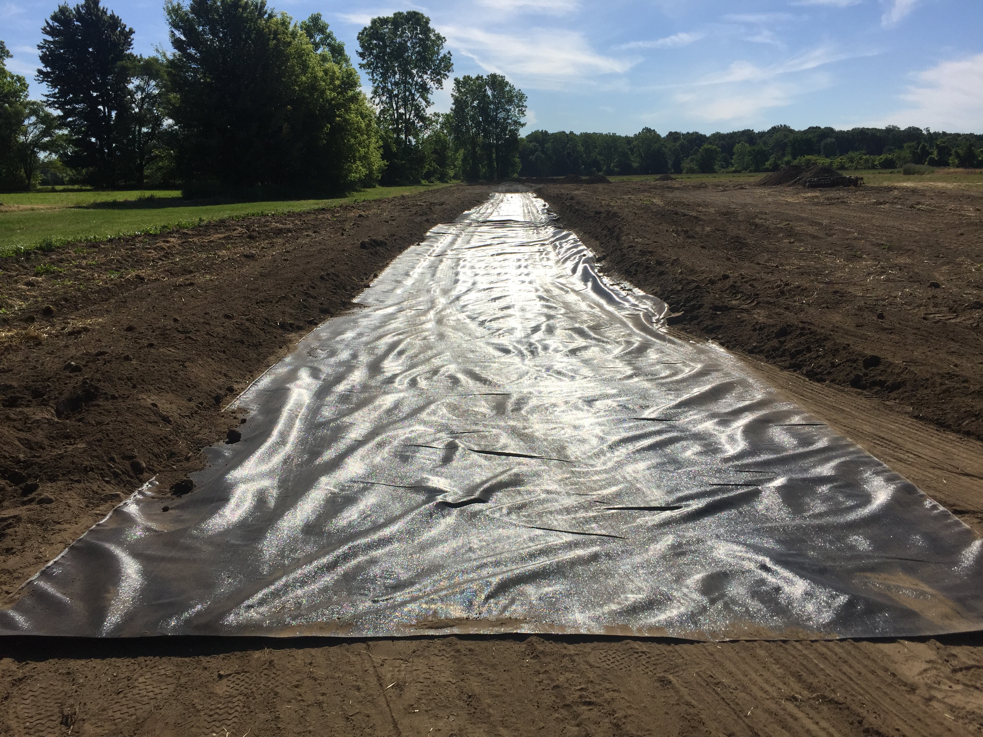

That looks great. How much top soil do you have to remove before you hit sand or clay? I had to go down 11"-13" for 600'. I brought in 170 ton of in 1-3" crusher run for a 7-8" base. I'll top it with 6" of millings next year.

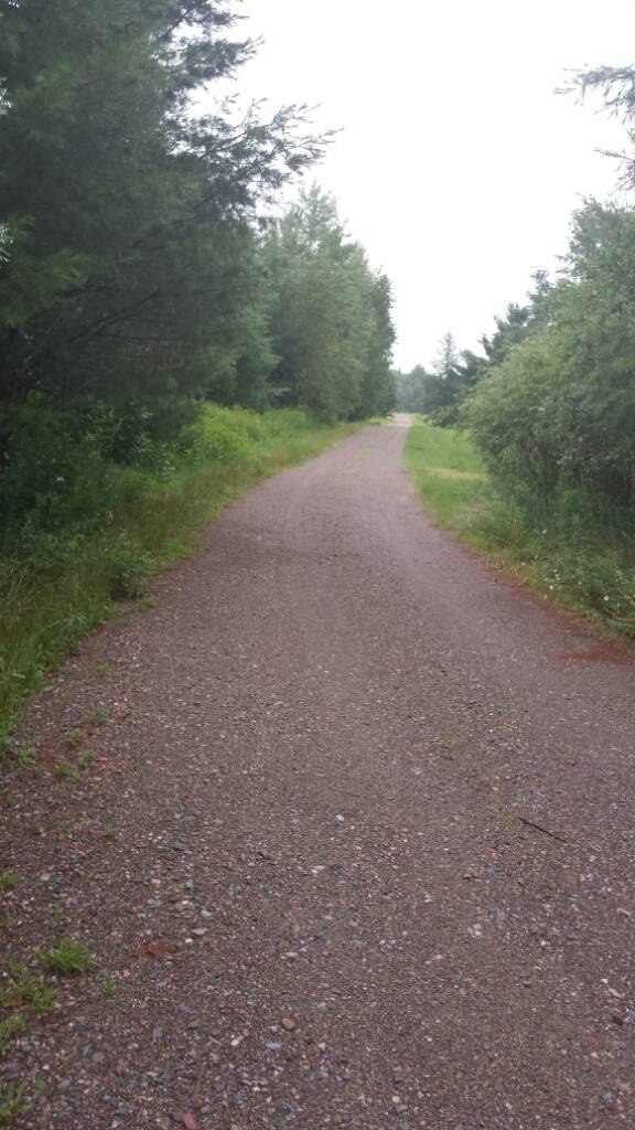

In our area "millings" are asphalt milling - the old asphalt they grind off the road when they resurface them.
   / Driveway build #7
Millings when exposed to hot sun will re-bind and give U a 'near asphalt' drive, not like true asphalt bet great for a private drive.
On slopes , unlike crushed stone, millings don't wash away being kinda glued together.
For a top notch job a roller compactor is the way to go.
Good news is re-cycled or millings is cheaper to buy than crushed.
I did my hilly drive 20 years ago with re-cycles and it still works for me although it has many cracks in it now, the main thing being that I never need to grade as I did with gravel.
