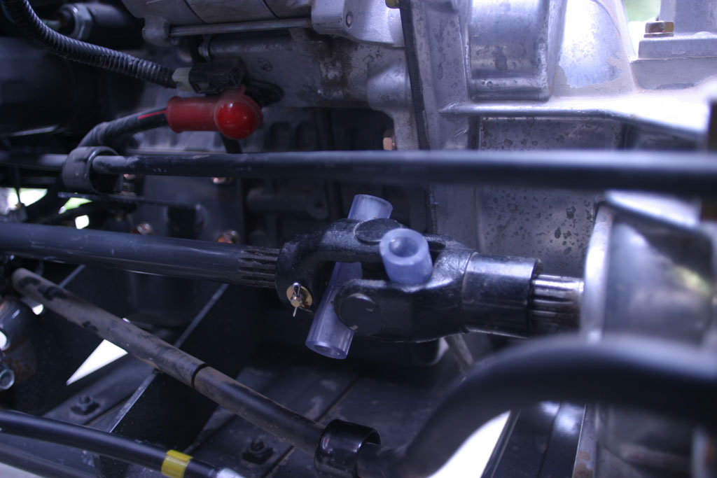

Here is my temporary solution for the drive shaft rattle on my RTV. Shoved two lenghts of heavy-wall vinyl tubing on each side of the u/joint cross. The tubes don't even come close to touching the u-joint seals. Works great! /forums/images/graemlins/cool.gif Can hardly wait to see what new design Kubota comes up with to fix this problem. Oh, the tubing is 1/2 inch ID.

I checked my machine today and the yoke that goes over the splined output shaft certainly wiggles a fair amount. It doesn't seem to rattle, but I only have about 35 hours. The deep snow this winter really put a damper on my use. The tolerances on my other machines with such splines are certainly tighter. Should I just plan on replacement? I can't really see how those pipes are alieviating the problem.
