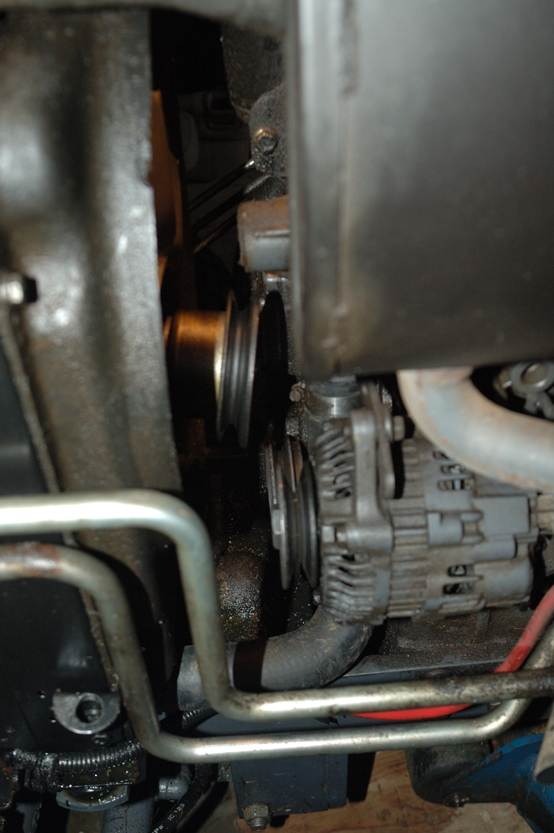

I wouldn't think this can happen. While going through some light duty mowing, the engine compartment all of a sudden went really quiet but it was still running. Short while later, overheating began. I stopped it right away and was able to save the engine. It turned out that the fan assembly came off the pulley and the belt was just sitting there. I looked at it closer and it looks like the shaft actually sheared off (judged by what I saw where it broke off) leaving its end still inside the mounting hole. Has anyone seen this before? Do you have any suggestion on what to do next besides calling the dealer?

How about some pictures please. The shaft from the water pump and the fan blade is 3/4" in diameter on my NH TC 35. Could it have been that the 4 bolts that hold the shaft onto the water pump output pulley all fell out?

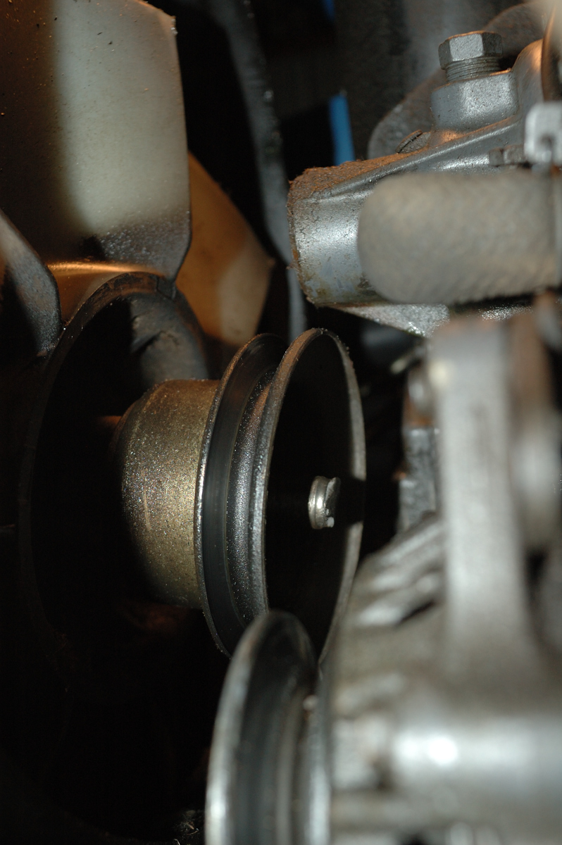

So, from the images, it looks like the water pump is intact. Note the shaft now ends almost flush with the backside of the pulley. I stuck my finger inside the mounting hole. It goes in about an inch and it's filled with grease and other gunk. There was a small metal piece that was in the gunk that I fished out of there (like the size of a 1/16" round or almost round thingy; it fell on the ground so I didn't actually look for it unless it's important).

I uploaded two but only one showed up. Here is a closer up of the fan assembly with the pulley.

Just called the dealer. He thinks the water pump is shot and he thinks the drive shaft did shear. That makes sense. That also explains why I was not able to stop a coolant leak by replacing the radiator hose. Any other ideas or comments?
