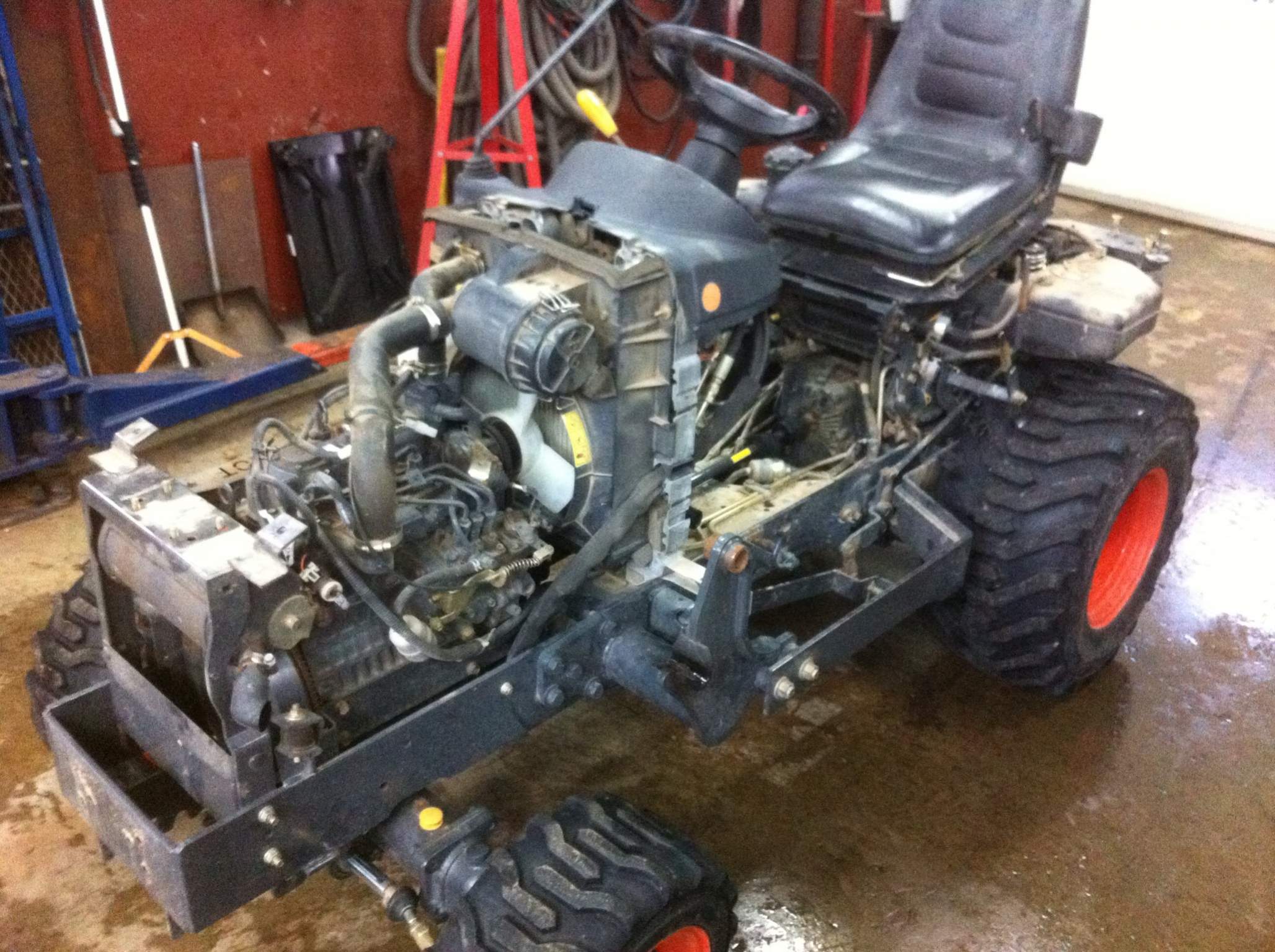

Anyone following my other thread about rear cutter size knows that we've been talking about protecting the underside of our tractors and while I've already ordered a skid plate it wasn't soon enough. During the 15 or 20 minutes that I played with my new tractor I managed to break the drive shaft fan and tore the shaft boots. Monday I need to make some phone calls to see about getting repairs. I saw the quicker methods of split fan and screw on blades but the tractor is in such good shape and even though I know it is going to be costly I think I should get it repaired properly and then the new skid plate should keep it from happening again. At least I should be able to get it repaired before the weather warms up and I would want to get using it.

My initial reaction was to have a dealer do this repair, but upon further reflection I've decided to tackle the job myself. It will give me a good chance to really get to know my new to me tractor and save me $660-$700 dollars. I've seen a lot of the threads on this job and my most trepidation comes from having to move the engine as I don't have any kind of a lift. I did see one write up of someone who stated that a lift wasn't necessary so that gives me hope. I've ordered the parts and have to replace the dust seals as well, I hope that doesn't turn out to be too difficult.

I put a new fan and boot on a BX24 a few weeks ago. The owner of the tractor took the body work off because he needed to repair a cracked floor but he brought me the tractor. It was still a sizeable job. I removed the motor from its mounts and pulled it ahead about three inches to get the driveshaft out.
Worked out well but a stupid design and a pile of work for a $20 fan.

Do a search here on the driveshaft fan replacement. Lots of info. I replaced mine without moving the engine. It barely fit, but I didn't have to force anything too hard. Good luck!

The newer tractors are different and the engine must be moved.
