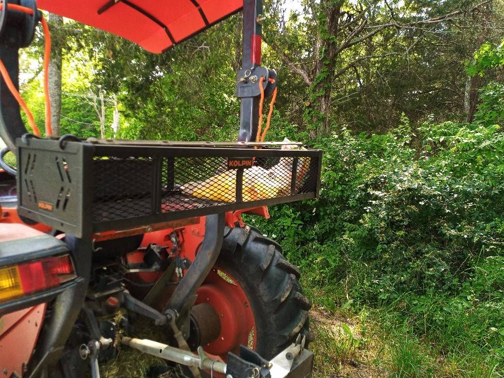

Kopliin ATV rack + 4 U-bolts + 10 minutes time = great little tool/cooler/chainsaw hauler with minimal visibility impact.
The orange danglies from the ROPs bolt holes are giant rubber coated twist ties that I wrap around tool handles to secure them to the ROPs.
It isn't fancy, but it works.

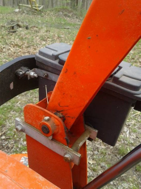

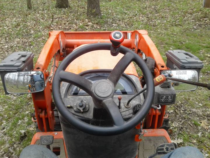

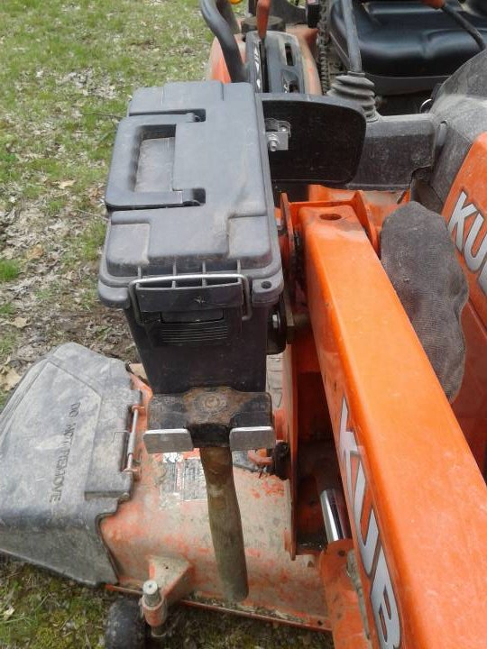

Double sided tape & cork on aluminum straps to protect painted FEL or so I hope.
Used these for box mounting plates

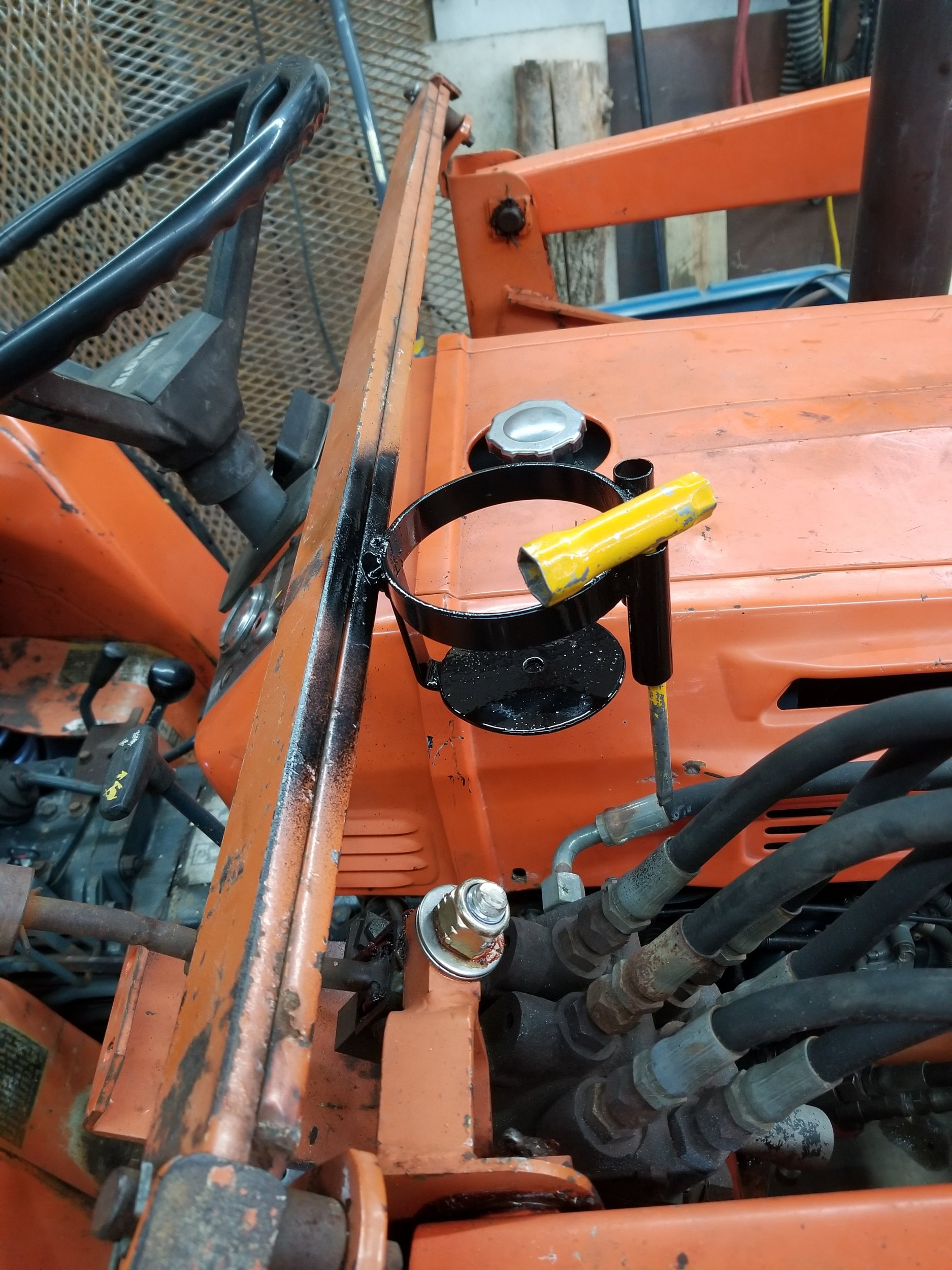

I ended up making my own. It's big enough around for a can with coozey or a nalgene bottle and has pieces of pipe for a screw driver.
Thank you for posting these images. I have been looking for a way to mount a mirror on my tractor. I have a bxpanded toolbox mounted on my ROPS. It never occurred to me that I might be able to mount it on my FEL support and then mount the on that. I will have to see if there is clearance enough to do this next time I have the FEL on.

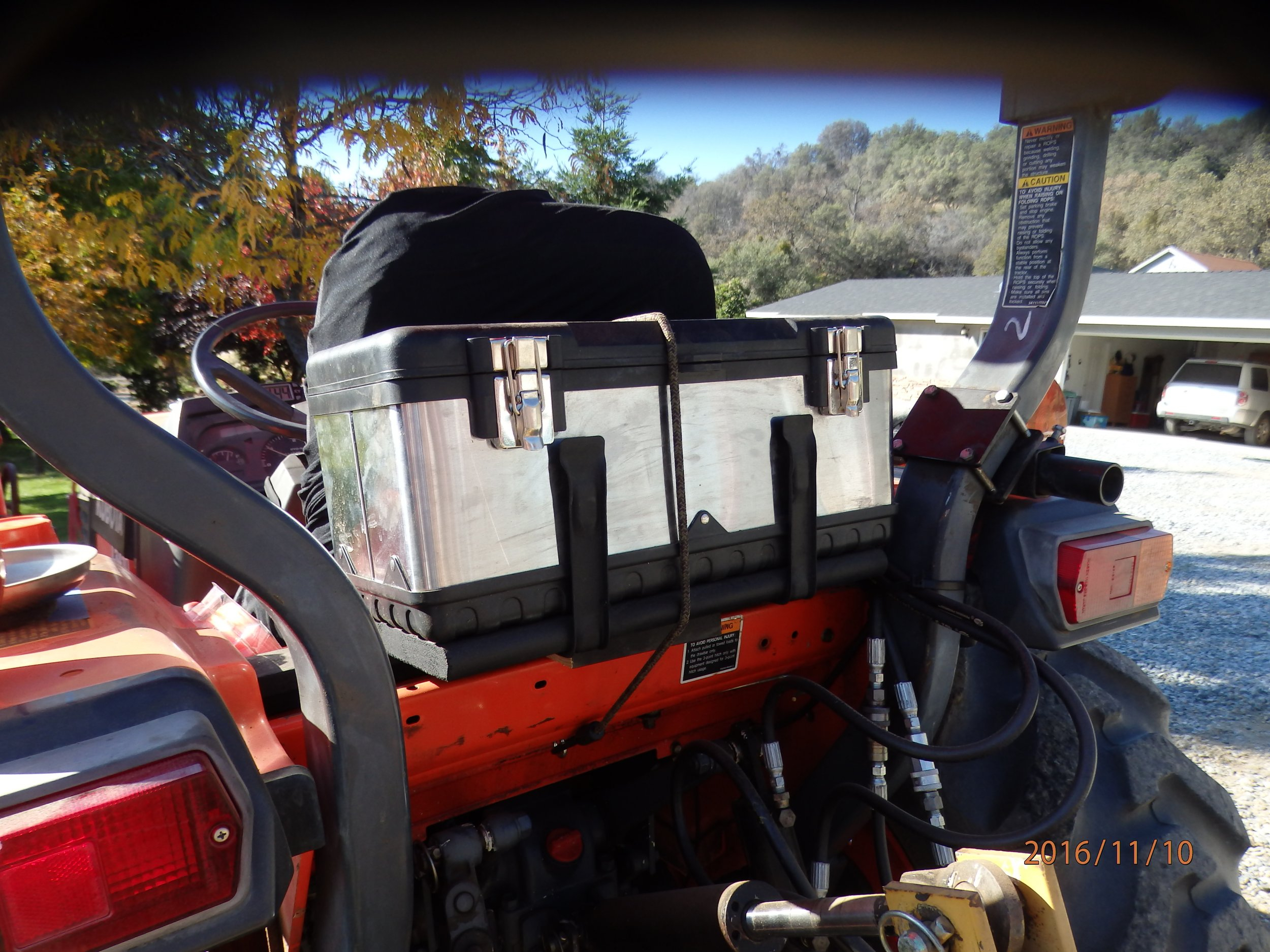

And for tools I was able to attach a Harbor Freight tool box behind the seat of my L3410 - built a small wooden platform and added a couple of L brackets and a bungie. Works well and really useful.
