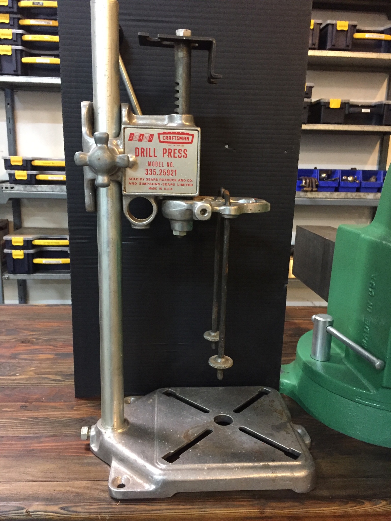

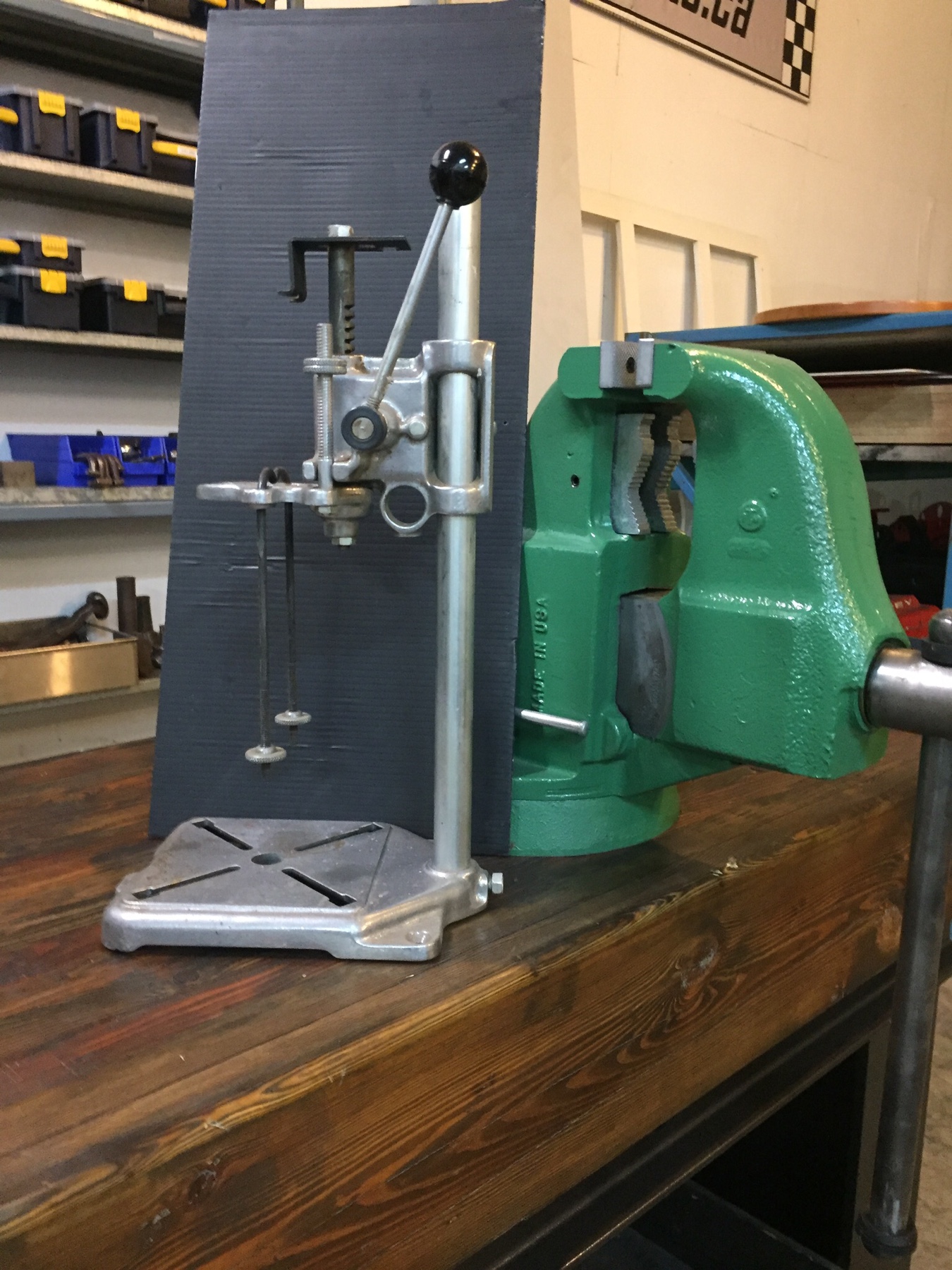

I need to drill three 5/8" holes STRAIGHT through my 7" bench top to mount my vise. I didn't want to use lag bolts as the vise weighs 157 pounds.
I picked up these two drill press devices (one Craftsman the other Black and Decker) today for $5 each. I'm hoping one of them will help to keep the holes perpendicular. Something like that MAY work for you?
Otherwise as others have mentioned, it's pretty hard to beat a mag drill for steel. I only purchased mine lately, but I wish I had done it 40 years ago. :(
Keep in mind though you will probably need an arbor adapter and Jacobs type drill chuck for holes UNDER 7/16" as the smallest annular cutter will be around 7/16".
   / Drilling 1/4" and thicker metal with a hand drill #8
Adapt one of those so it can drill through the base, if not already able. Then clamp or ratchet strap it into position. You could make different shape bases for a job if needed. You could use a ratchet strap to apply pressure, too, as long as the drill holder keeps it at 90 degrees to the work.
Bruce
Bruce:
The Craftsman base already has a hole through the base that will allow my 5/8" bit to pass through. I thought for 10 bucks I'd find some alternate uses for them in the future.
Before I bought my mag drills I turned the headstock on this cheapo drill press 180 degrees and clamped it like you were suggesting.
