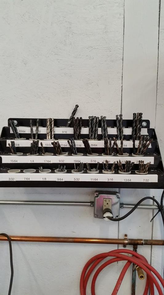

I built this pout of 2" tubing holds 36 sizes and mounts on wall next to drill press 20800058_270157813501443_8027228425336698255_n.jpg

I like that. The only thing I would add would be a sizing gauge so I might get them in the right spot. And I would have to chain it to the rack or it would be just as gone as most of my 1/4" bits. :)

I have a gauge it hangs on the drill press right next to bit holder

Very nice, I have been looking for a solution to the multiple-bits-the-same-size problem, that one looks like a winner.
Will have to figure out what to combine with that for spade bits, spur bits, and forstner in the wood shop, but as-is in the garage where I do metalworking it will be a big help.

Can you give a little more build detail please?

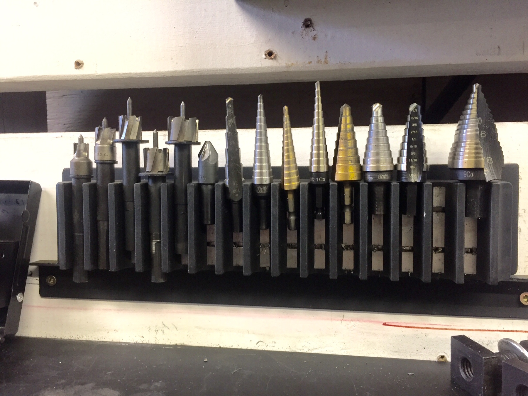

I use a magnetic tool holder for my sheet metal cutters and step bit drills. They MIGHT be helpful to store your spade bits etc or??

That could work! I could probably make something similar with some of the magnetic knife holders from HF and some scrap wood...

I used thin wall 2x2 tubing I drilled 1"3/4" holes then used 1"1/4 electrical pvc coduit for liners I welded the tube together stepping back like steps.I then welded 3" flat bar up both side to seal up ends of tubes and to tie them together then I welded 3" flat bar across back at top to secure to wall then I welded a piece of pipe on the back of the bottom tube to hit the wall and give support very happy with the way it turned out very solid hope this helps

The rack looks neat and very well constructed. However, I'm a 'bit' confused by the concept.
Why do you want to mix bits of the same size? Are you not mixing older, duller bits with new and sharper bits? I would have thought that a neat standard holder for one of each size next to the drill press, with a stock of new/re-sharpened bits in a different holder (like the one you have made), would be more efficient.
Besides, why do people need so many bits of each size?

I have a drill press, milling machine, engine lathe, and a bunch of corded and cordless drills all within my "metal shop" space. I have another drill press and more hand drills in my wood shop space. To me, having a dedicated "in use" organizer at each tool makes less sense than one big organizer in each shop space.
Also, for any given size, I may have several each of jobber length, screw machine, brad point, forstner, and spade. Possibly in 118 and 135 point, and sometimes bullet point. Sometimes in HSS and carbide. In full shank, S&D, and morse taper shank...and square taper brace-and-bit. Sizes can be by 64ths, letter and number. I think I bought a box of metrics recently, if I can remember where I put it.
At the moment my current organizer is a shelf with a couple of half full indexes, a bin full of taper shanks and large sizes, and a pile of loose bits. Plus a pile "in use" next to whatever work surface I am using, which may eventually get put back. So this setup would be a big step up for me.
As for dull bits...if you are an organized person, why would you put them back in the organizer, and not, say in a "to be sharpened" bin next to the sharpener? Granted, my dull bits usually end up in the pile with the rest...I tend to check the edge on my thumb. The broken ones end up next to the sharpener...

Makes sense now. Thanks for the info.
