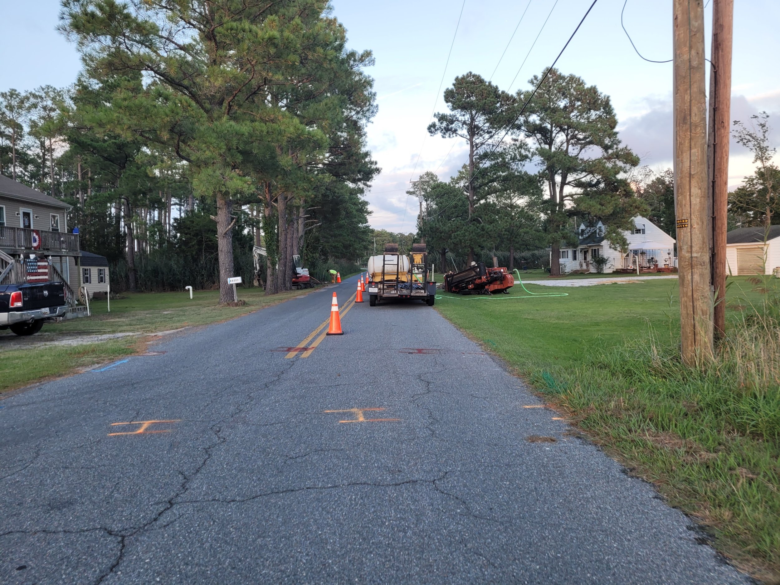

I added this horizontal directional drill to my fleet. It's an older unit but has been gone through and works well. This was a 70ft shot I did with my employee and the dude I bought it from showing us how to operate it. The next day we did a 325ft bore without any guidance and it went perfect. Went about 8ft deep at one point to dodge a sewer line.
Very excited about it. I have more drilling to do but had to take the machine home to do some adjustments on the pipe loading system. It holds 40 10ft pipe segments so you can drill about 380-390ft with it. It can backream up to a 26" diameter hole which is pretty crazy. Right now I'm just pulling one or sometimes two 2" diameter pieces of conduit. View attachment 819611View attachment 819612
It pumps in high pressure water during the operation so somethings things get muddy. (I've take off my boots at this point)
Umm, when you say "with out any guidance" you mean no instruction Right? We aren't talking old no Sonde, push at 6, for 2 rods, drill for 2 rods, and push at 12 for 2 rods, are we? That's some old school sketchy stuff if that's what you meant.

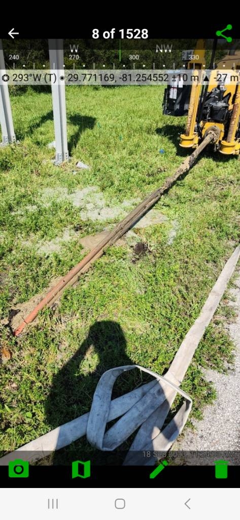

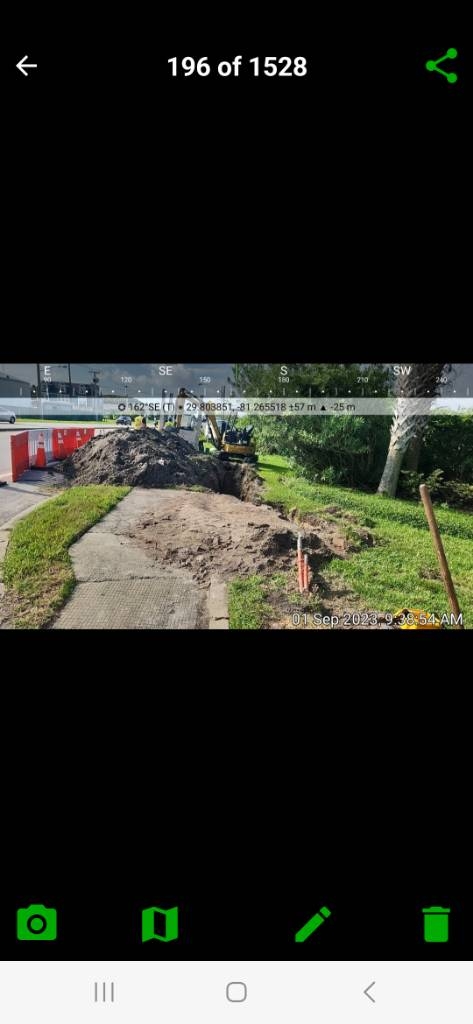

The first picture is this Monday, about 300 lf, 3-1.25" conduits, and all without issue, 2nd picture is the splice pit from where same crew a few weeks ago got into a duct bank, at 9ft deep. They claim locates where off, but one way or the other ATT will be sending them a bill with several Zeros on the end of it, and let them fight it out.
No I'm using a sonde and locator! Just meant drilling without someone experience helping.
