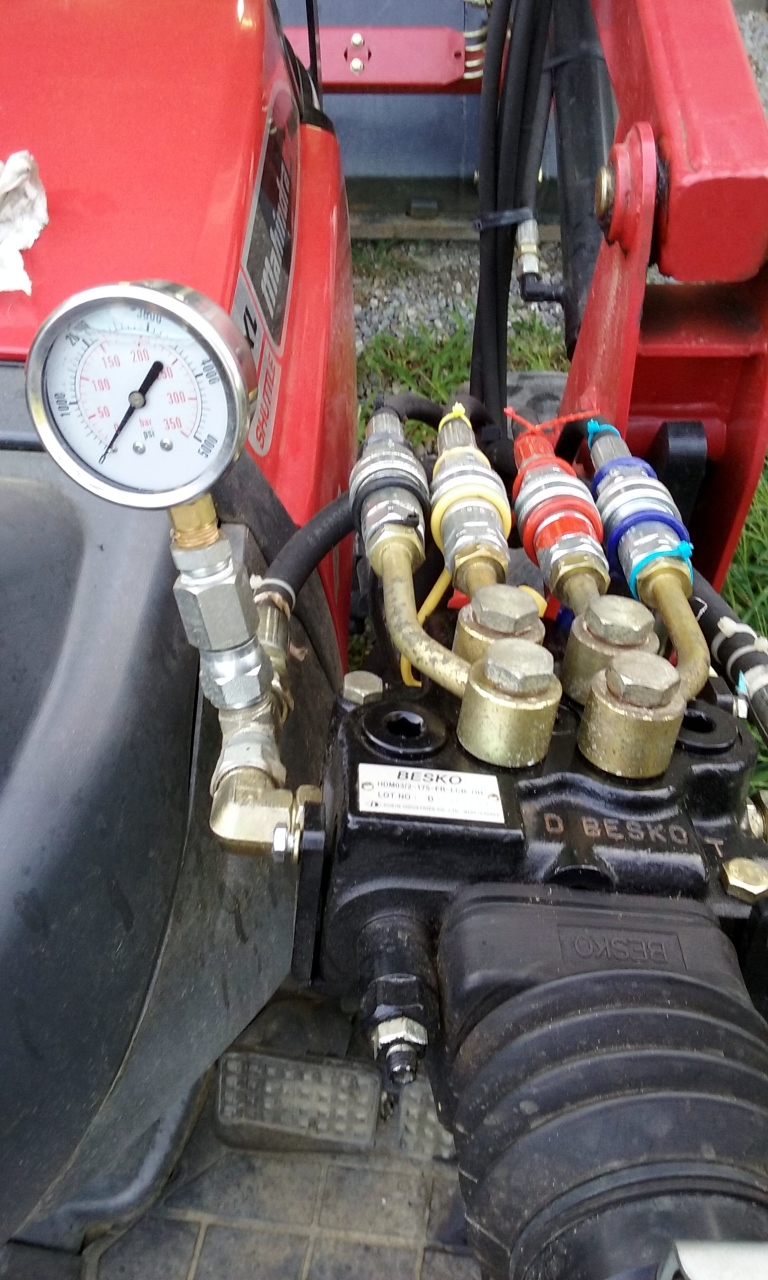

You can pick up a few hundred pounds of Loader capacity for the cost of a 0.03" thick stainless washer in the relief valve, a few fittings and a pressure gage. (Plus the cost of loading your tires.) Keep the relieve valve set to about 2,500 Psi. max and you will not have issues. I have mine set to 2250 Psig.

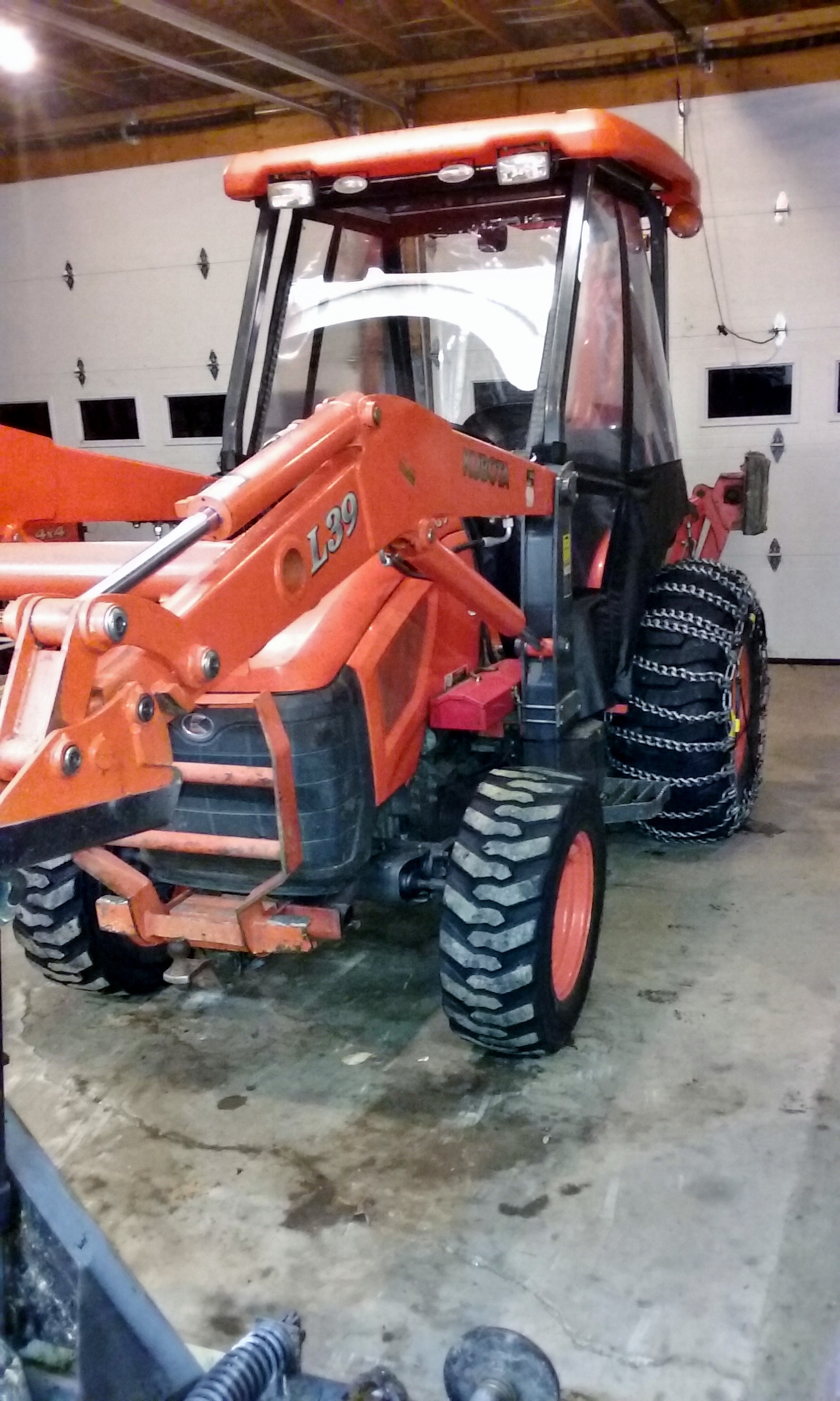

Best addition I made to my L39 was a soft cab.
