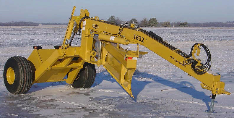

That trailgrader is impressive. The part 1 video shows some real rough road to grade and I can only wonder how long it will hold up with the imbedded rocks. Seems it would be super for a drive of gravel.
The weight will be important, supplied well with the water barrel. The length between the rear wheels and the tongue connection is also good for a level road bed.
Along with digging the old gravel up, then smoothing it out and not forgetting to pack it down before the gravel loses its moisture, this grader idea is a great one to have a good drive.

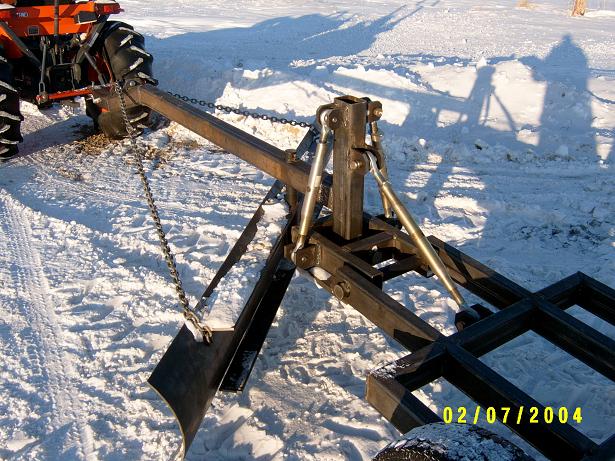

Yes. The wheels are about 2 feet from the end now, but I am thinking of a way to raise and lower the frame for height adjustment. Two trailer jacks, or hyd cyl. I believe this trailer was a jet ski or small boat. trailer. A longer boat trailer would work also. If the blade is in the middle, the blade would only raise half as much as the towing vehicle when going over a bump. After running over that bump several times, it would disappear.
   / drawn road grader #12
I guess I figured the 3PH would suffice to raise/ lower the blade ... Not good enough?
   / drawn road grader #13
If the blade is mounted solid, you lower the 3pt to cut the tops off the hills, and keep lowering on each pass. If your tractor can pull a lot, it won't take as long. My Kubota is only 22 HP, but 4WD. A barrel of water will help to keep the wheels on the ground.
