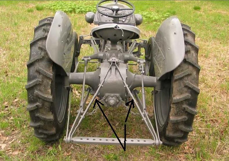

I've got a TYM25 with 1.5 hours on it. While tendering hay with an old Grimm #8 that is quite center balanced, the tedder tips back and up comes the drawbar and hits the driveshaft from the PTO. I somewhat solved that problem, but now I wonder how your going to use this tractor do hill up a row of potatoes without having downward pressure on the drawbar. I have not talked to the dealer yet, but I might have the wrong tractor for my needs. What's your thoughts?

I'm not familiar with your tractor but from your description you are pulling from a drawbar mounted to the lift arms. You should have a fixed drawbar lower under the belly of the tractor, low under the rear axle housing.

If you intend to use a drawbar mounted to the 3 point lift arms then you need to put some "Stay Bars" on it to keep the drawbar stabil. Here is a pic of some on an old Ford, they are usually available at most farm stores and are adjustable so they can be used on almost any tractor with a (Cat1) 3 point lift.
Makes sense. Good to know. I still wonder how to fill a row of potatoes without that downward force. You need to dig in to get enough soil to and cover the row.
