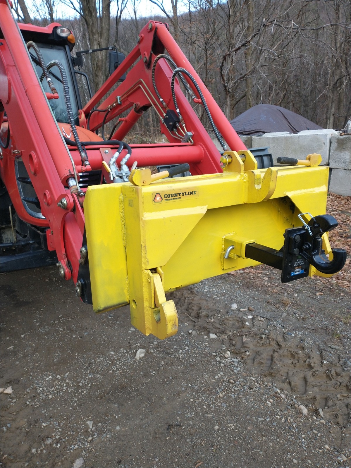

If you are wanting to use the FEL for trailer moving and bale spears there are several ways to go. Removing a set of forks from a carriage would not be my first choice by far, of course I do have this which could have a bale spear socket added to it quite easily.

I’m going to have to take a closer look. I was under the impression that mine aren’t removable, just adjustable on a sliding bar. This is the unit I have:
Apparently they are removable.
That's correct. They are. Slide the fork to the middle where that slot is in the lower rail and lift it off. I've never seen forks that weren't removable. That would be a major design flaw if such a thing existed. Simplest way to put a receiver tube on that would be to off set it to one side of the center support on the frame.

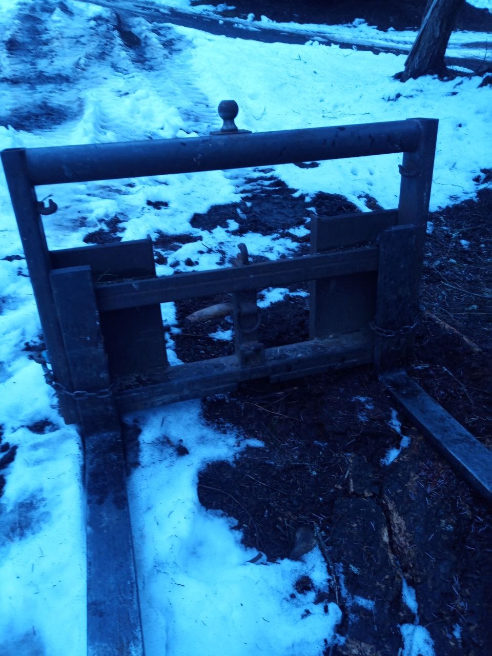

Here are my forks. Sorry for the poor picture quality. I just stepped outside to get the picture and it's getting dark but you'll get the idea. I built mine to be a lot more than just forks. As you can see there are variety of attachment points that can be used to push, pull and secure things in all manner of ways. The ball on top is for moving my gooseneck trailer.
Thanks. You’ve given me some great ideas. A receiver tube in the middle for moving a bumper pull trailer and one on top for my gooseneck. The receiver tube would also come in handy for attaching a bale spear.

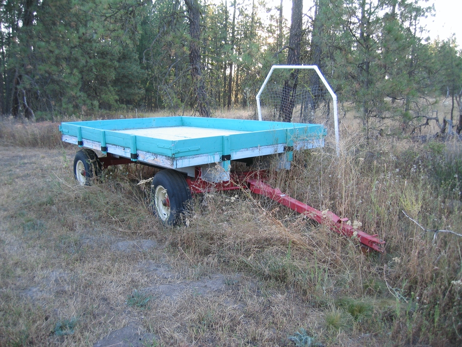

I pull with the standard draw bar that is attached to the rear axle. Why risk potential damage/accidents using a 3-point arm drawbar. And all the other paraphernalia that is needed to help make it safe.
On the other hand - the only thing I have to pull - a farm wagon. The tongue of my farm wagon - attached to a 3-point drawbar - could raise to any height and not be of any concern. My farm wagon tongue is jointed where it attaches to the wagon. Raising the tongue would have no impact on the farm wagon or the tractor.
BTW - after YEARS of practice - I'm finally getting better at backing this wagon.

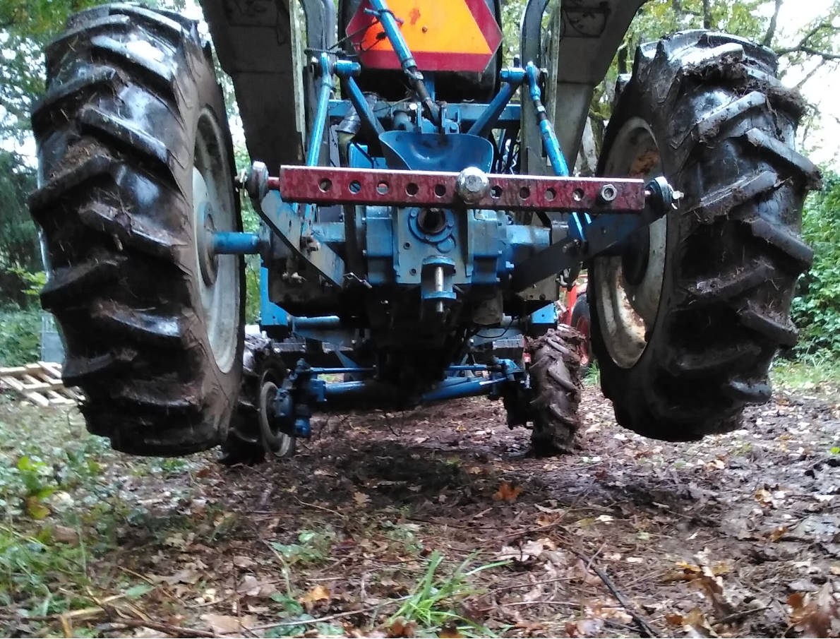

I see you are showing the tractor as your trailer load pulled up on the cross drawbar and then lifted your rears. I hope the landing wasn't too rough.

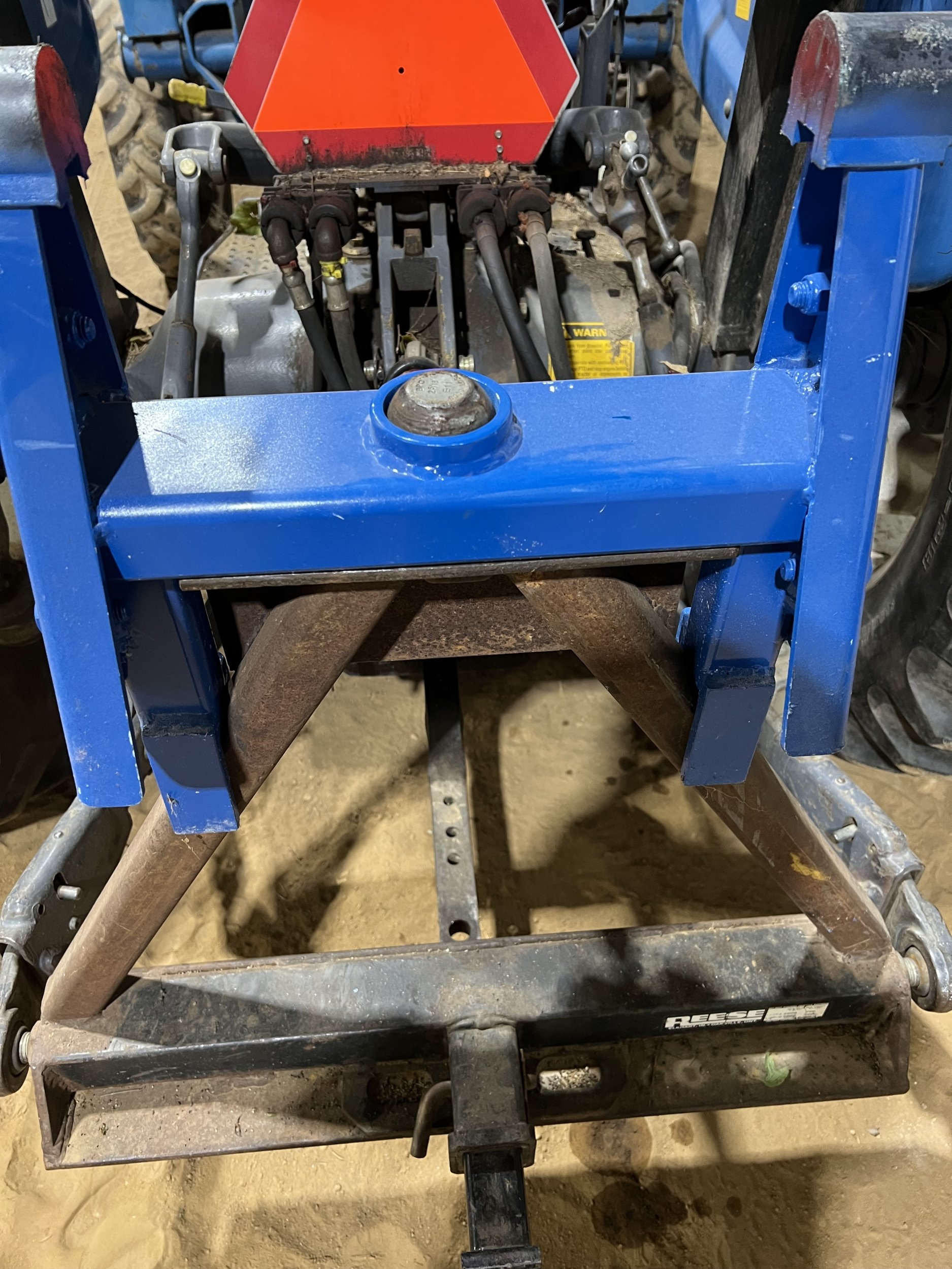

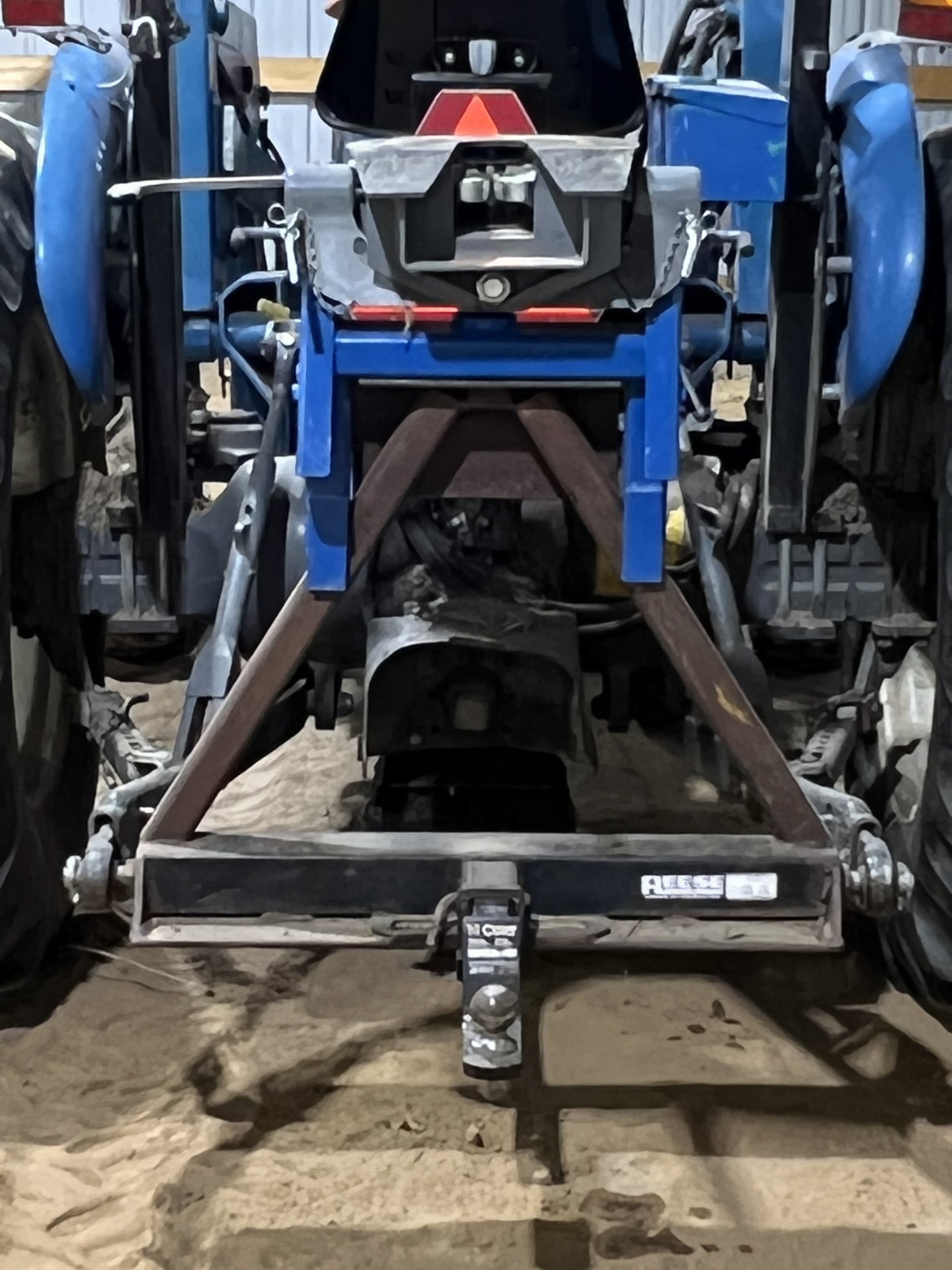

I have a homemade dedicated trailer mover for the 3 point. A 2" ball works quite well for moving both 2" and 2 5/16" trailers. As mentioned a 3 point has no hold down anyways.

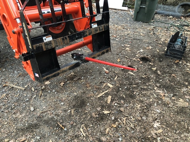

Nice. Can you buy a bale spear designed to fit in a receiver hitch or did you fabricate that?
Fabricated it. Figured out a 2” adapter’s ID matched the OD of the bale spear sleeve so basically it was meant to be :unsure:
I'd say more likely a heavy load on a front end loader picking the rears up.

I would not recommend drill the drawbar. As others have said you can get a trailer mover that has a 2” receiver built into it. I have seen, but not for a while (probably related to my looking or not looking) a bolt on receiver hitch that would mount to the drawbar as an option (poor option unless you have a drawbar lock due to spin effect).
A huge CAUTION on pulling a trailer on a 3PH is the only downforce on most 3PH is tongue weigh. Depending on the trailer design and trailer load this could make for a bit of a wild ride (Rear tires off the ground and thus brakes useless).
