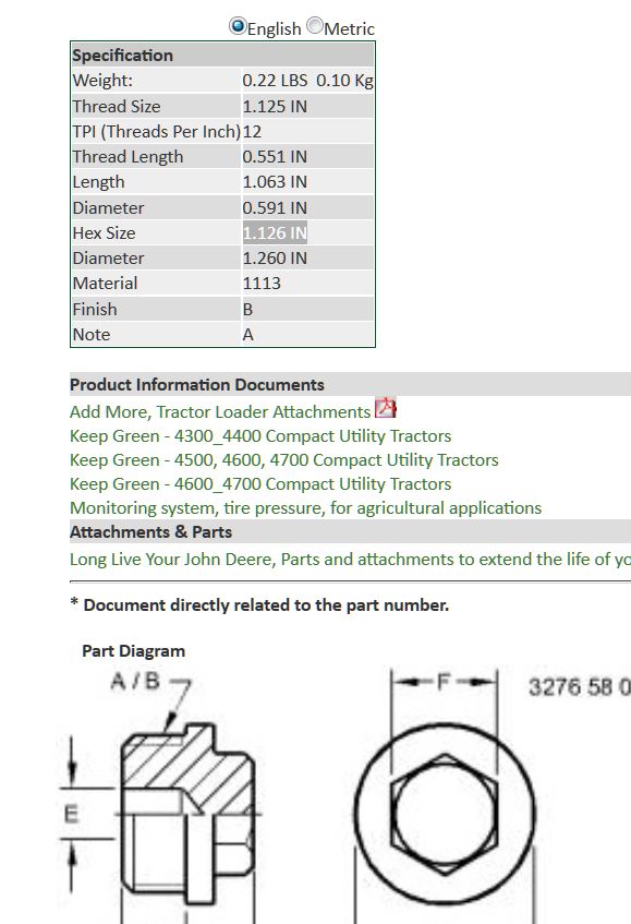

Simple question. To adjust position of drawbar, I can screw out what looks like a bolt through the drawbar (underneath tractor) but then there's another pin through the bar I can't figure out how to remove. This is on a 6210. Thanks.

It appears one needs to remove plug(parts key #16) that holds a pin(parts key #15) holding drawbar. Hex size of plug(parts key #16) is 1.126 IN according to JD spec's

After you remove The "bolt" JD calls it "plug" in the operators manual, the pin should pull out. Torque for the plug is 185lb-ft.
