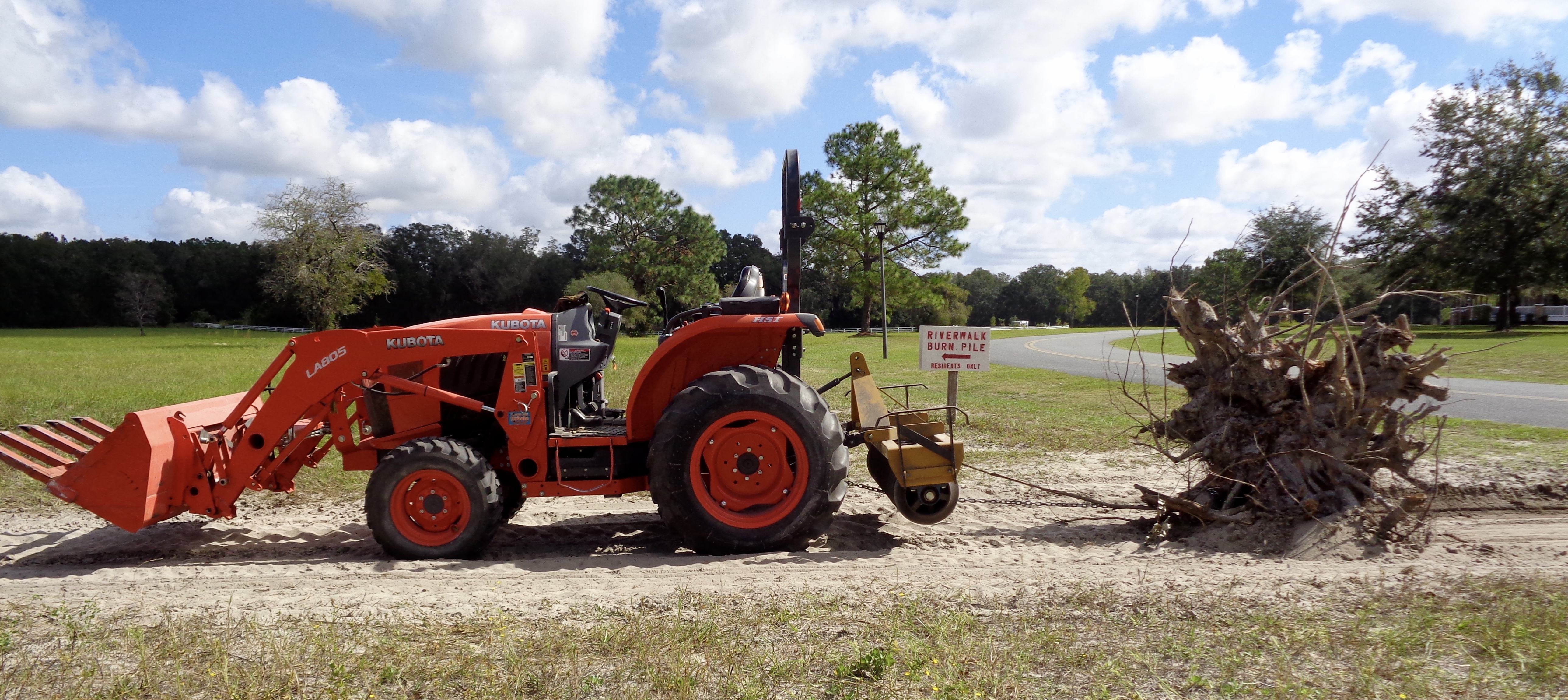

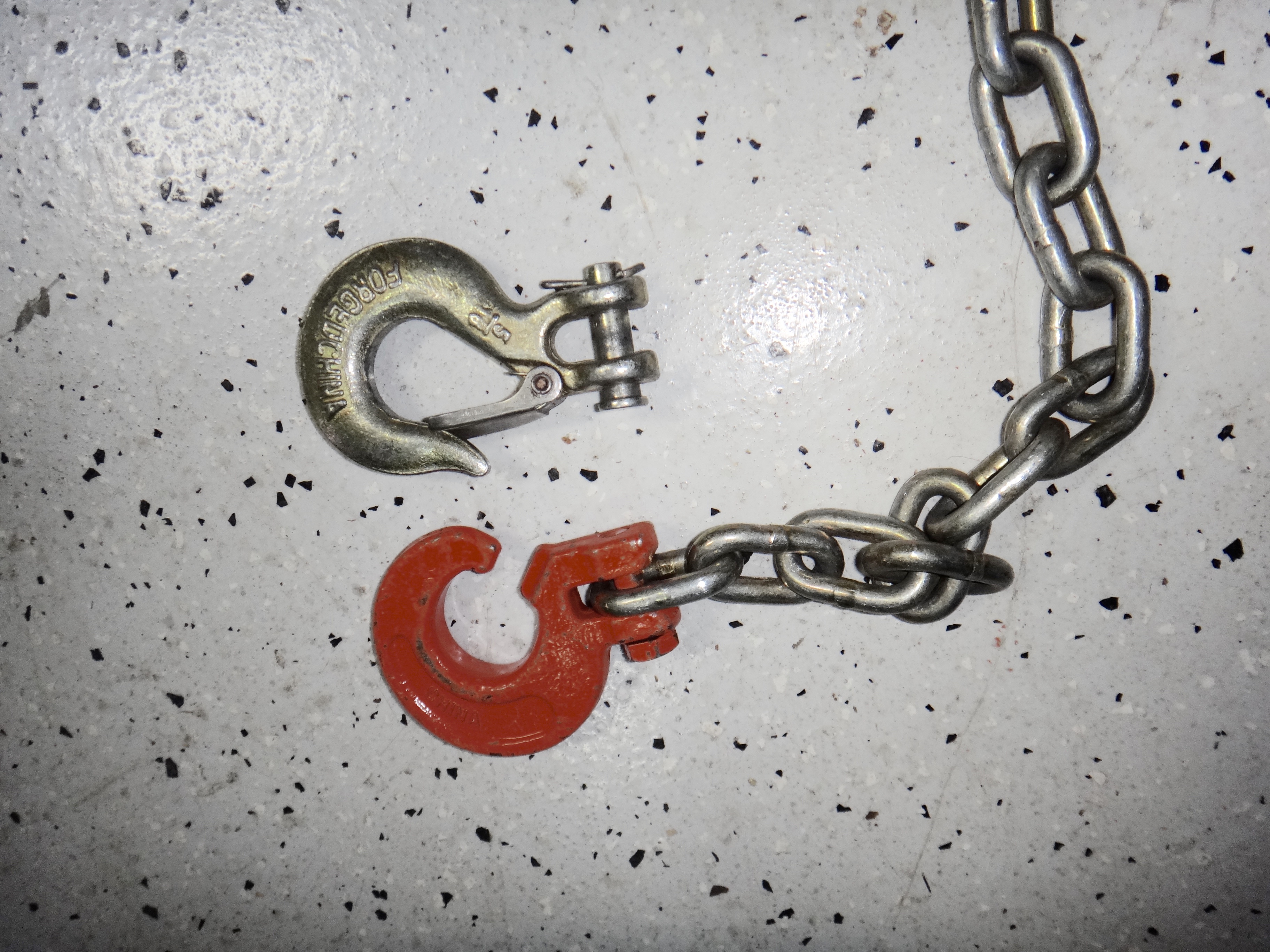

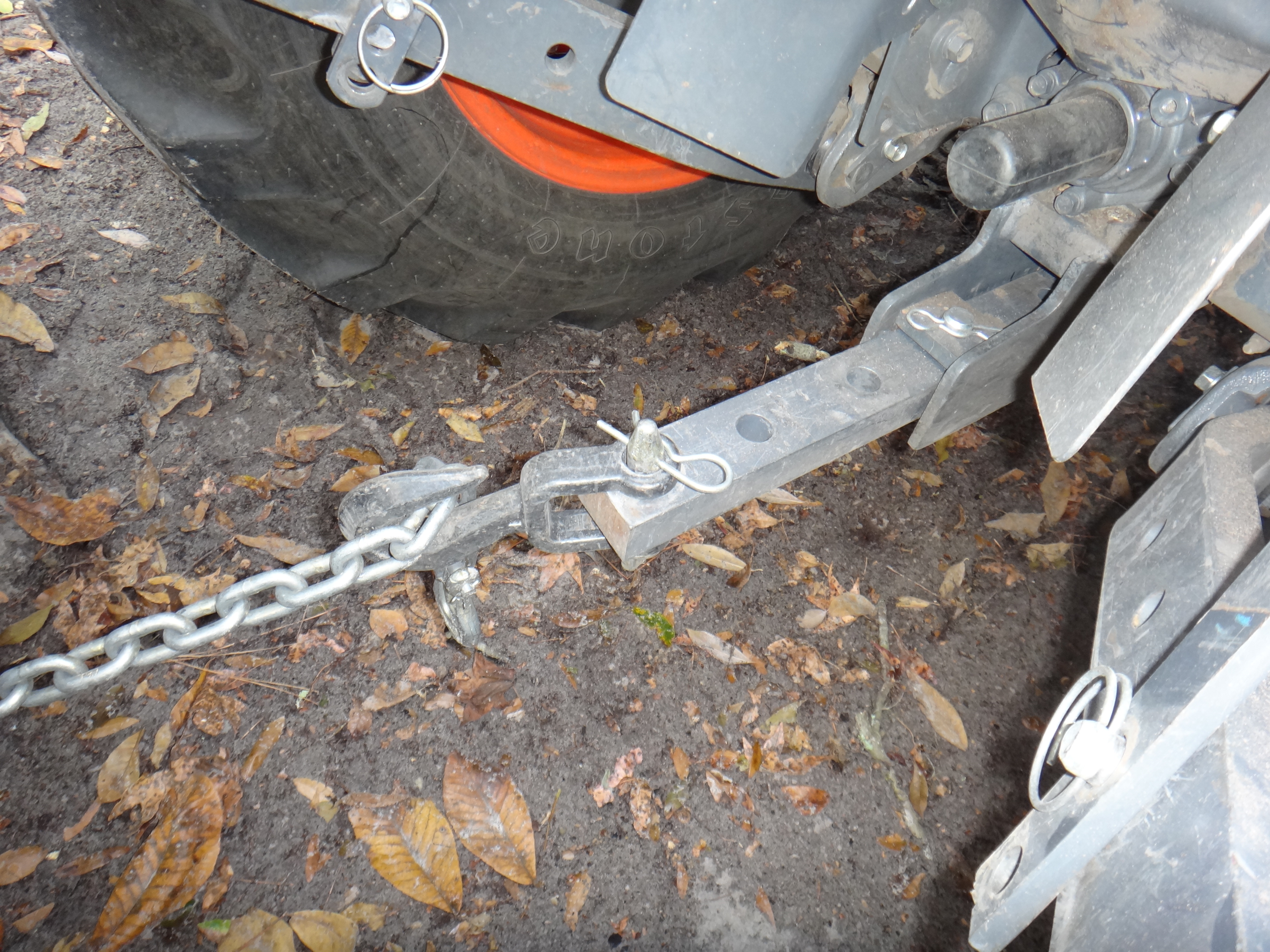

It is not very difficult to pretzel the FEL pulling a big ball of vine connected brush or tree trunks in reverse using loader mounted chain grab hooks. Loader chain grab hooks should be used for LIGHT/MEDIUM loads only.

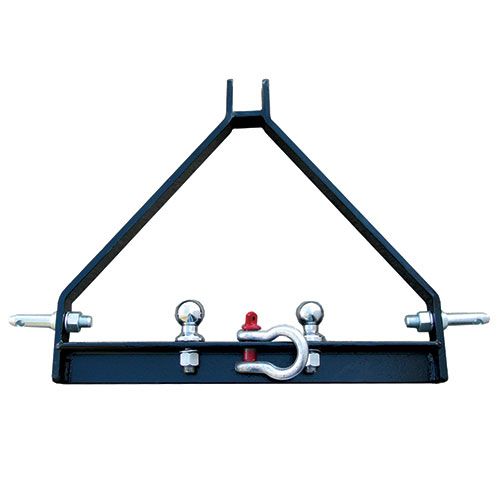

Though it may be take a few minutes longer to maneuver the rear/center drawbar to pull with a clevis chain grab hook, drawbar is the prudent procedure. Photo #1

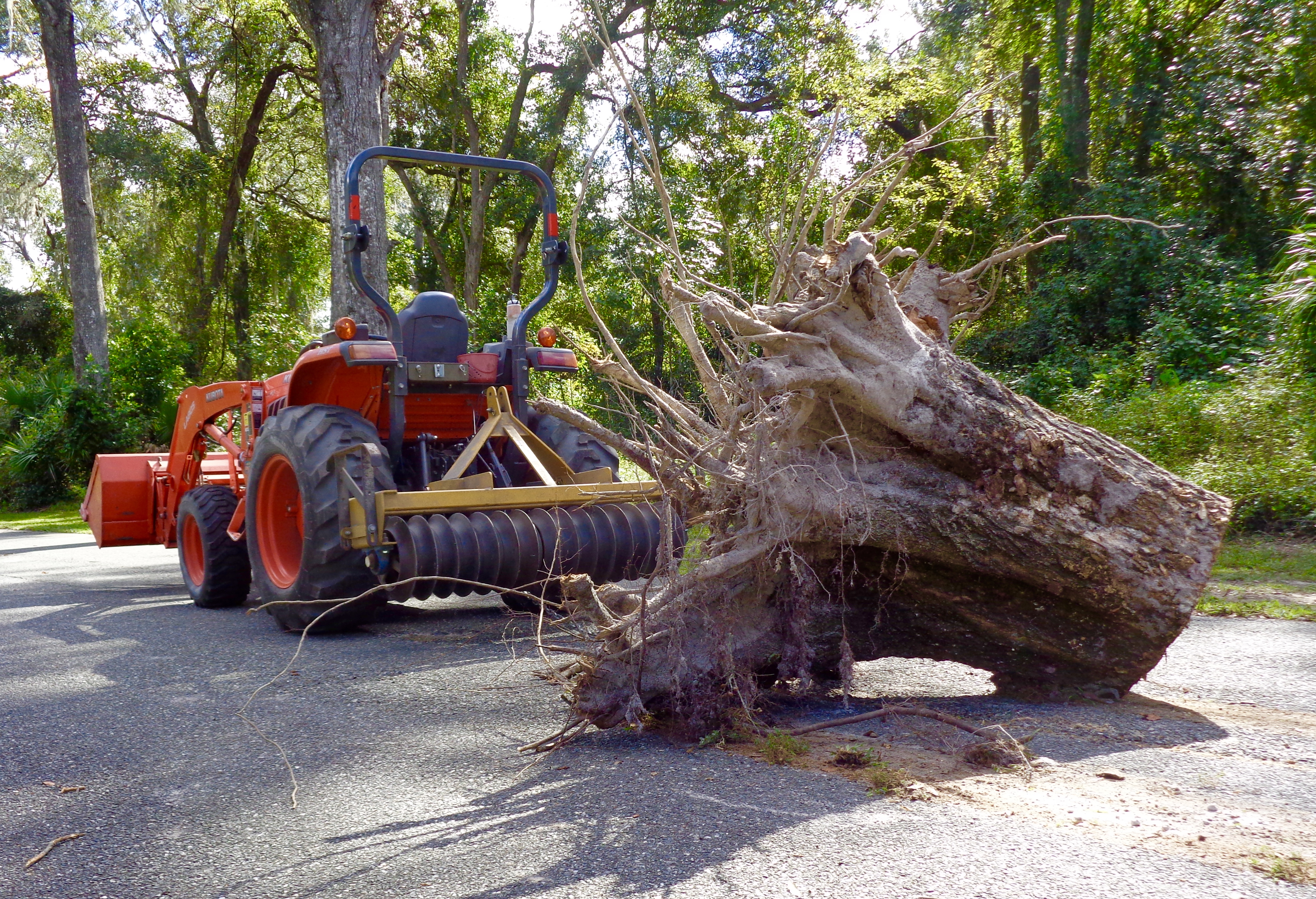

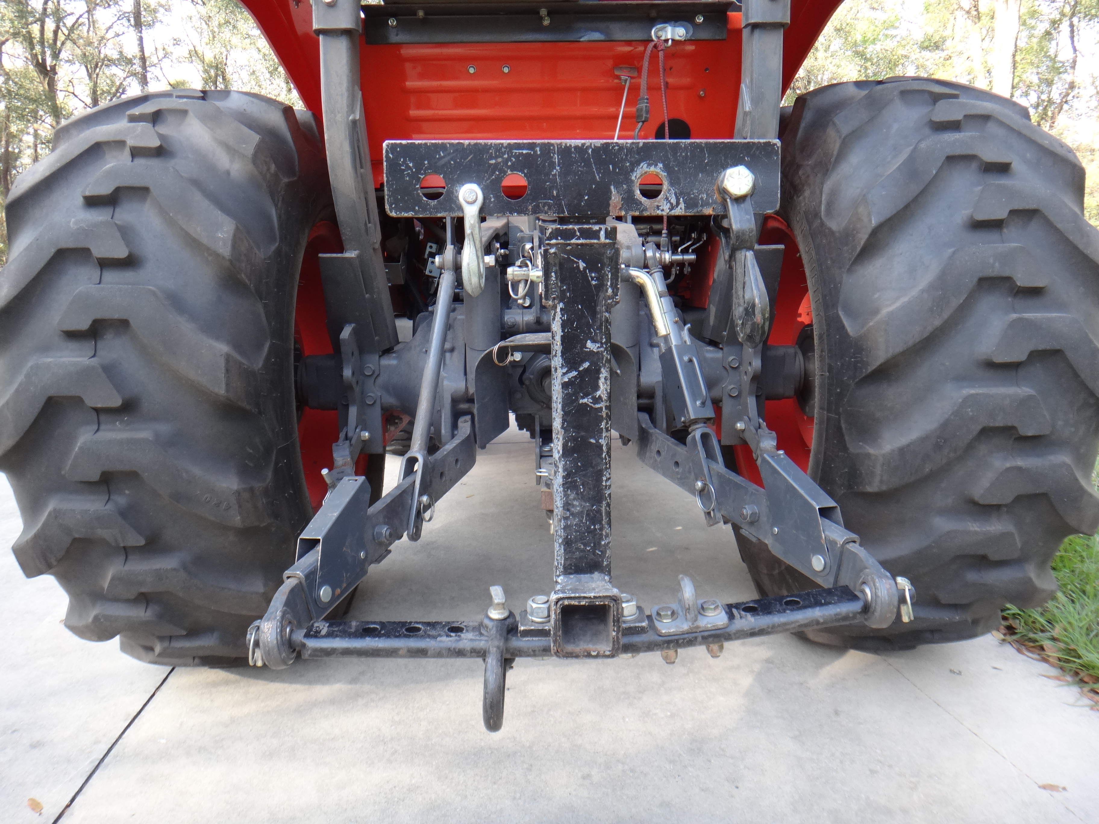

I also use a Three Point Hitch cross-drawbar for some pulling/towing tasks, particularly towing tree trunks slightly elevated to keep trees out of the dirt and relatively clean and prevent chain abrasion. Note three chain grab hooks. Photo #6
Handi-Hitch by Redlandhill. Quality fabrication; bulletproof. Photo #7
