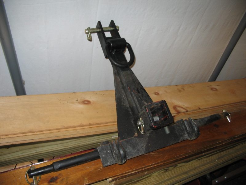

Trying to come up with a way to bolt on a female hitch receiver to my draw bar attachment. It would be nice to have the ability to drag trailers, etc. around the yard. If I could bolt the receiver to the draw bar, I could then use my standard Reece inserts with the different ball setups I already have for my truck.
Any thoughts?

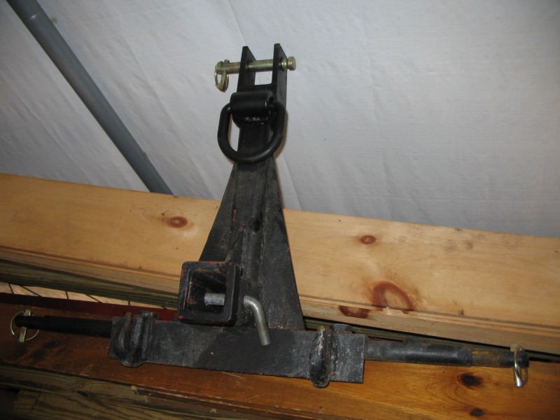

Go and buy a receiver, weld a bracket onto it and mount it to the drawbar. Or you can also make a 3pt hitch version of the same thing. The pictures are of my 3pt version with chain hooks and a D-ring.

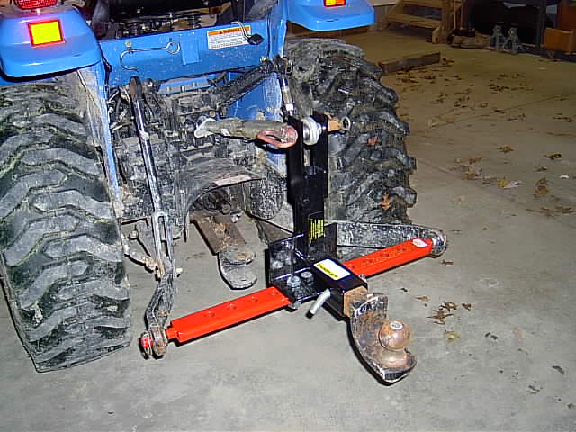

I bought the EZ Mover hitch, from one of the TBN advertisers here. I don't do any welding or fabricating, so this was the simplest, fastest way to put a hitch on the tractor. There's usually a banner ad to click on in the attachements and implements forum.
