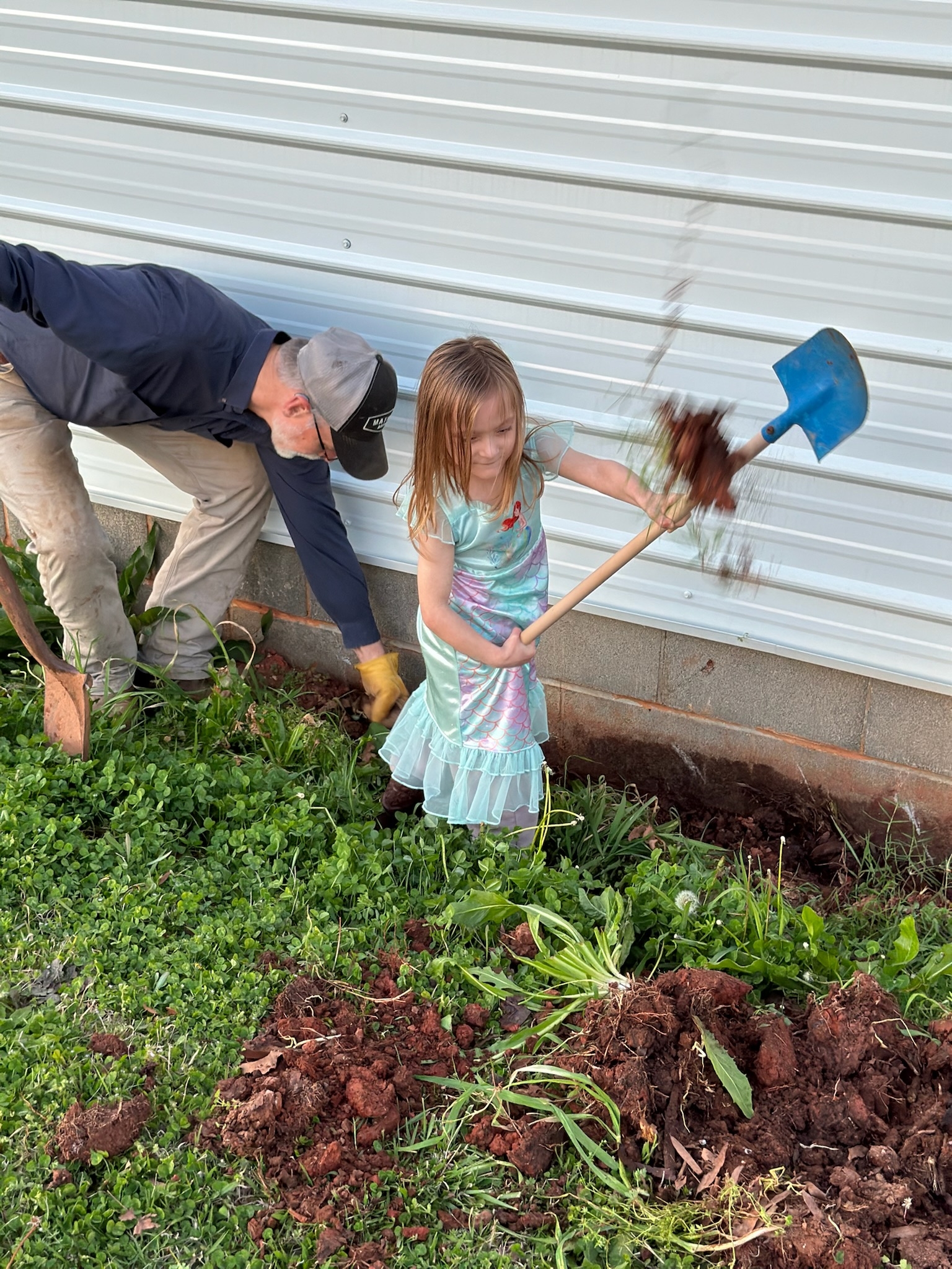

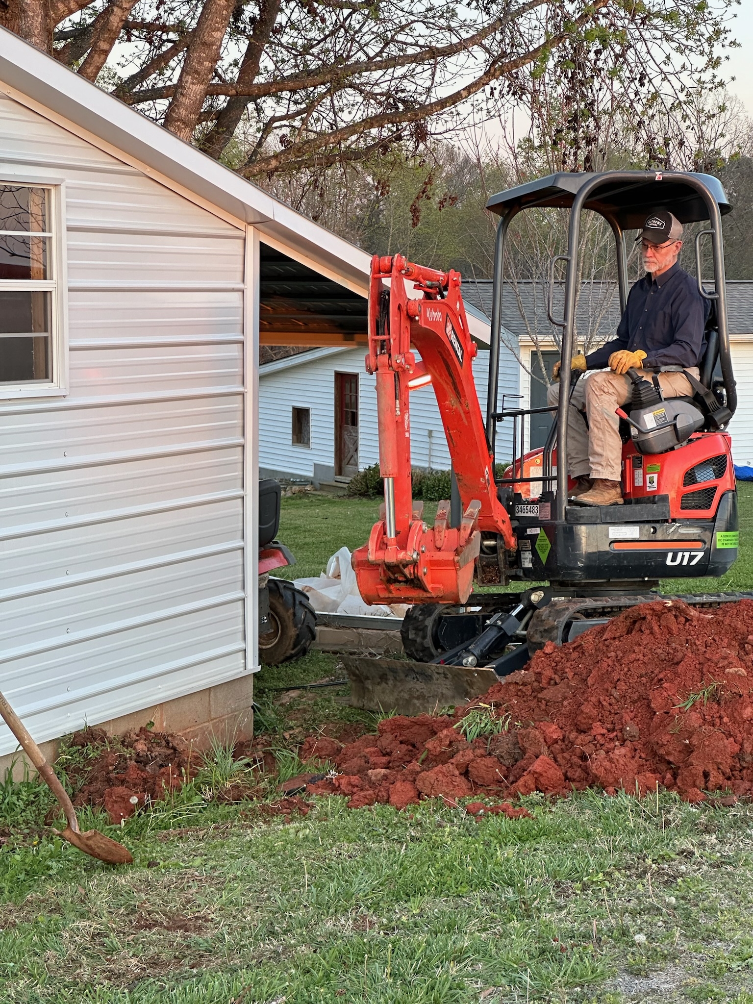

/ Drainage PVC (4") Under Driveway
Have you got pictures of the project? I don't use thin wall for anything sch 40 or better.
Not good pictures, but the drain will run under the four windows.
The last two pictures show the slope across the driveway.

/ Drainage PVC (4") Under Driveway #14
Looks great, and it is nice to see everyone involved in the project!
I think that if you back fill with sand and gravel, and leave the earth where it is, you will have a nice berm to direct surface water away from the building.
All the best,
Peter

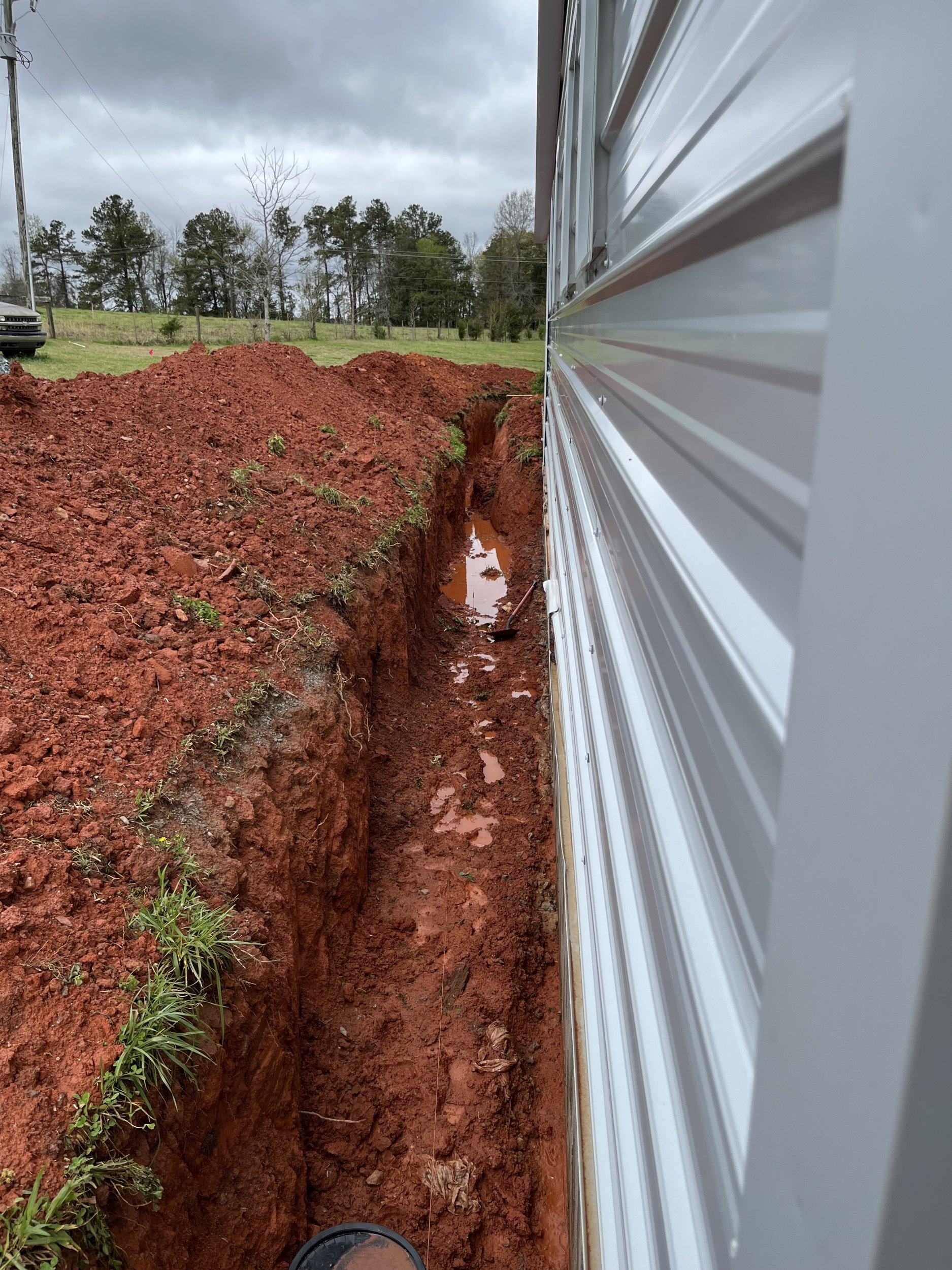

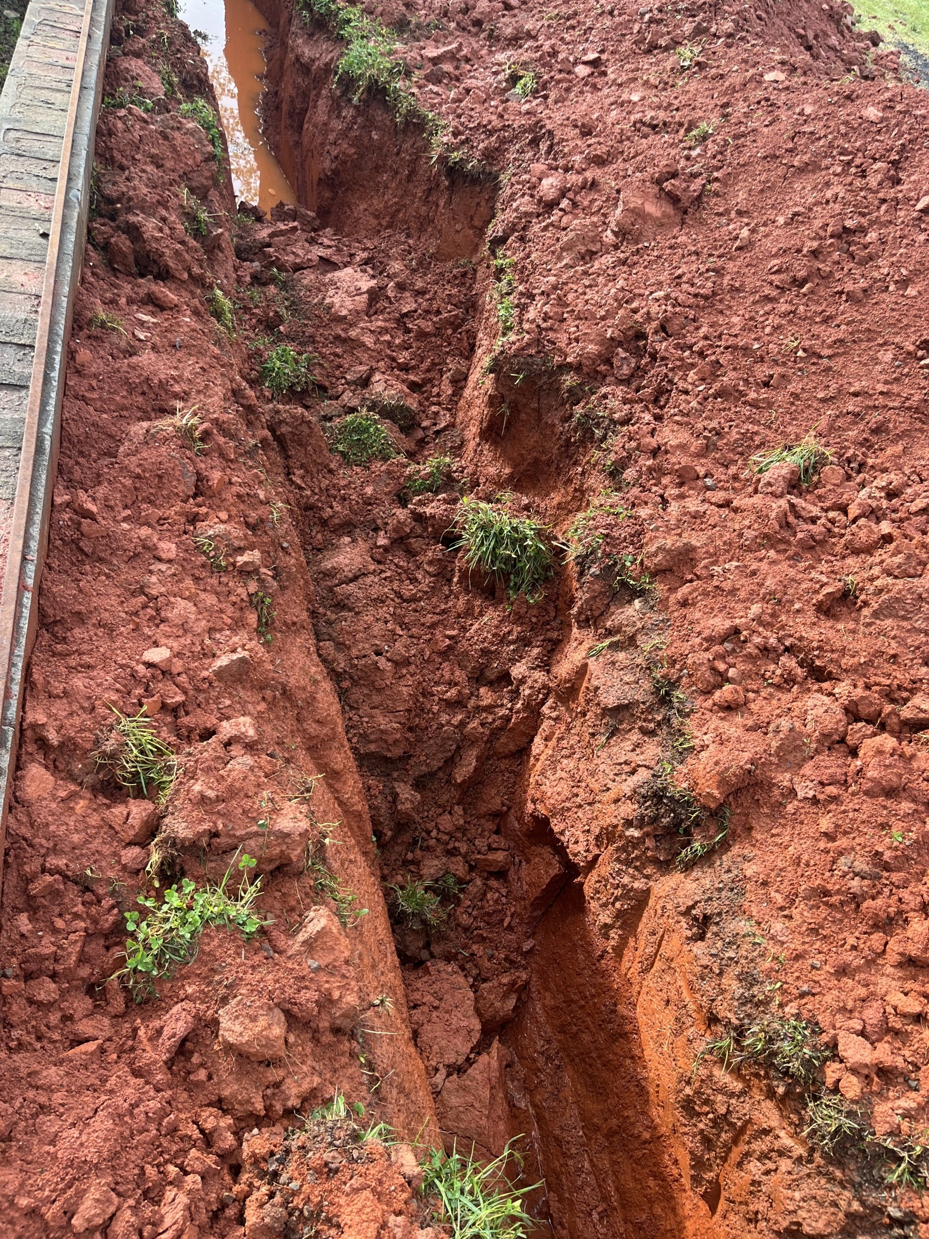

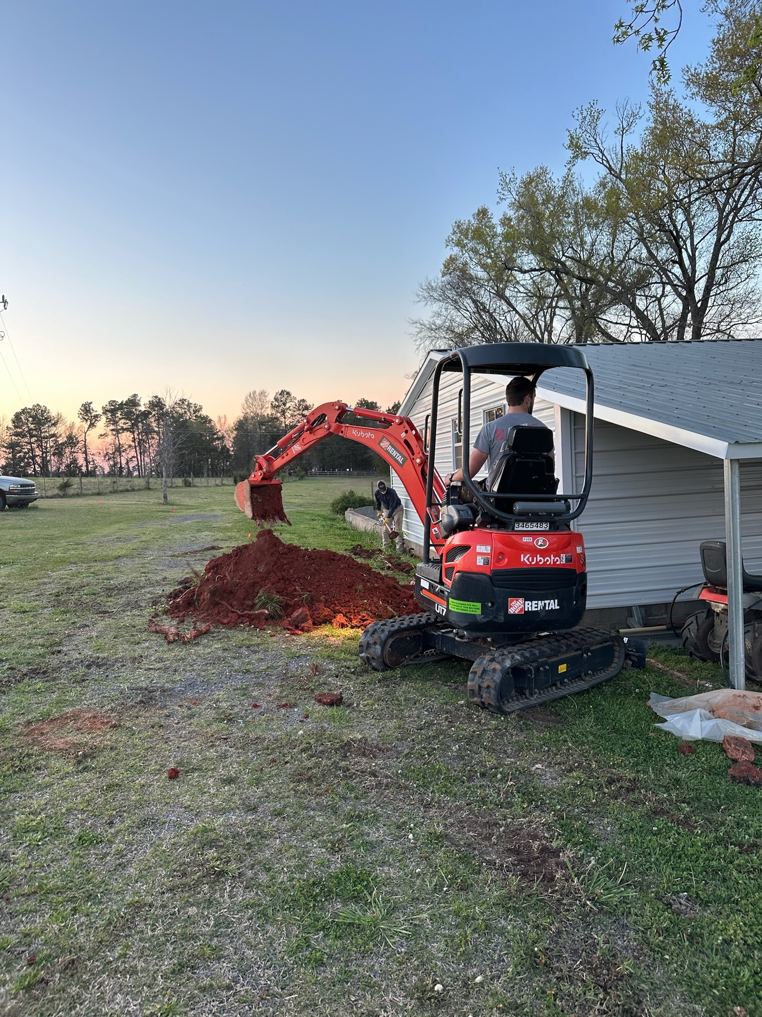

#17
Towed this to fill this because the shop is not done fixing my tractor radiator.
Got 15 tons of 57 stone to go in over the pipe.
However about 15’ of trench caved in the rain/ monsoon last night so lots of hand shoveling vs the excavator work.
