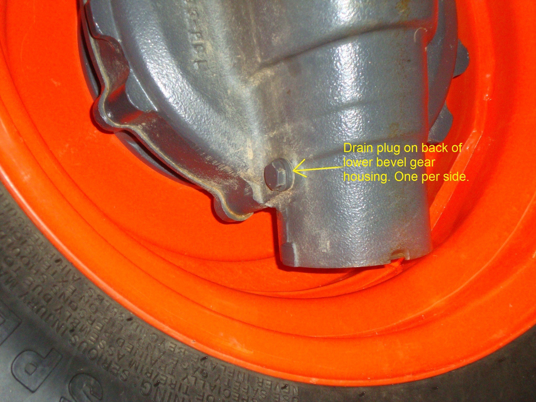

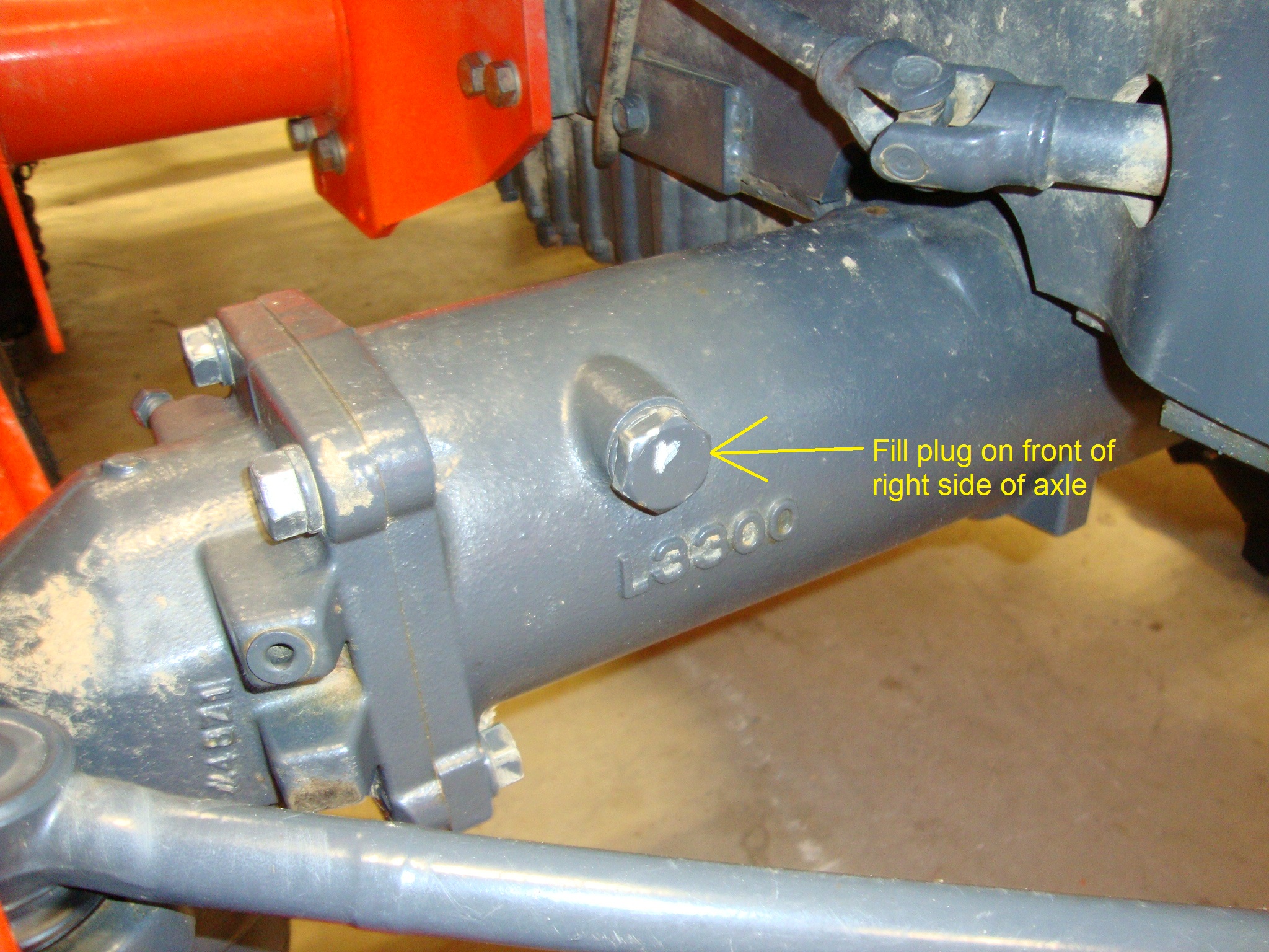

Would someone point me to where the drain plugs are for the gear box and the fill plug? The 50 hour service calls for replacing this gear oil,(80W 90) but I kind of can't locate them. ( don't have a service/repair manual)

I'm guessing you mean the front axle? There are two drains located on the back of the bevel gear housings near the hubs. There is a level plug on the front left of the axle, and a large fill plug in the front right side of the axle. You remove all the plugs and let the old oil drain out, then replace the drains and add to the fill until it comes out the level plug. After it seems full, run it for a few days then re-check the level. You'll probably have to add more oil, as much as a couple of quarts, since it takes a while to work down around the bevel gears and reach a final level. There's a few threads here about that.

Thank you so much for the reply, pictures and post. It is very much appreciated. Only in America do I find this kind of people, in my opinion.
