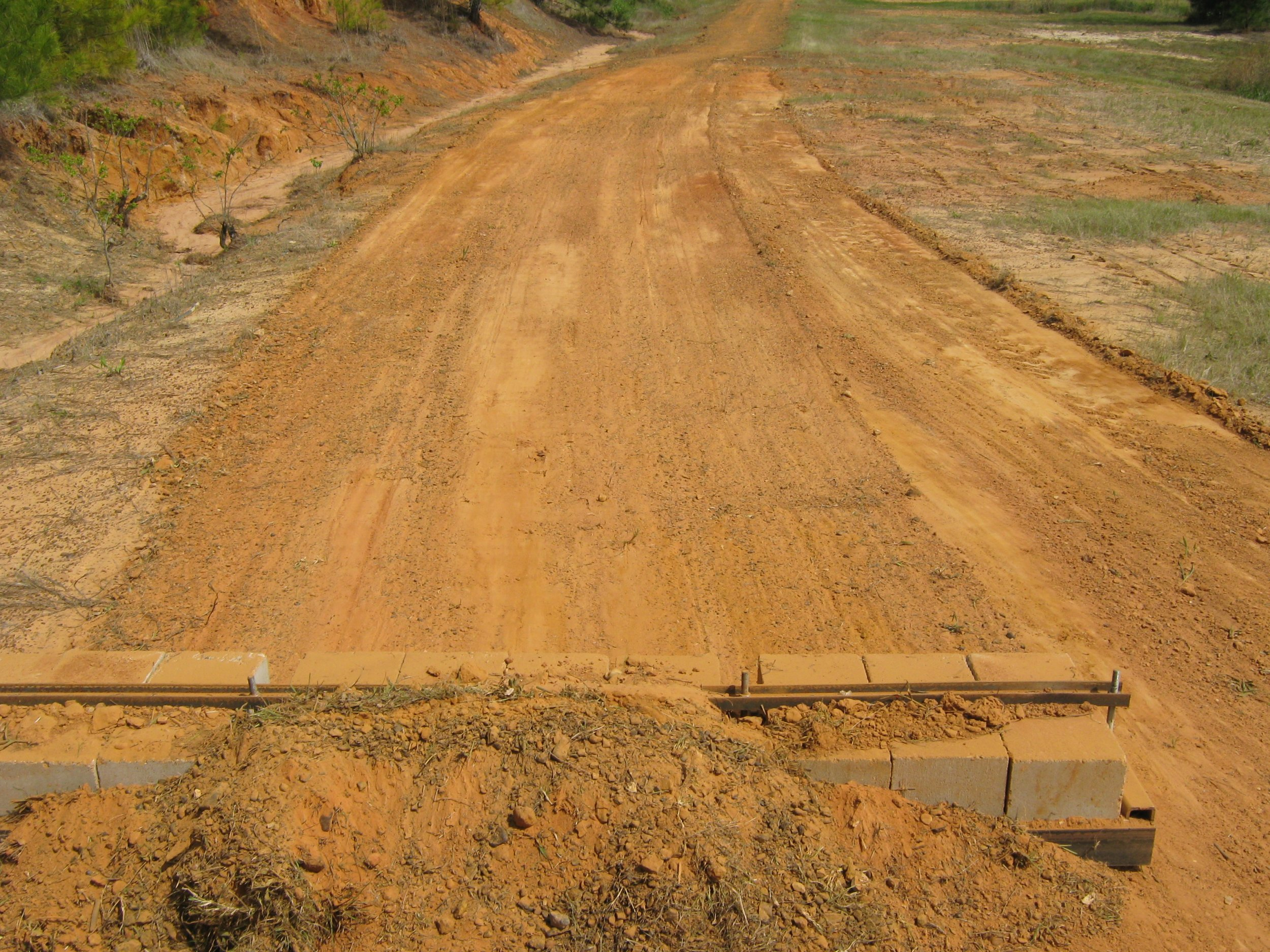

Just had some dozer work done at our little ranch in South Texas. The soil is very sandy and looking at options on making my own drag harrow to level it out as best as I can. Doesn't have to be perfect, just much better than it currently is. Any of you try dragging a weighted cattle panel or some wood pallets? Here is what I'll be working on.

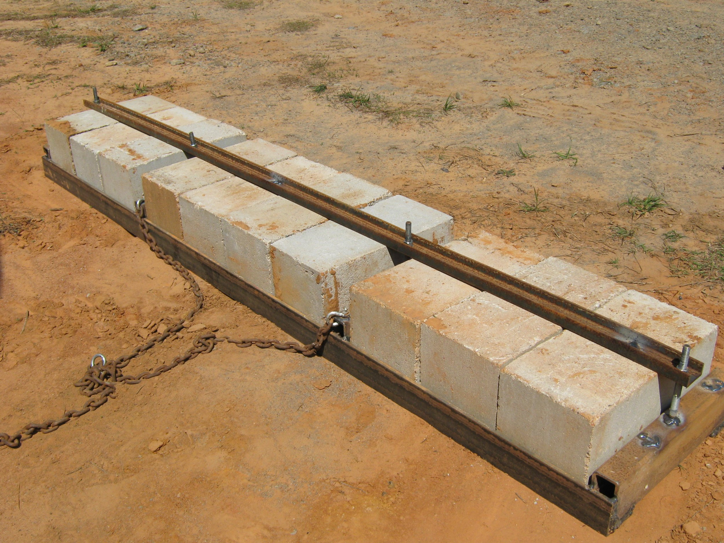

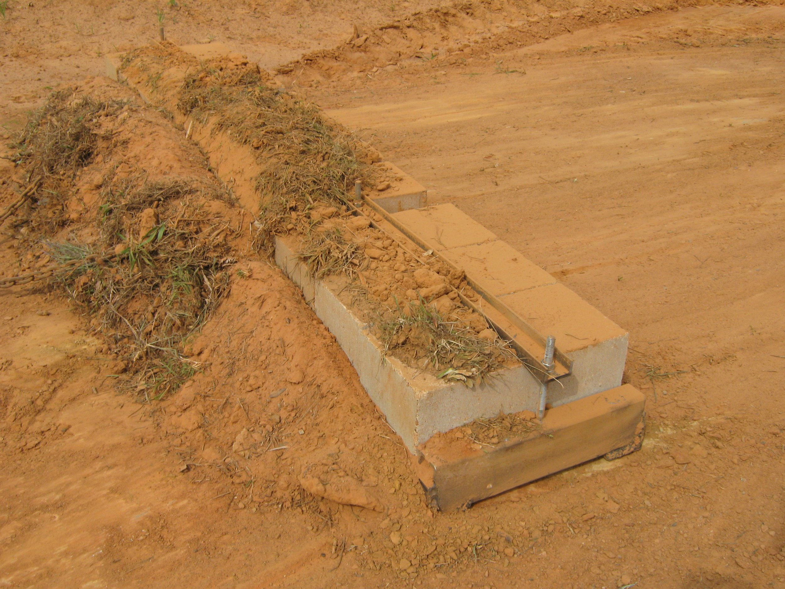

I used an oak log that was pretty straight that worked great. After a few years, it rotted out on me, so I built one out of angle iron and added some concrete blocks to it for weight. That works a lot better, but it takes a lot of HP and traction to keep it going. The blocks kind of act like a dozer blade, so when your pulling it, the blocks pick up the high ground, and then you lose that soil when you go over a low spot. Only thing that I hate about it is when I get a stick stuck under it, then it just drags the stick around under it and it leaves a line where the stick is digging into the ground. My small 37hp 4x4 tractor can barly pull it, and sometimes it gets to be too much. My bigger 70 and 80 hp tractors pull it fine. I wouldn't try to pull it with a truck.
