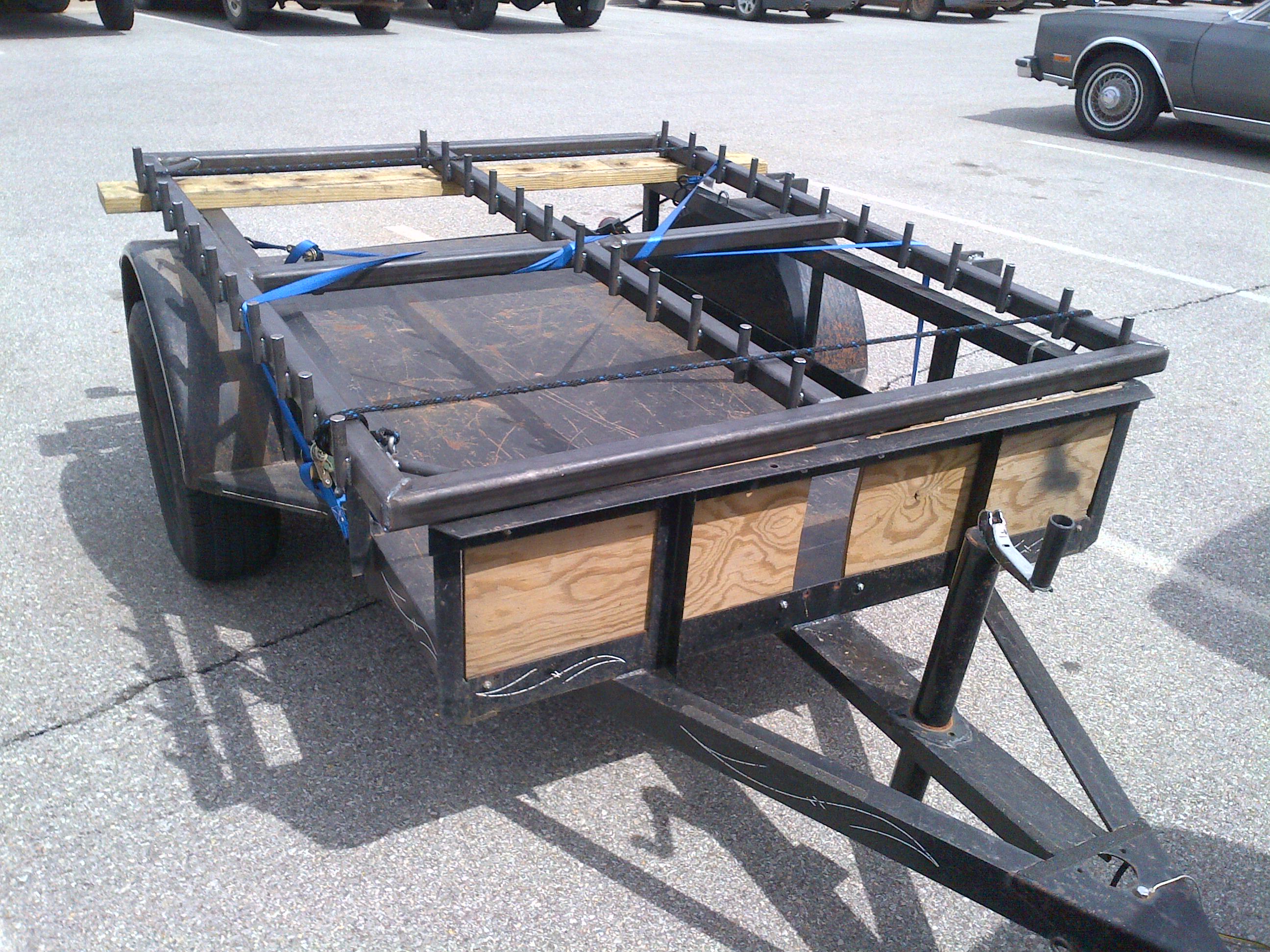

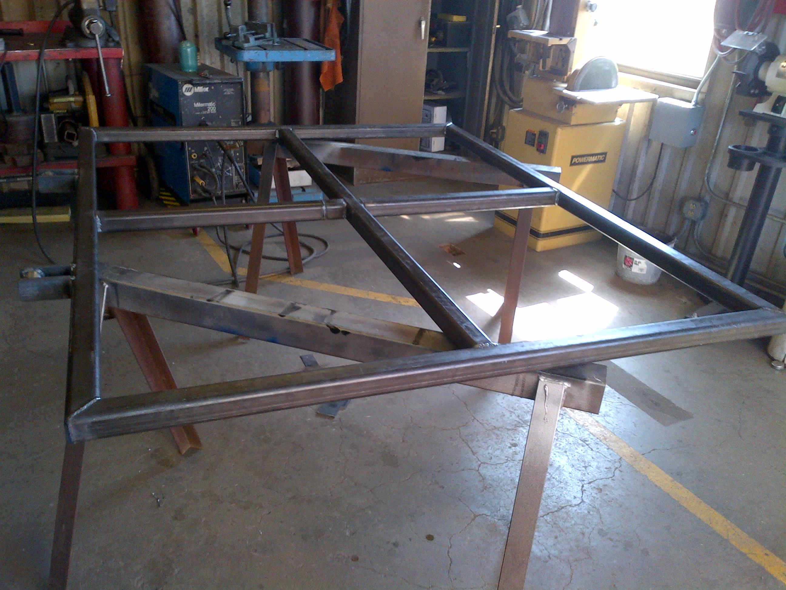

I really don't know anything about farming/ranching/whatever but I really enjoy making things.
I have a drag harrow just about complete. It's constructed from 2"X2"X.25" steel tubing for the frame and 3/4" cold rolled steel rod for the tines. It is 6' wide and 4.5' long with three rakes with tines 6" apart staggered 2". I struggled with tine length but settled at 2.5". It should be sufficient for flip/flopping on the food plots and may even help on leveling the driving trails. It'll also have center line connections to add strength and weight. I built a jig from a 2"X6" to locate the tines. Photos to follow.
Since I'll attach it to the drawbar that has a clevis hook on it, I assembled a chain with bits to attach everything. It's the first thing I've ever built that won't be painted/powdercoated as I'll just abrade the finish off.

I have some cat 1-2 bushings that I welded to tabs on the back side so I can hang it off the iMatch and then use drag chain to hang it for transport from the top hook. Tines go on tomorrow.
   / Drag Harrow
Completed.
