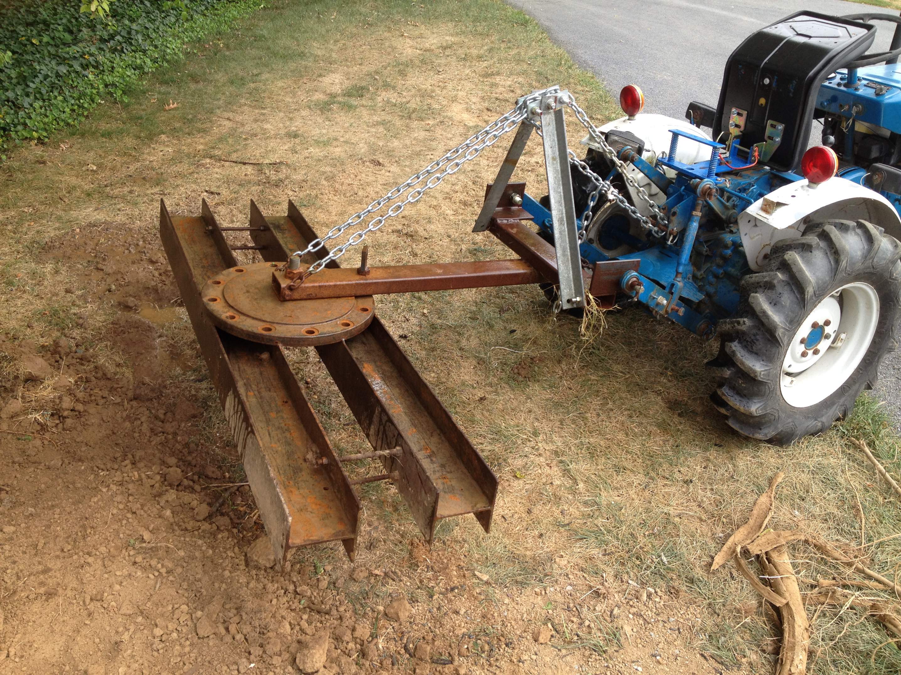

   / Drag Harrow (homemade) #15
Here's a homebrew one I made. At first I used it with my lift boom. It was a little cumbersome, but by changing the chain lengths on the sides it could rotate enough to cast the scrapings right or left. A couple years ago I found an unused blank flange at work and modded it to make it more user friendly.
#16
Now that's what I'm talking about Chim... and it looks like very little welding involved. 👍

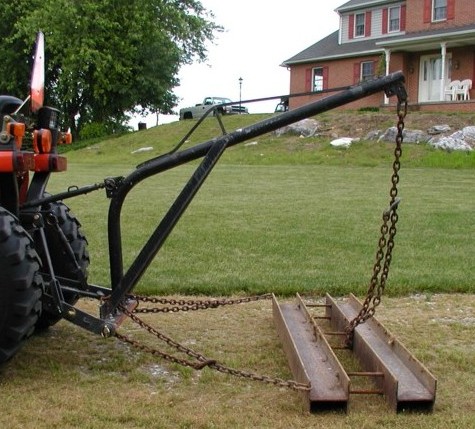

   / Drag Harrow (homemade) #18
That attachment is for smoothing stuff out. Teeth are sometimes used, but on the other end of the Kubota.

   / Drag Harrow (homemade) #19
So retractable teeth would be a bad idea?
   / Drag Harrow (homemade) #20
Nope, it would be a great idea if I needed them.

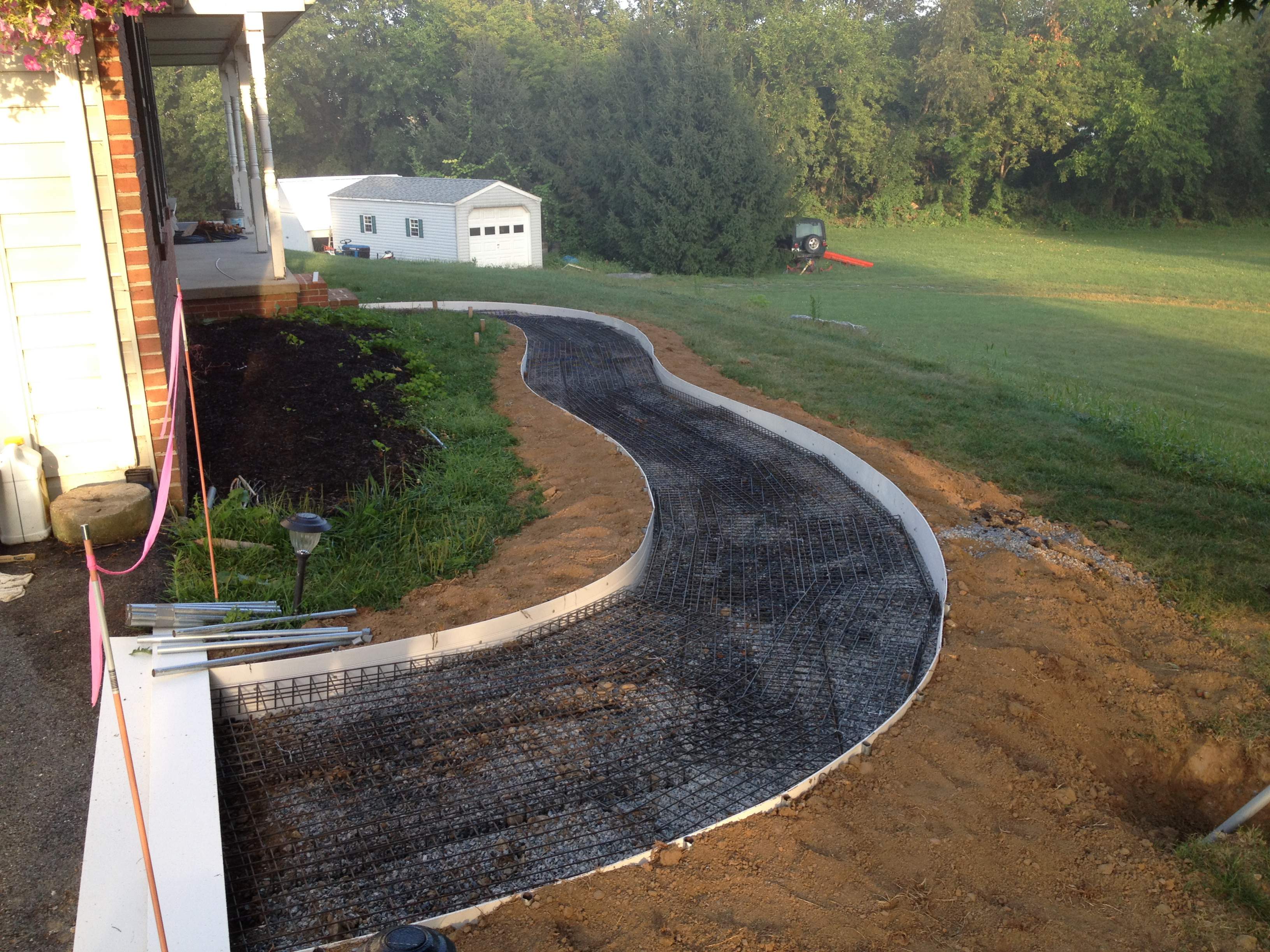

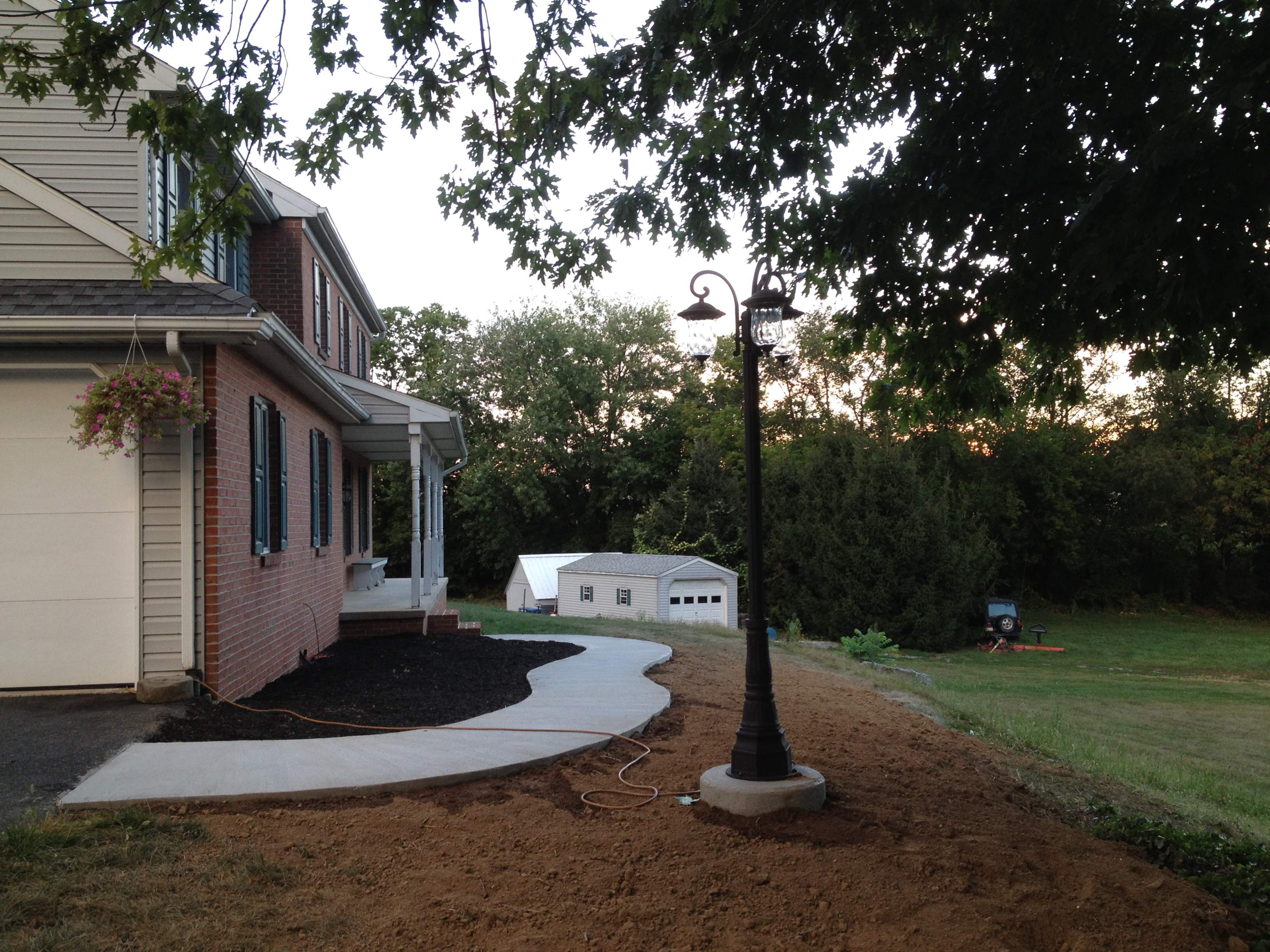

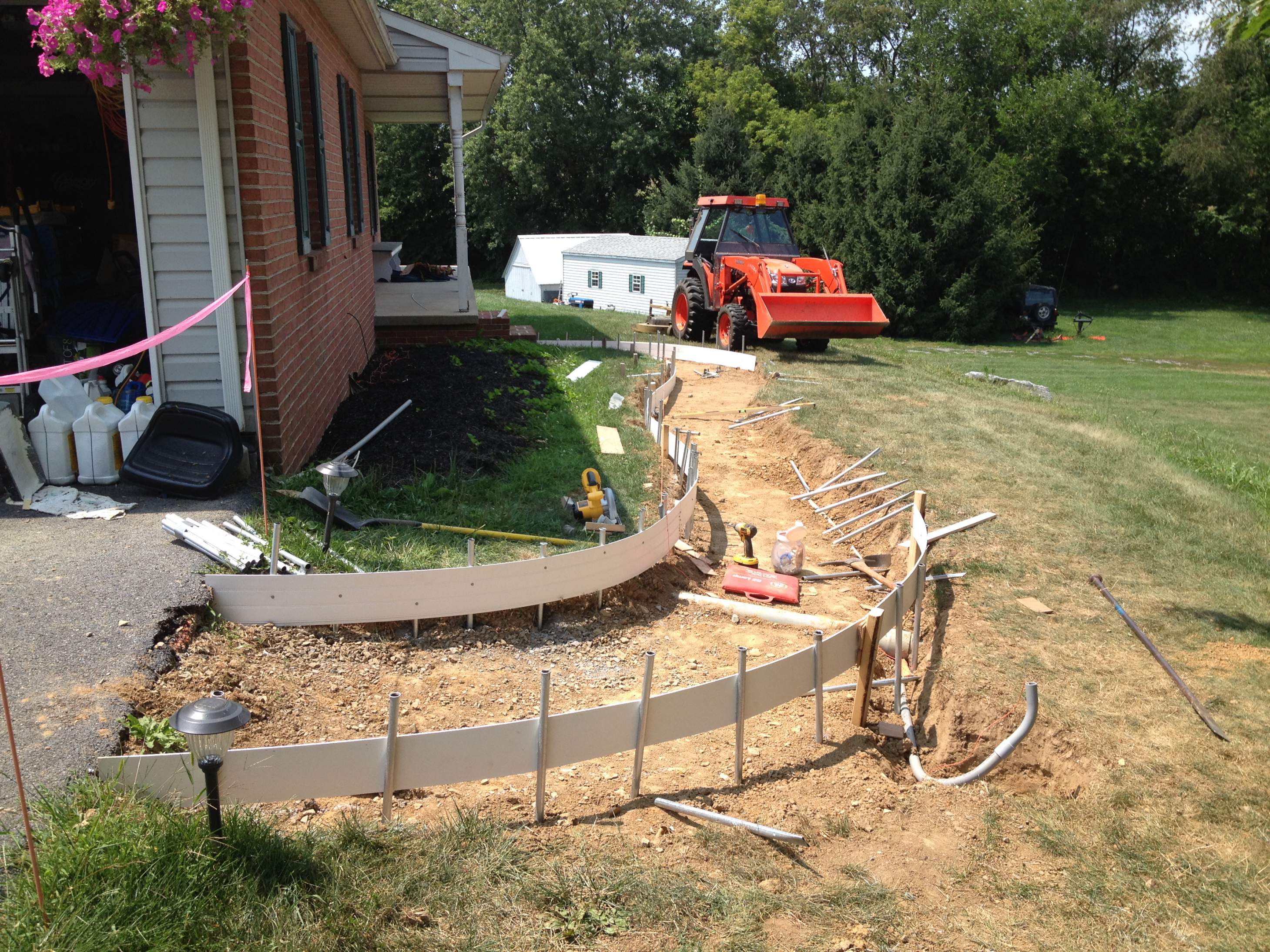

The main purpose of the rear attachment is for leveling and smoothing a gravel driveway. Our main driveway has been paved for many years, and the remaining gravel driveway to the shed and propane tank doesn't require any maintenance. We can have any size truck use it regardless of the weather. Our excavating sub used about a foot of gravel (a mix composed of 3" down to dust size) and I topped it once with some 2A modified maybe 15 years ago. When we annexed the 1-1/2 acres on one side of our property about 5 years ago I bought, used and sold a box blade with scarifiers to tame it.
The picture of the rear attachment in my earlier post is from the last time I recall using it. It's from when we put the front sidewalk in a few years back. Even though we never used the front door since we built back in '89, Wifey said we need a front sidewalk with some curves (something about us dying and the kids ending up with a house they couldn't sell because it lacked a sidewalk).
Rather than remove the RFM from the Kubota, I hooked it to the Ford. Some of the area needed a fair amount of fill. The Kubota hauled and roughly graded the fill and then the Ford took over. Following that,, there was very little hand work.

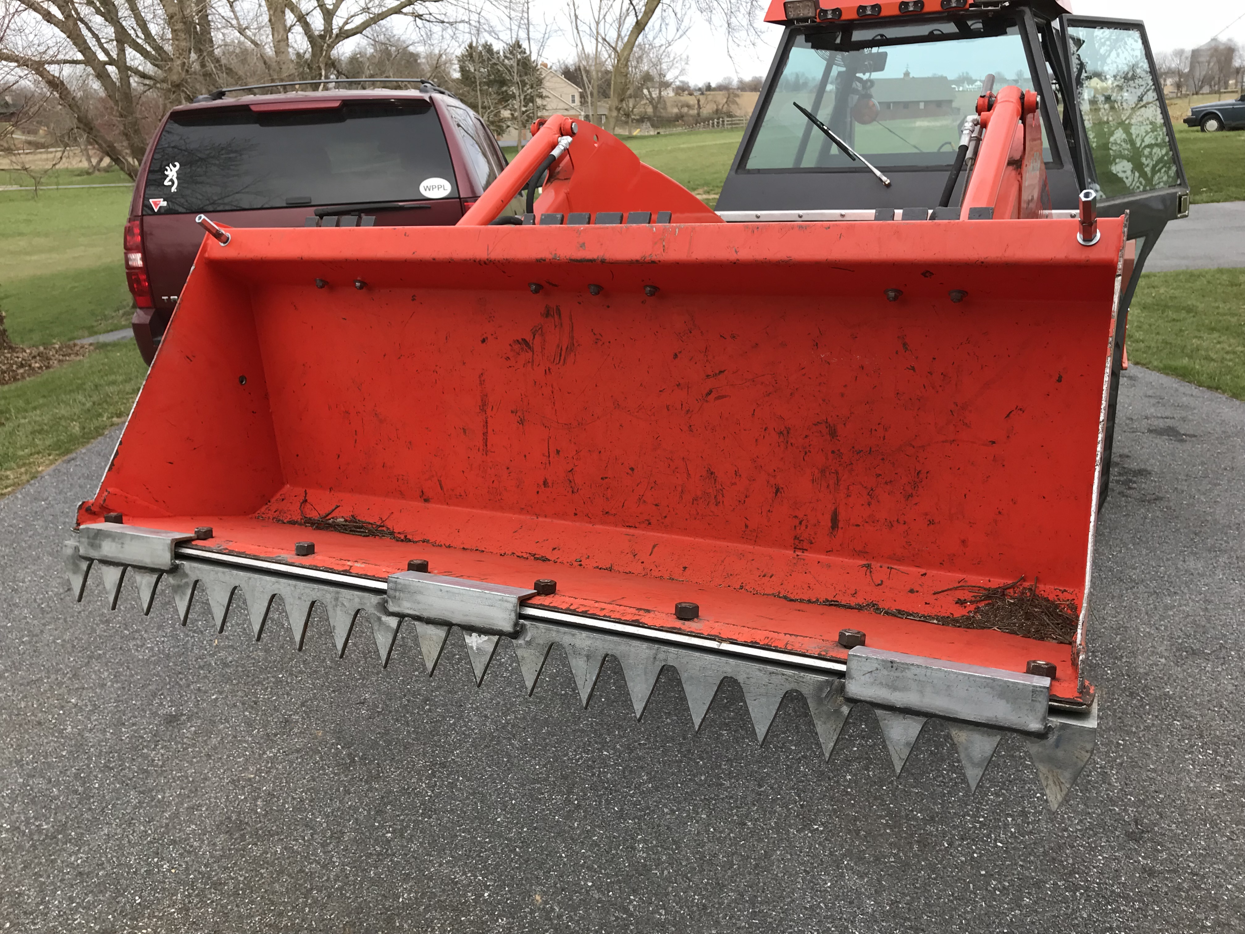

The toothy front attachment was a fun project to come up with something to allow me to reach into the fencerow to clean up brush. It has been pressed into service a couple times to loosen up small patches for re-seeding.
