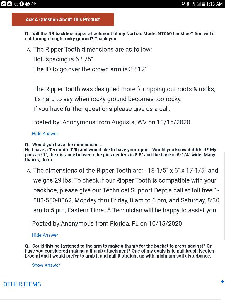

I am looking for a ripper tooth for my MF CB65 backhoe. Does anyone have any experience with a DR Power ripper tooth on the CB65?
Or an alternate.
The DR ripper is currently selling for $139.99 with free shipping, but I would like to know if it fits well, works well with the CB65.
Thanks.
   / DR Power Ripper tooth for MG CB65 Backhoe
Here is some info I found on their site.View attachment 683248
Thanks for the follow-up. I had called DR Tech Support, and the representative told me he did not even have the dimensions/specs for the ripper tooth! Finally I received an email from DR with the attached drawing and measurements for the ripper.
Guess I will have to do some measurements on my own.
Unfortunately also Agco and my local MF dealer has been totally unresponsive to my calls and emails about a ripper for their CB65 backhoe.
View attachment DR Ripper drawing.pdf
Anyone have any thoughts based on this drawing?
Thanks.
I finally had a chance to follow-up on the DR Ripper drawing. The holes for mounting the ripper tooth are 25.65mm. The CB65 backhoe uses 30mm pins to mount a bucket, so the DR Ripper tooth does not work.
Thanks for the replies.
FYI, my MF dealer finally got back to me today to say he found a $400 ripper tooth. Too much for me.
