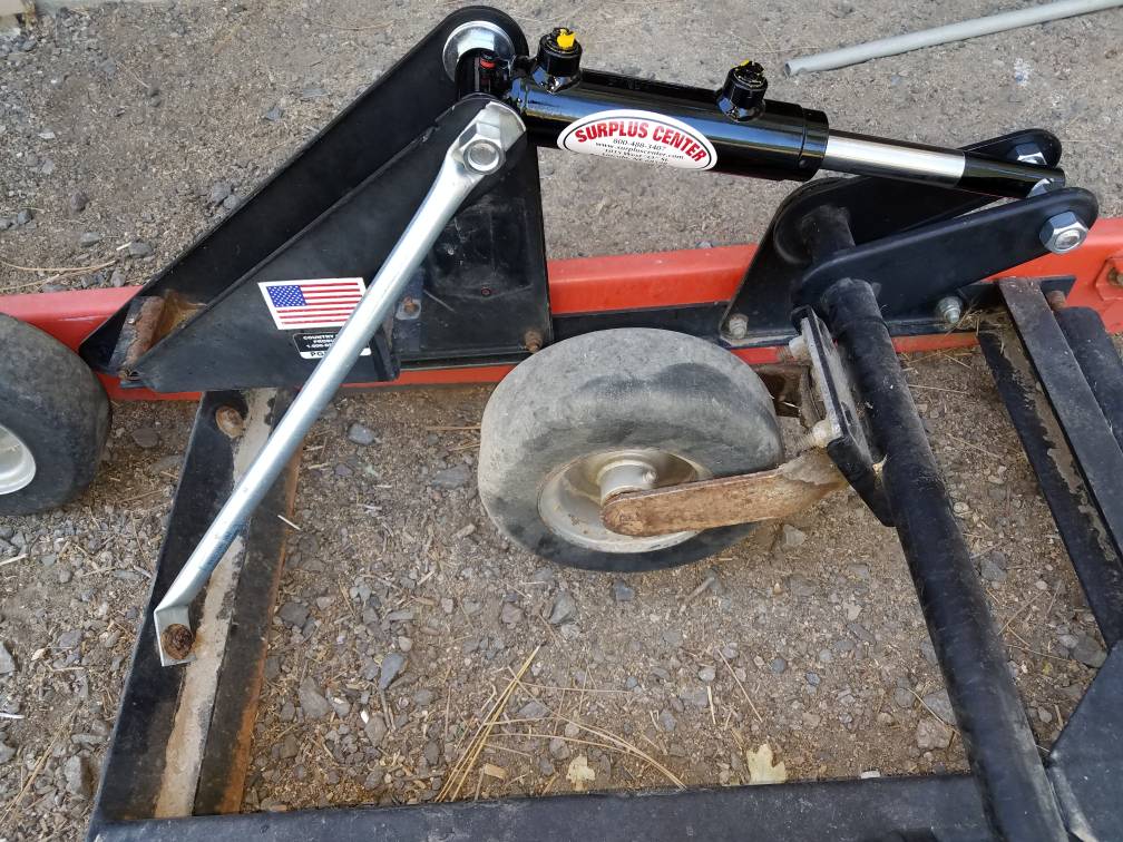

I have the older style DR Power Grade - 60" model. The actuator and remote system quit so I ordered the corded retrofit. That didn't work very well - it couldn't lift the grader back up with the concrete block in it. So I'm thinking of replacing the actuator with a small hydraulic cylinder. I've measured it all out and found a cylinder which will fit. Its rated for 1500 lbs max working pressure. My only question now deals with hydraulic psi coming out of the tractor. Will the pressure be too high and damage the cylinder? I have not found specs on the tractor yet (2015 Branson 3520h) - only that it runs 9 gal/min.
Open to your ideas. Thanks.

Don't know specs on your tractor but every discussion I remember on here talked about 2-3000 psi on tractors.

The hydraulic cylinder arrived on Monday. Today I drilled out the holes in the actuator bracket and control arm to accommodate the 5/8 in bolts that will be needed for the new cylinder. I picked up a short section of threaded rod and a handful of nuts and washers. Seemed like the cheapest way to mount the cylinder.
The DR Grader is pretty lightweight and I noticed the actuator mount was starting to sag toward the inside. So I took it off to make sure it was clean between the side rail and the actuator mount. I bolted that back on and then added a brace from the inside of the actuator pin hole down to the rear spreading blade. That stiffened the actuator mount considerably. I used a piece of half inch metal electrical conduit for the brace. It matched the lightweight construction of the greater and I was able to easily crimp the ends flat. They do require an odd angle.
I will see if I can add some pictures.

That's pretty slick. Let us know how it worked out.
