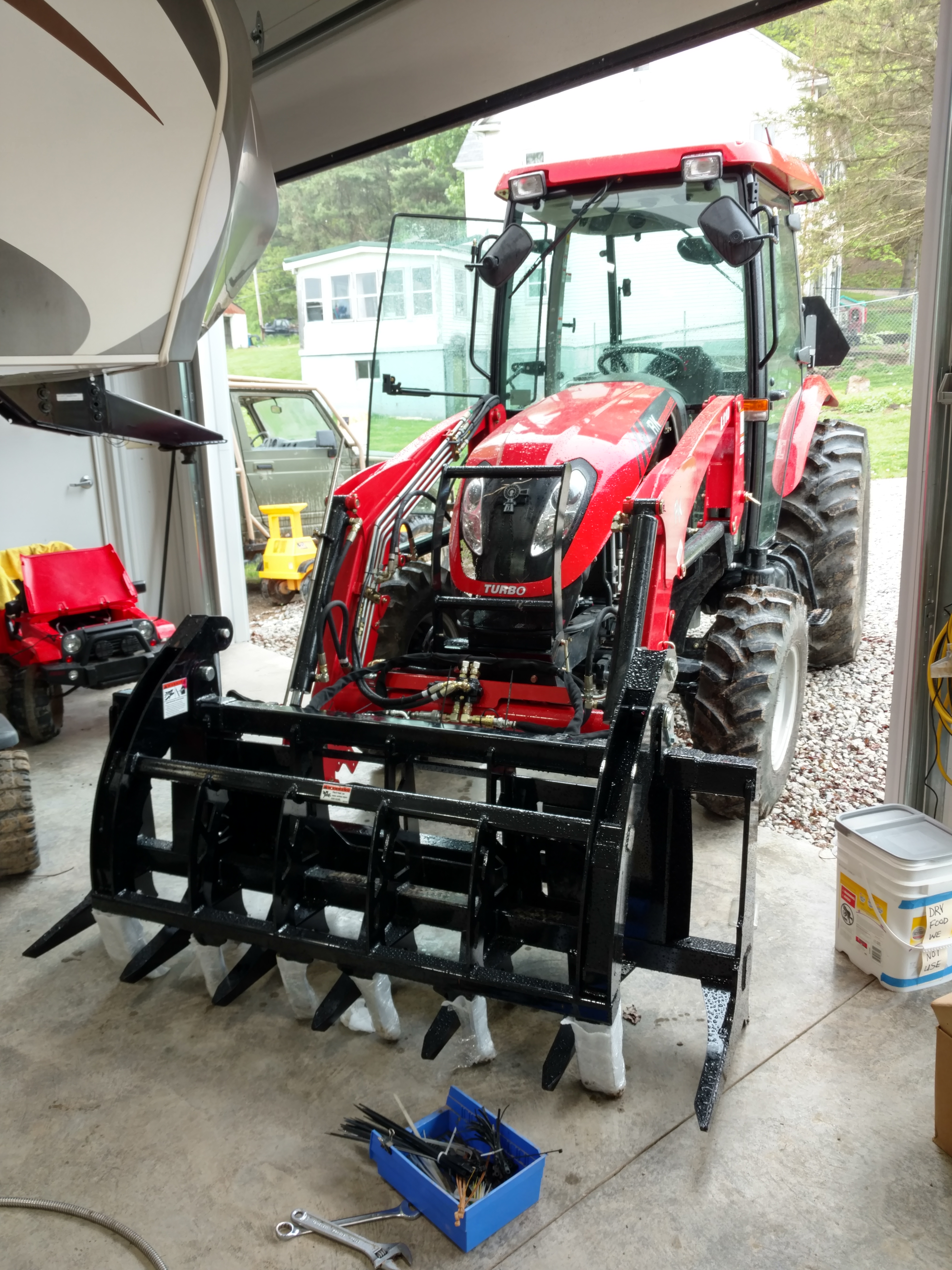

It is a true 3rd function. The joysticks on the 37 and 55s come standard wired with a switch on the handle. The raise/lower and bucket tilt operate the same and the switch moves the 3rd function, in this case squeeze/open the grapple.
None of the three RK37s on the lot at the Spring Hill, FL location have a switch on the loader handle like the RK55s do.
Is this a new development that we'll see on future RK37 build dates, or does the upgraded handle only come as part of the 3rd function kit for the RK37?
Good question, the switch comes with the 3rd function kit.
No, it is a diverter valve. Hold the button(it is not a switch) and use the curl/side-to-side function on the joystick to operate the "3rd function." Not that that is a bad thing. I have one. It works great. Purchased the granite grapple through RK. I love it. I love the tractor. Can't beat the price for this level of quality. I have no need for a true 3rd function, diverter is fantastic. View attachment rkt.jpg
