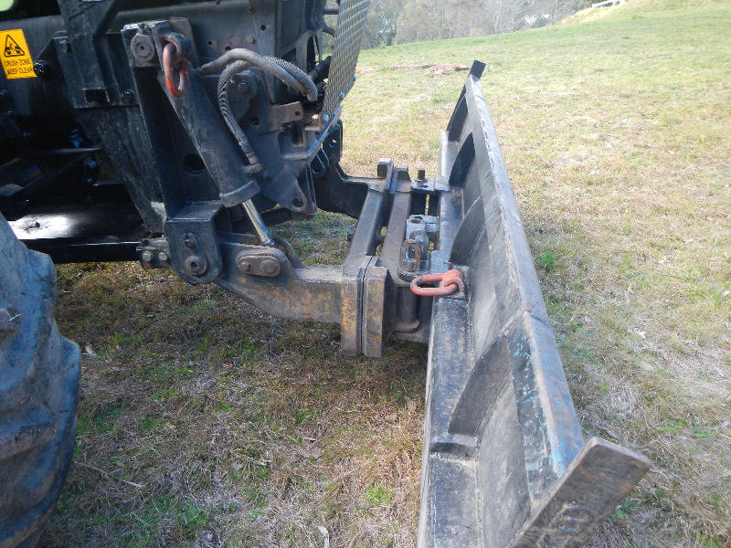

The guy backed out on the Case 310 dozer. Does anyone here have any experience with a dozer blade on a tractor? I'm trying to see if it's worth my time an money to buy the dozer blade for the tractor and do the light dirt work. It has to be better than the FEL? The blade has hyd hookups for I guess the up/down movement and the angle. Thoughs or comments

It takes "tonage" to push a blade full of dirt. Dozers (blades) that are designed to carry dirt are in a "U" or simi U configuration. I just don't think you'd be happy with a flat, lightweight blade on a 3500# tractor. Not downing your machine at all, but for pushing as much material as you describe, and the price of the blade, you may as well pick at it with your tractor fel & box blade. Now that blade you describe would prolly be real nice for finish grading (1" minus cuts) but it just is not heavy enough to do what you describe, the slightest down pressure on the blade will make your 4wd inefective real fast. Ever noticed how when using your fel, that slight uplift when loading your bucket transfers a bunch of weight onto your front axle giving you some good "grunt" into the pile? You will not see this effect with the dozer blade on your tractor, if anything, the opposite, or what I described above will ocour.
   / Dozer vs Tractor w/ dozer blade #20

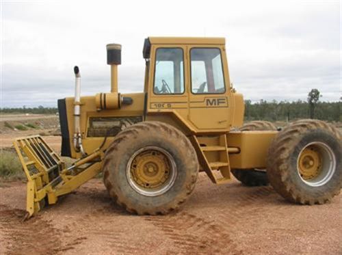

IMO I wouldn't be wasting my $ on fitting a dozer blade on a 30hp tractor & particularly after looking at the photo's of what you're trying to achieve - heavy pushing with dozer blades causes all sort of drama's/fatigure on Ag tractors.
Sure we've had & currently have Ag tractors with blades & they're a cost effective alternative to industrial dozers in light clearing /silage applications...etc, but pushing dirt day in day out is too big an ask.....even with some of our heavy duty set up's (as pictured) I wouldn't be tempted.

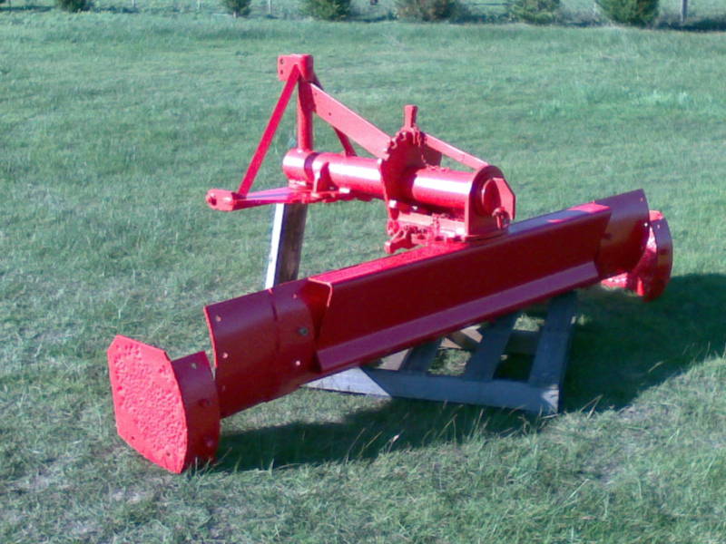

Instead given you're on a limited budget use a 3PL HD Grader Blade on your tractor (it'll keep more of the push load on the implement, rather than like a front mounted dozer transferring direct torsional loads to the tractor.....) ideally with offset/angle/tilt adjustment which will keep the tractor further from edge of the undulation you're trying to fill - & unlike a front mounted dozer blade (which will require constant foward/reverse direction changes) should make the exercise a lot quicker provided you can safely dump material (in a low fairly even row rather than single dump piles) close to the fill site, then it's a relatively simple matter of running the tractor/grader parallel to level & (more safely) move material over the edge (or grade the site level using the rotational arc method of grading to again move excess material to the edge & into the fill site.
Also below is a photo of IMO the ideal 3PL grader blade for this task with offset/angle/tilt adjustments & blade bolt on end caps which helps carry/flow the material off the blade in these types of applications (offset, angle the blade back, slight tilt, fit one end cap to th opposite end & the material will roll/flow along the blade easily using less hp & wear/tear on the equipment):-
