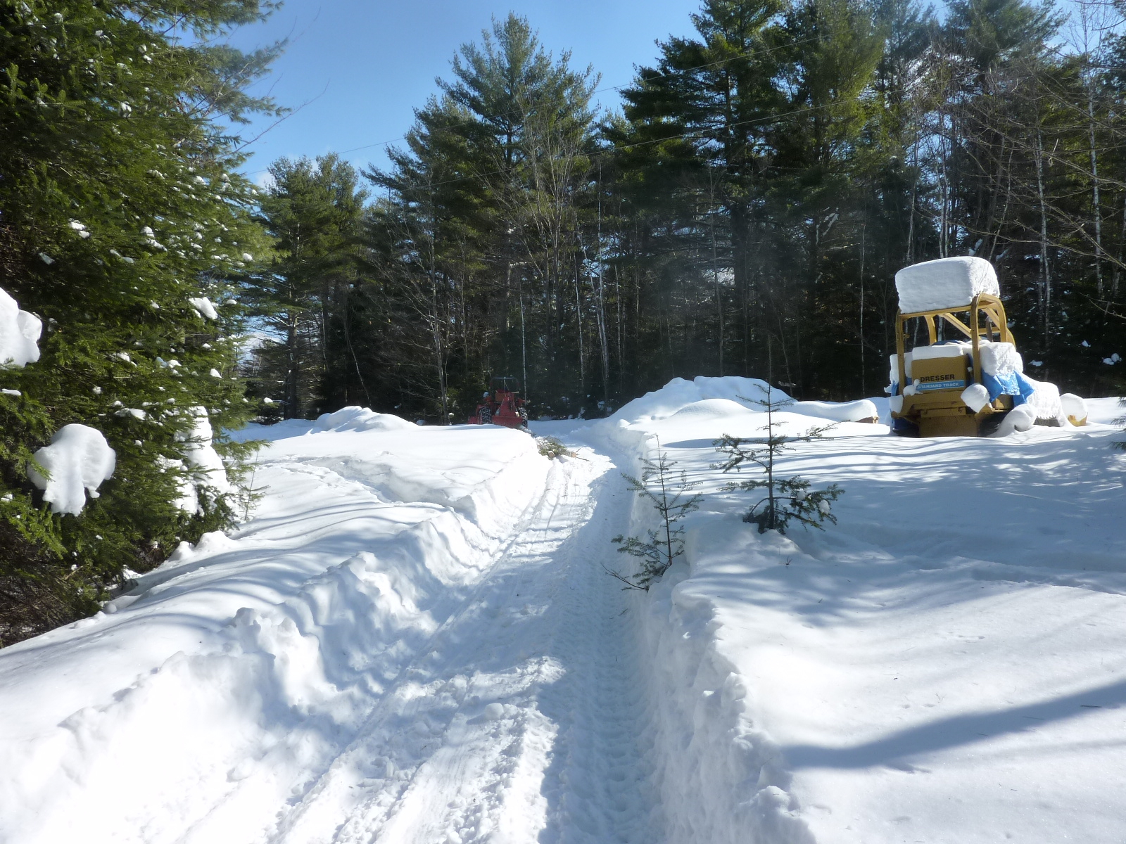

Mine is a 1991 Dresser TD7G that I have owned since 2010. Every winter it sits from mid November until mid April minimum. When I put it away I clean it up the U/C and exterior with a hose. Drive it up on some planks, grease it, charge the batteries, and cover the dash/instruments with a tarp so air can circulate. In the spring I charge the batteries again, Check the fluids, and get her started. All summer it gets sporadic use. Might use it every day for a week then it might sit for a month. Grease every use and change fluids per maintenance schedule. Nothing ever 'froze' up. BUT it has wet brakes and clutches. Older machines with dry clutches and brakes would probably 'freeze' up sitting so long.
