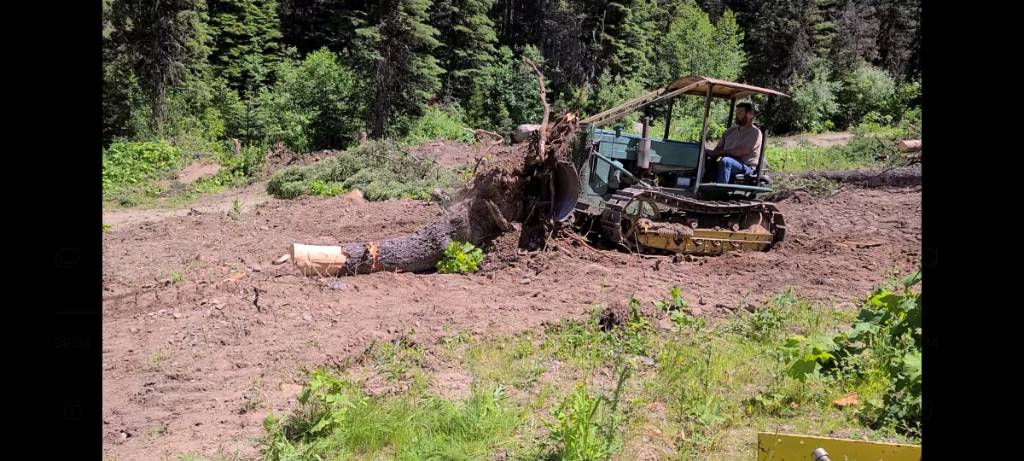

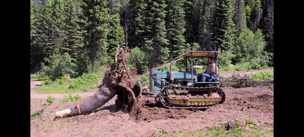

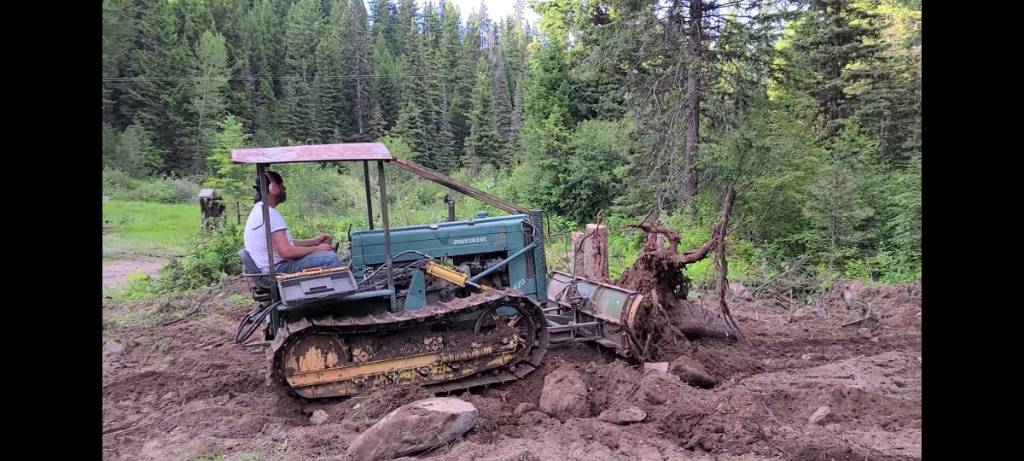

For my evergreens in Northwest Montana I am able to use my 1944 John Deere 420 crawler ~ that boasts a 2 cylinder gasoline engine and push over anything 2 feet diameter or less in 1-10 minutes. Anything bigger and drill some holes and fill with diesel a few times and burn them out, or if I'm in a hurry or want to have a little fun with it, auger bit and a fuse and special ingredients...

Those are some pretty cool pictures!!! Do you have a youtube channel?
