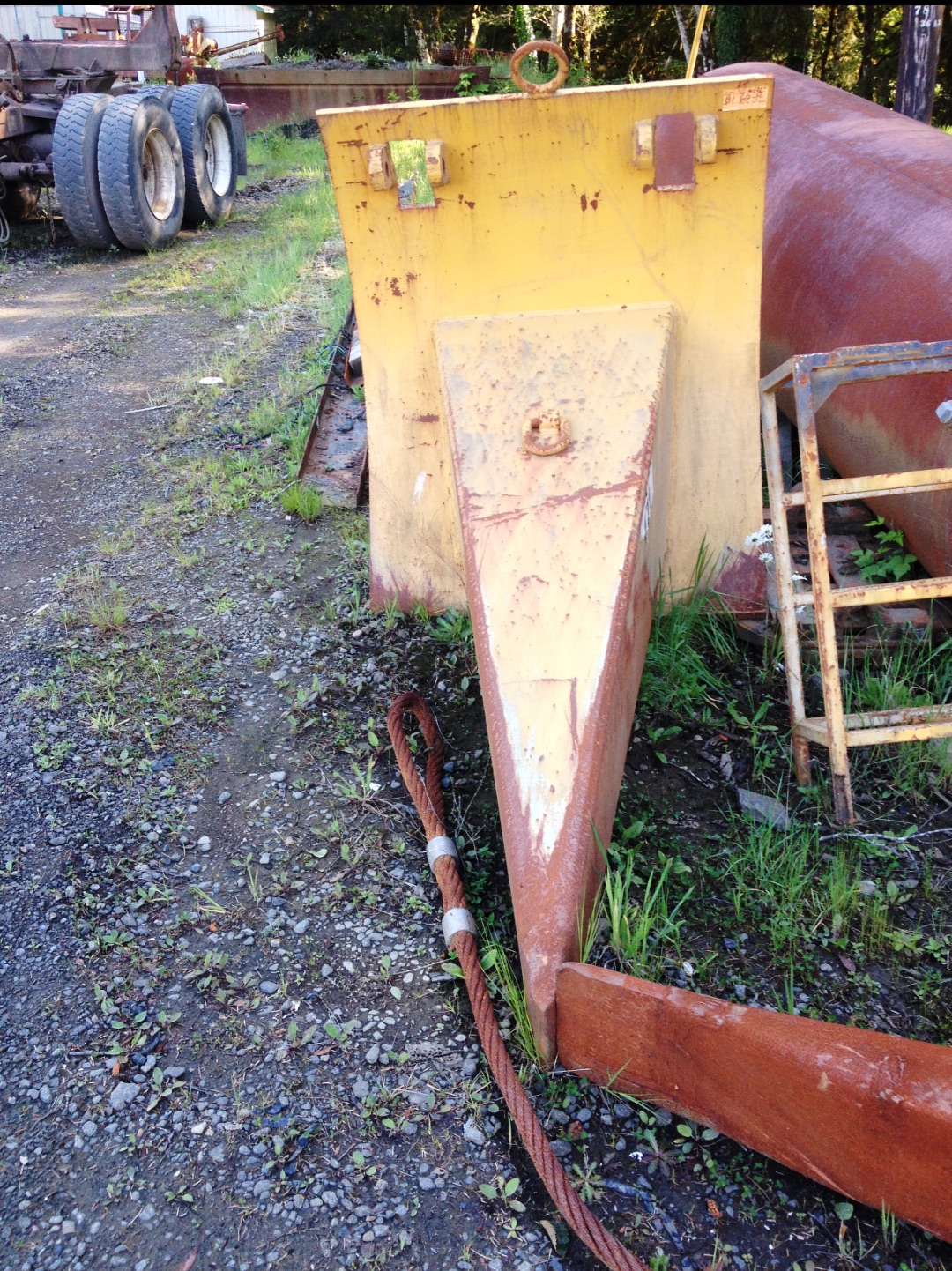

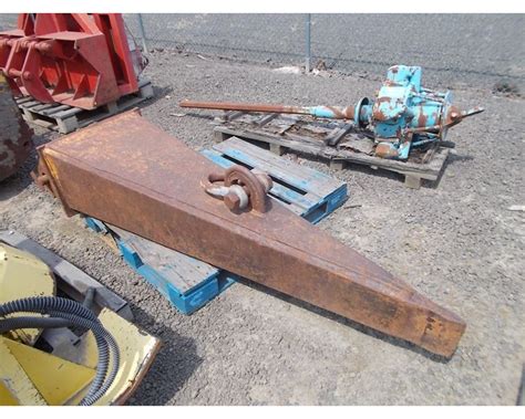

You probably can't find dozers with stump splitter blades now. They converted large stumps to more manageable pieces for removal.
