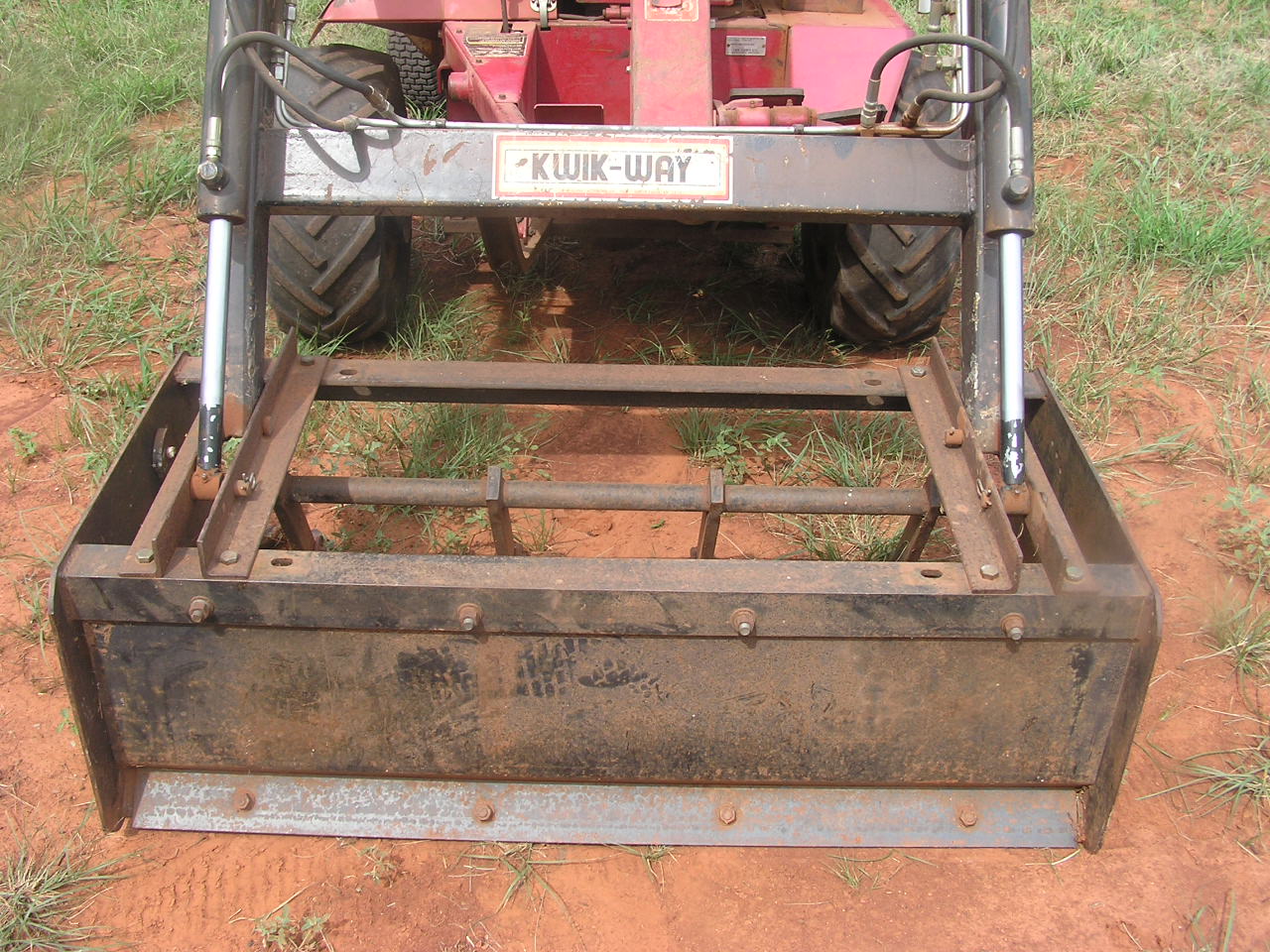

   / Dozer blade on a JD 3-series? Am I crazy? #9

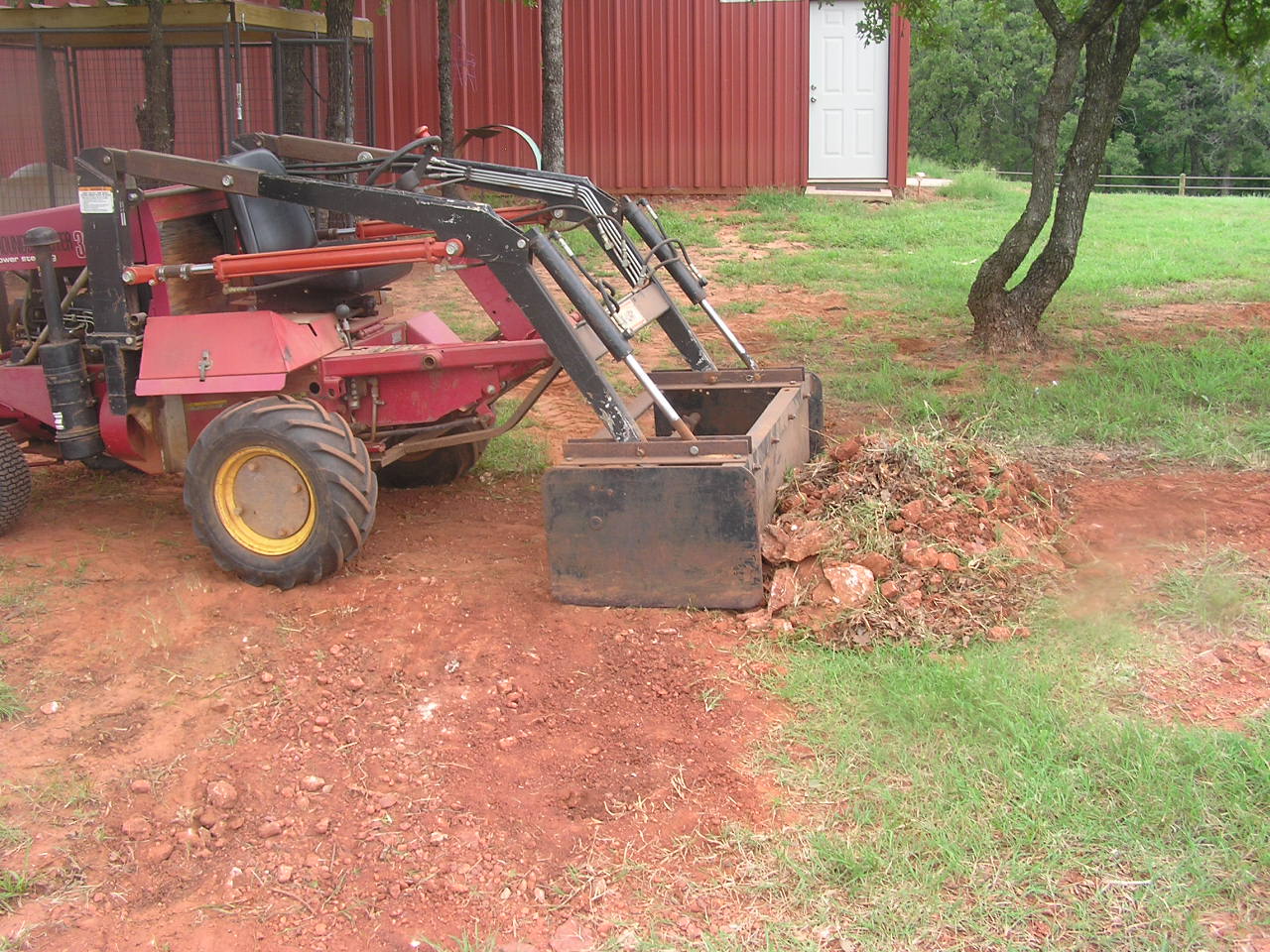

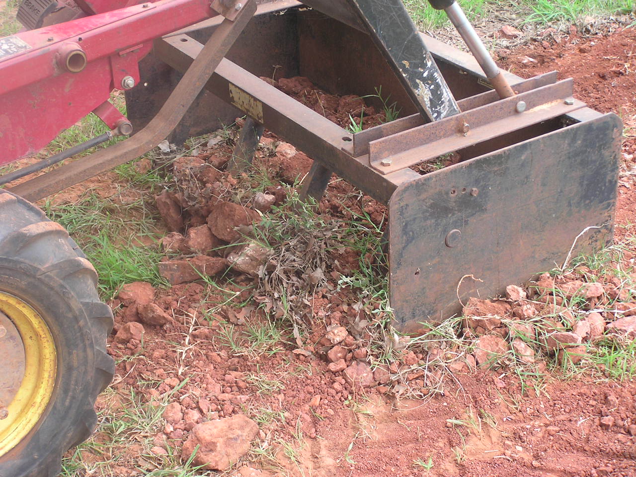

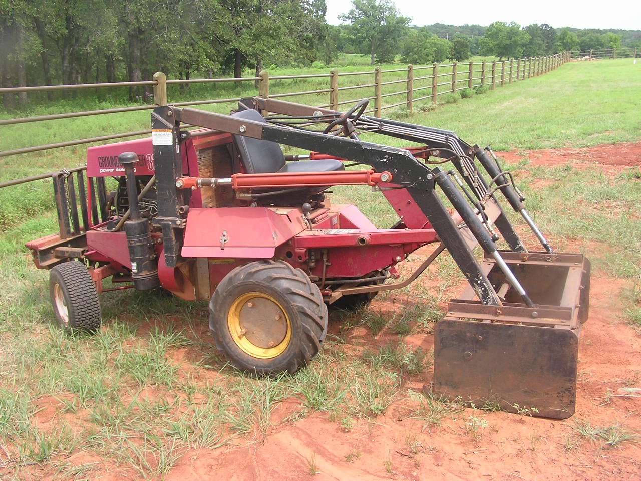

I sometimes use a 4' box blade on my loader:
Dozer mode. :thumbsup:
