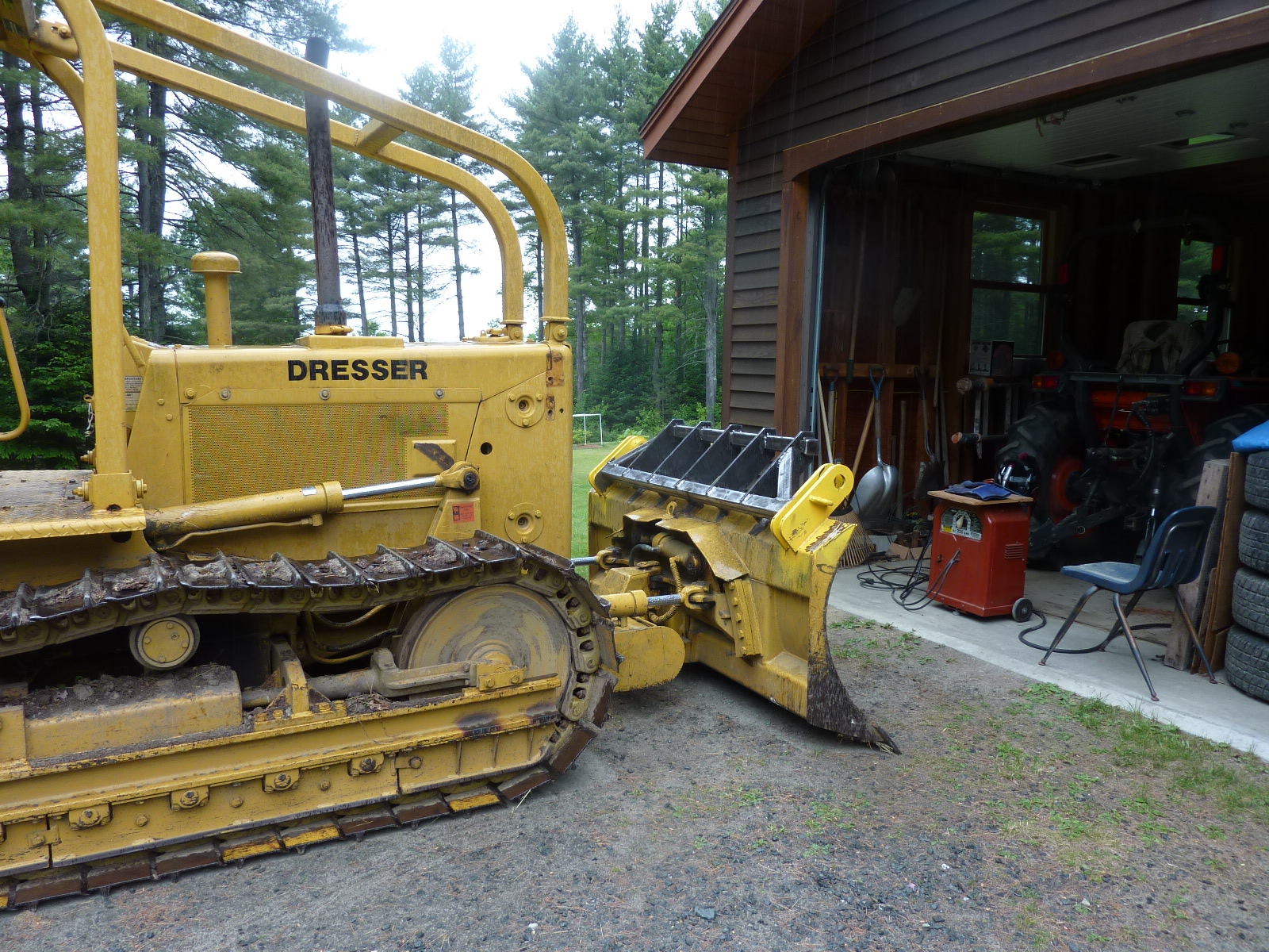

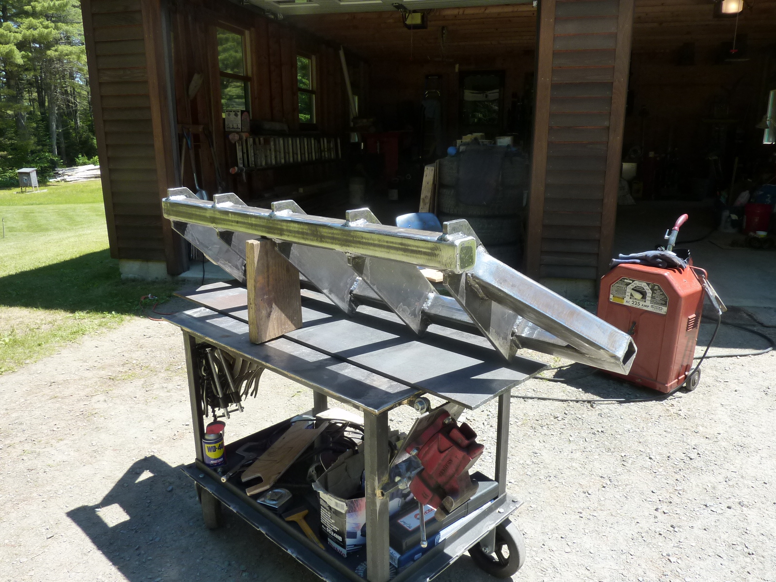

Put an extension on the top of my dozer blade for working in the woods. I guess you could call it a brush/tree guard. It also braces up my spindly looking root rake hanger brackets.
I just had time to get it tacked in place this morning before it started to rain.

Can't open your pics.
/ Dozer Blade for in the Woods
Try it now. Fat finger trouble.
/ Dozer Blade for in the Woods #4
Much better.
That's an excellent addition!! Nice work!!!!
/ Dozer Blade for in the Woods #7
I thought it looked like a vacuum cleaner handle. You gave it a good use in it's second life.

You are onto the right track, but you need to make it stick out a lot farther. When pushing brush piles and logs, they like to roll up over the blade and your guard will help with that, but they will still get over it. When taking out trees, you want to cut the roots with the corners of your blade, then build up a ramp and push it over. The farther out your guard sticks, the faster you will push over big trees.

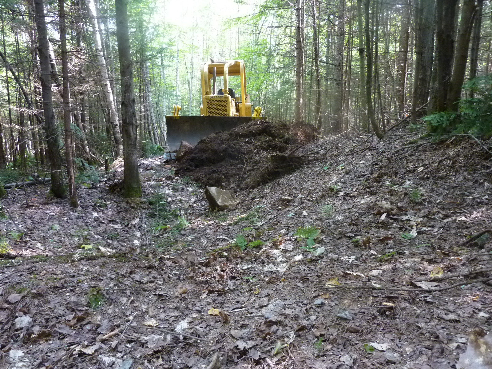

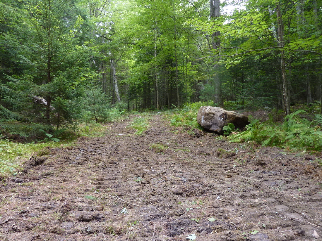

It is a TD7G, 70 hp and about 14,500 lbs so it is a small dozer. A little bigger than a D3. About like a JD450. It does what I need pretty well but like any machine something bigger would be better sometimes. I have a good network of old skid trails from previous logging over the years but before I can use any of them for a tractor road they need to be cleaned up and or reshaped. Most are grown up with small trees and as you from your logging experience they are full of ruts, big rocks, and stumps, The TD7 is great for fixing them up.
Here is a rock I took out of a good trail except for the big rock and a little reshaping. Having a 6-way blade out in front of you makes it so much more doable than trying to use a tractor.
gg

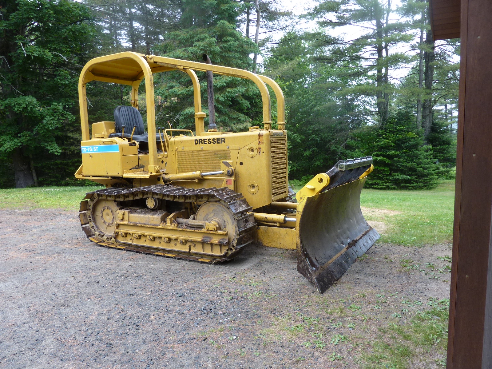

Anyway I'm glad I did. That one is a 1991 vintage with 3200 hrs on the meter what ever that means. It was in good shape except the track chains were shot. I bought it for $10,500. Here it is for sale - note the loose tracks.
Edit: It has a good old cummins 4 cylinder 239 motor air aspirated.
