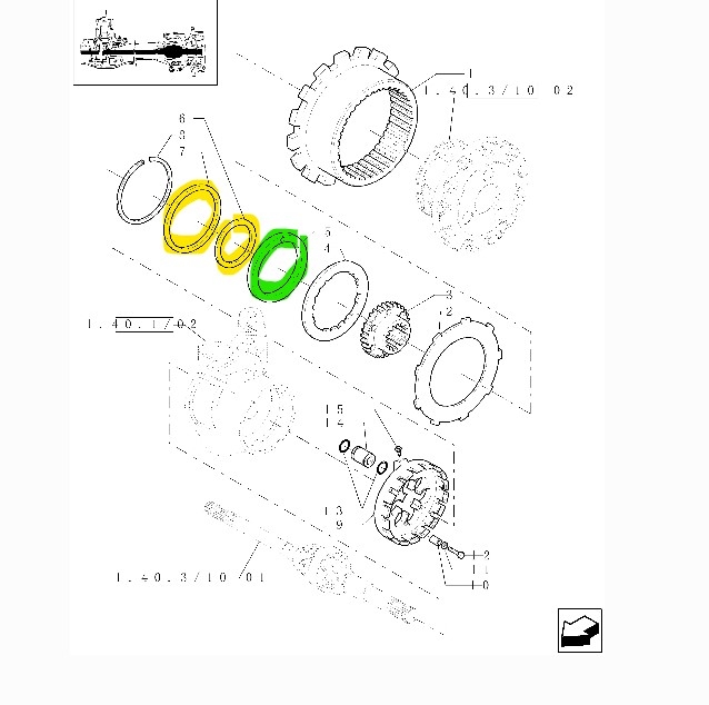

I have a grillo ,case 1056xl and now i buy an valpadana 6575 isr-rev,what is it about.I the manual it says to use utto(Universal Tractor Transmission Oil)GL4 because it's ok to use when require a combined hydraulic, transmission, and final drive fluid with wet brake and power take-off performance.In the tractor i don't know what type of oil is in the front axle.It's only get hot when i run top speed after 1 km because the drive axle spin very fast .Today a wheel on the front almost block for a few second.The wheels i can rotate by hand if i lift the front of the tractor.
   / dot4 in when mineral oil needed #17
The seals on the front brake actuator discs are probably swollen from the Dot 3 fluid and may start working again after flushing with mineral oil, but not likely. The actuator disc should be located in the front hub. I don't know what axle a Valpadana 6575 uses, but I have attached a picture of a front hub from a Fiat/New Holland hub from a TN95A. The actuator disc is #5. The inner seal is #6, outer seal #7.
If you could post some pictures of the front axle and hub, it would help. Valpadana is part of Landini, so a Landini dealer may be able to help with parts.

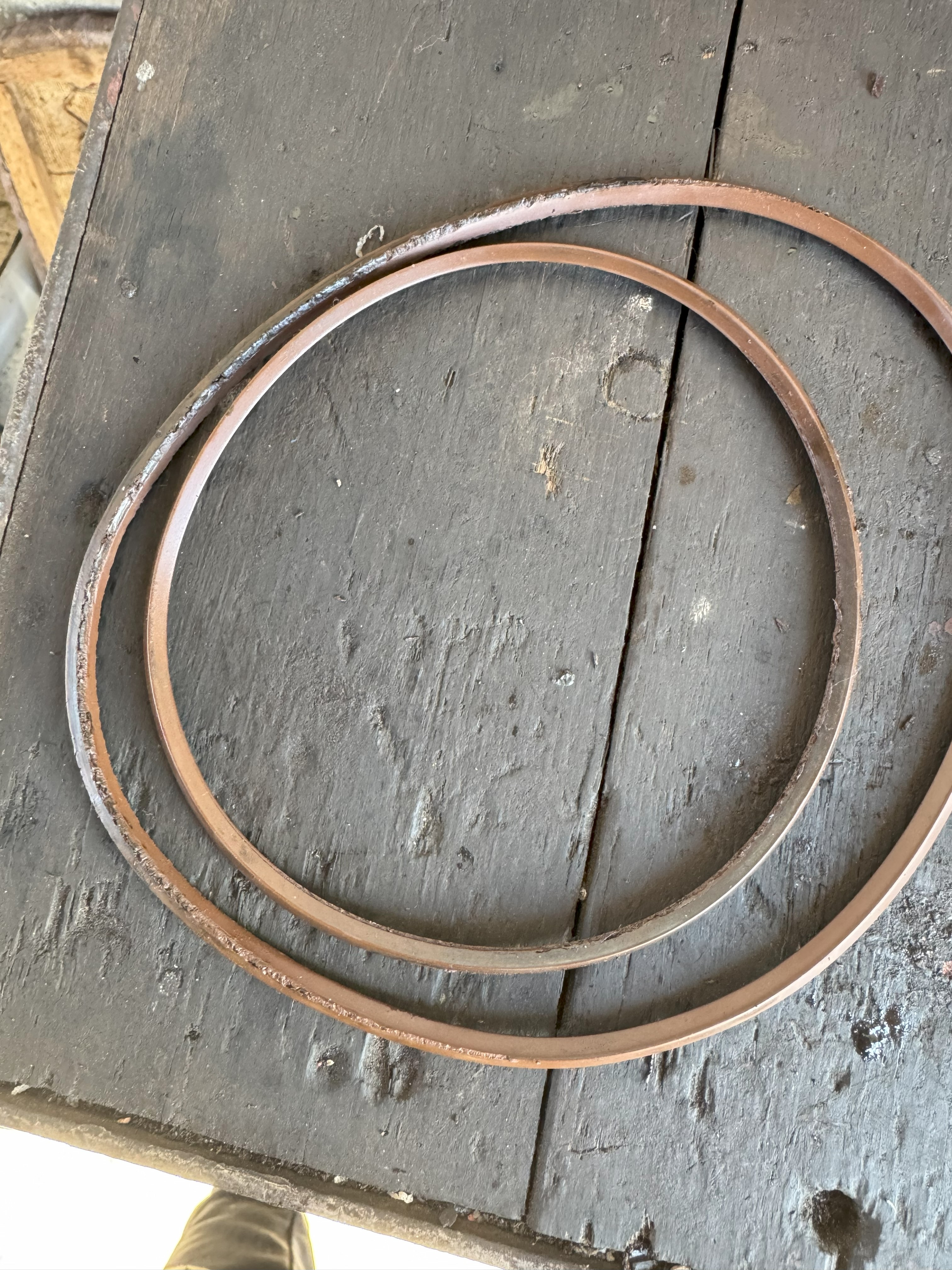

i remove the seal and this is the cause.i find only the biger seal to buy.I think to put an o ring to replace the small one.

   / dot4 in when mineral oil needed #19
Try an hydraulic shop. Maybe that have a one of those teflon piston seals that may work in your application.
#20
Very small chances.
