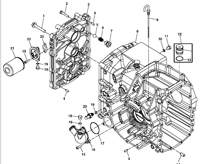

I agree with that. That would not support much tongue weight.
   / Don't use brush mower with trailer hitch kit installed on 3032e! #15
That casting looks to have thinned out in the middle for some reason. I would expect it to remain thickened across the entire area and then some to the sides. Very poor engineering. I don't think I would trust that to pull very much with. At least cast aluminum can be easily welded if it comes to it. You may have to turn the tractor up on edge to get a good job though. All the oil has to be completely cleaned from the repair area to start.
At least if you have insurance, let them deal with full replacement of that section of the tractor rather than half-assed repair attempt.

As to the strength of the hitch, it's not designed to be violently whacked like that. Such a blow shattered the brittle casting of the axle assembly.
Bummer. Let us know how this comes out.
   / Don't use brush mower with trailer hitch kit installed on 3032e! #18
Ugh! That's bad. Certainly not a job for JB Weld. To TIG it up right it should really be removed from the tractor or at least remove the rear transmission housing cover so you could get in there and TIG both sides. That would also allow you to clean out any remaining fluid to avoid a fire.
Assuming it didn't do any damage to the rear cover, it looks like you will need a new transmission housing (LVU19030) which is $776 at GFP. I'm sure there will be other gaskets and seals which would need to be replaced anytime the housing the replaced. I suspect the larger portion of the repair expense will be labor as removing and replacing the housing and contents looks like a major undertaking.

Yeah, I'm guessing the labor will be 3 times the part cost. :(
