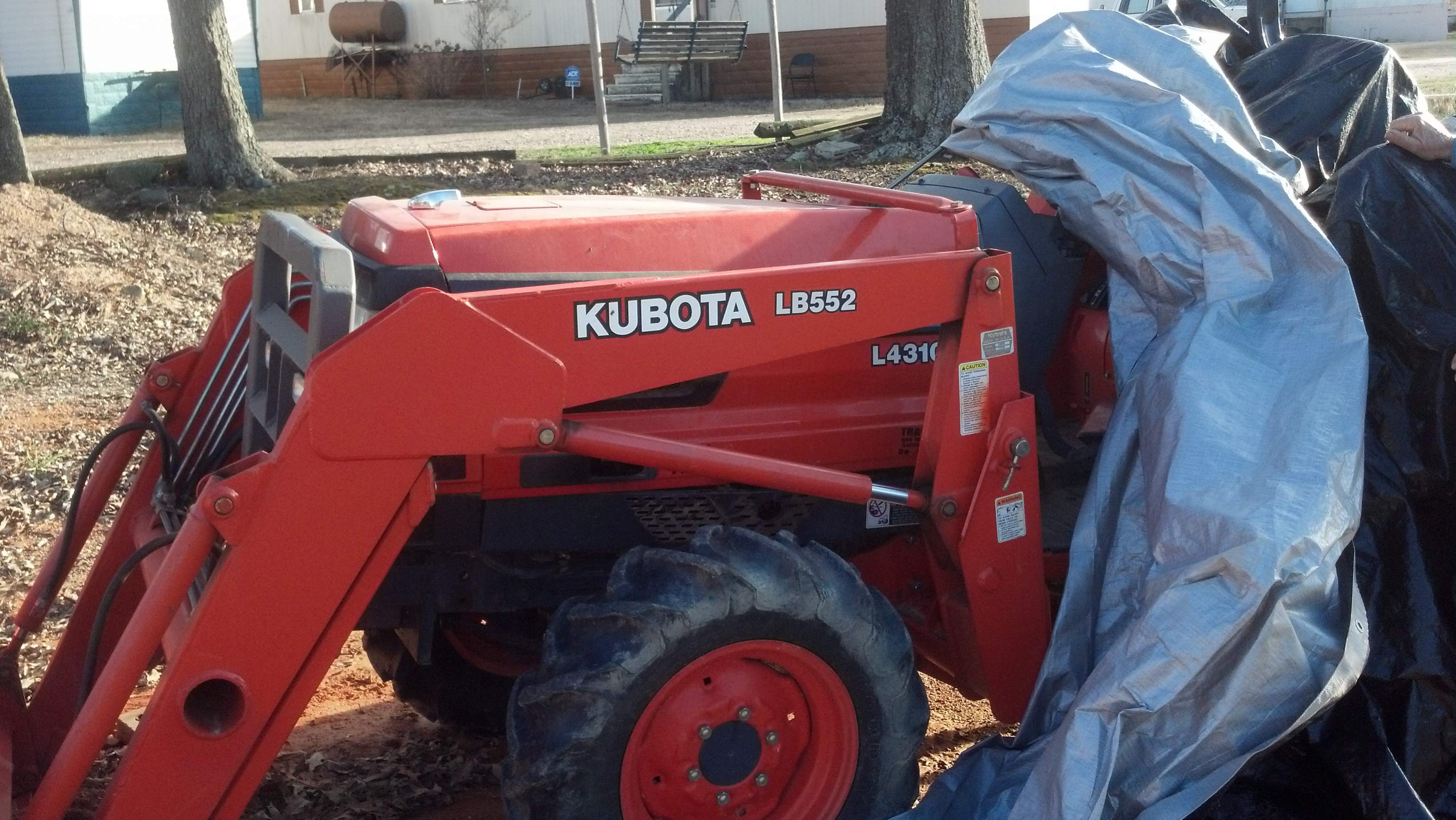

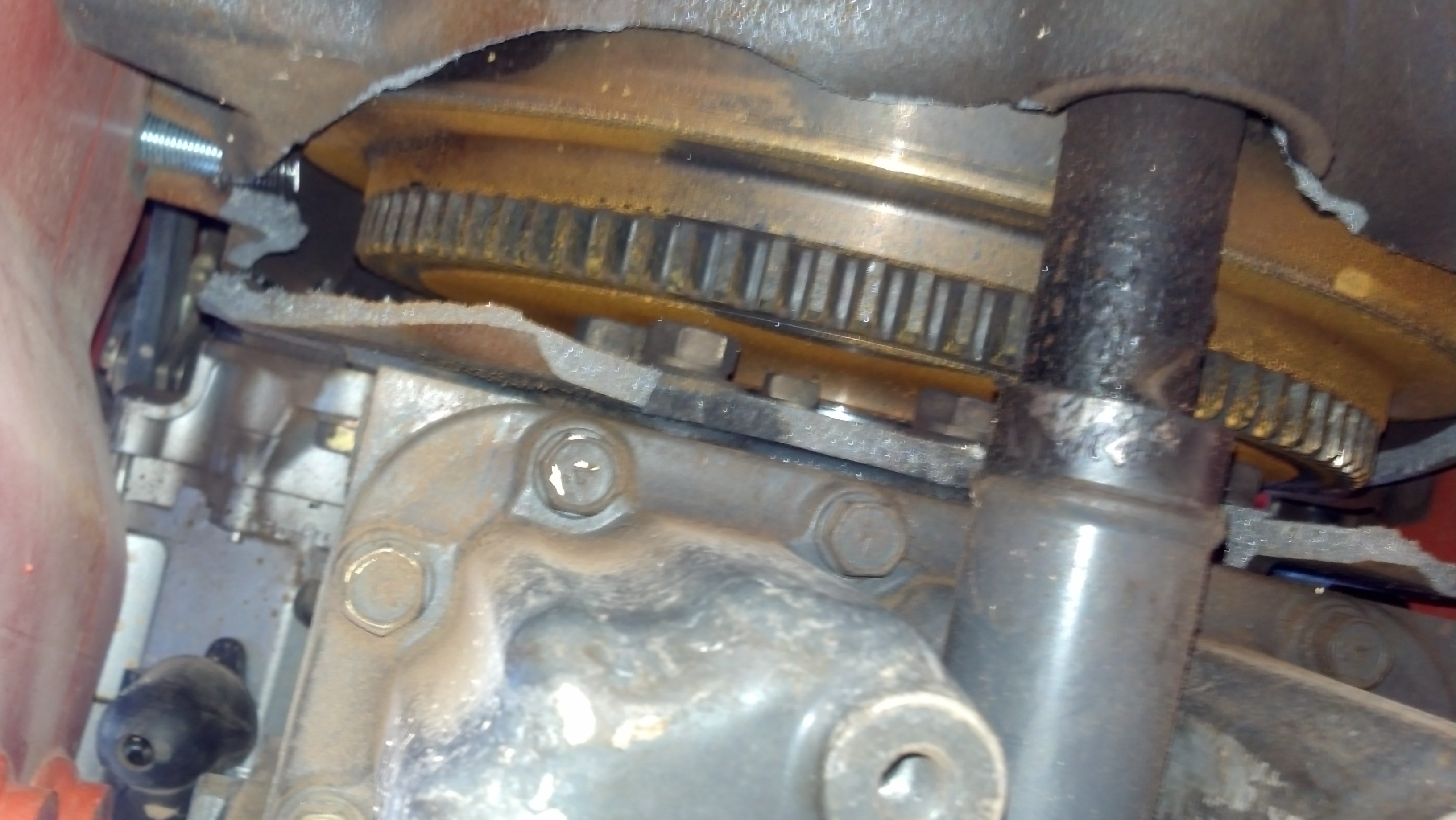

This is an old thread, but I have a sad update. The tractor broke in the middle, where the engine bolts to the transmission. My FIL was loading dirt into his dump truck. When he went into the pile for the second bucket full, it shuttered and the engine stalled. He called me to come look at it and when I got there I could see it was no longer straight, kind of sway-backed. Looking underneath, you can see the bottom of the flywheel.

Oh wow, that's terrible! Do you think it was related to the earlier problem with the FEL mounting bolts?

I do. The pictures on post#23 show two of the mounting holes had nothing to bolt to. You can also see a piece of the casting had already broken off one of the bolt holes in the transmission case. That is where it cracked, in the hole with the broken casting. Grandad4 was right about the loader not being correct for the tractor, causing the casting to be overstressed. I had no idea someone would pair up something like that, and neither my FIL nor I knew enough about tractors and front end loaders at the time to see it wasn't right.

Yeah, that's what I was wondering after seeing the picture with the two holes not being used....ouch. I wouldn't have ever thought to check that a tractor had the right loader on it either....at least not with anything reasonably modern. What a bummer :(

Pictures of the carnage. In the last picture the bolt hole that had the broken casting can be seen in the upper left.

Aww, geeeze, that's flat-out painful to look at. What a rotten deal. :(
