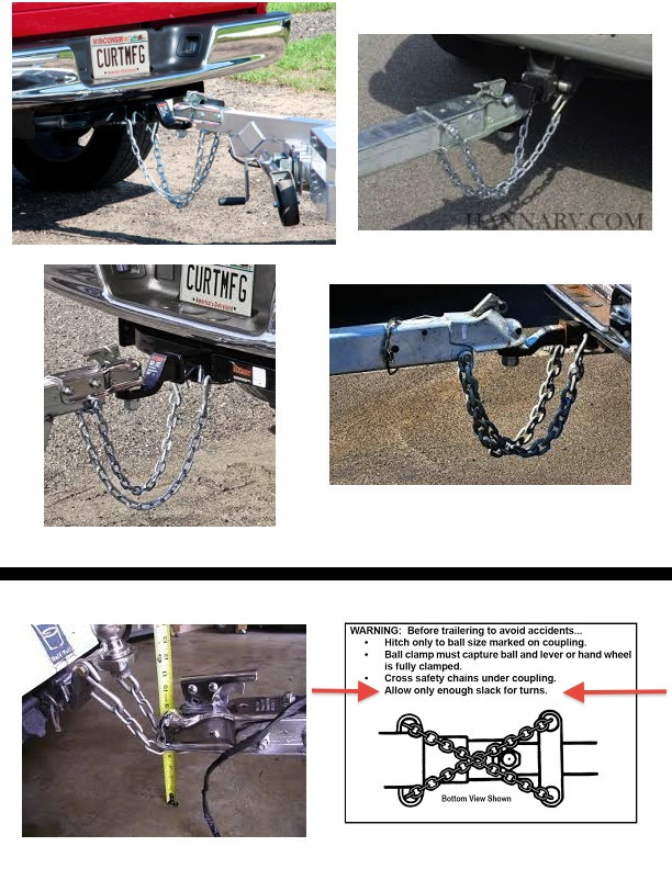

Yesterday I was stopped in traffic beside a pickup towing a dump trailer. The safety chains were about 4 feet long, and almost dragging the ground, BUT, they were crossed for safety. If it had uncoupled, the tongue would have drug the road anyway, and had about 8 feet side-to-side and front-to-back swing.
Many times we have heard the advice "Cross your chains to make a cradle to keep the tongue off the road in case the coupler disconnects" but I bet few people actually check their chains to see if that is true for their setup.
Have you ever tested your chain adjustment by dropping/lowering your tongue to see if it is caught by the chains?
Attached are some photos of what I believe is excessive slack that defeats the crossed-chain purpose. And a photo of a test.

Nice license plate in your photos of what not to do...
good point about testing.

Having had a trailer come uncoupled, I can tell you, I will never use hooks like the ones in the photo's.
An uncoupling is potentially a violent event.
The trailer jerks back hard, to the limit of the chains. Any braking by the towing vehicle, causes the trailer to jerk forward, where the tongue hits the towing vehicle, or the chains catch it again. This process repeats. Sometimes, until the hooks fail.
No better definition of surreal, than being passed by your own trailer.
Since that event, I only use heavy duty quick links to attach the safety chains to the towing vehicle, which are closed hand tight. They cannot come unhooked.
It's less convenient than the chain hooks. But, much less inconvenient than having your trailer get loose.

I find it interesting that the 2 pics with the license plates in them both have the hooks attached backwards. If that thing pops loose from the hitch ball and bounces back into the chains and then forward again, those hooks are coming off. Pic in the upper right corner has the hooks going the right direction. Harder to tell in the pic below that one, but looks like they may be backwards too.
   / Don't be a safety chain slacker
The 2 left photos hooks have the springy safety wire.
I've never liked the bent-rod hooks, so have always changed to stronger safety hooks, or quick links with a WLL marking.
Gravity keeping the hooks on isn't reliable enough for me. :)

Has anyone notice the "pictures with a license plate" are from Curt manufacturing... a trailer hitch manufacture! lol
