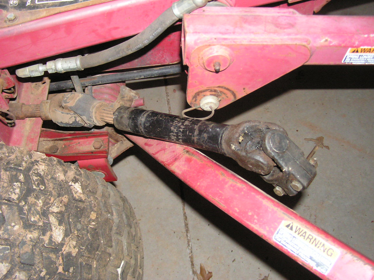

I am posting this for those that don't know about phasing u-joints.
On that drive shaft, lining up the zerks when you slide it together, should put them in phase.
They are laying 90 degrees out of phase in your picture, that is what made me think about it.
   / Dont ask me how I know #13
Hi xfaxman,
I was a master ASE mechanic and jeep freak in a past life and do understand ujoint phasing having built a few drive lines for custom work.
But I don't understand what is wrong with the INCORRECT picture.
As I understand as long as the two crosses (ujoints) are inline with each other so the angles at each end are complementary, they "should" operate vibration free by canceling out each other.
What have I missed?
   / Dont ask me how I know #14
They will vibrate when the shaft angles are like this.
The theory and math formulas are above my comprehension, I just know on my TORO Groundsmaster, it vibrates if I slide it together out of phase.
   / Dont ask me how I know #15
Great information Xfaxman. Thanks for sharing!
   / Dont ask me how I know #16
Please correct me if I'm wrong but I thought there master spline that will only allow you to put the 2 halves together in one spot only.:confused3:
Some do, some don't. The TORO shafts have an indexing system but after years of hard use (and not enough grease) the splines will wear enough to go together at any angle.
Hear is an over 20 year old shaft, pushed together 90 degrees out of phase:
