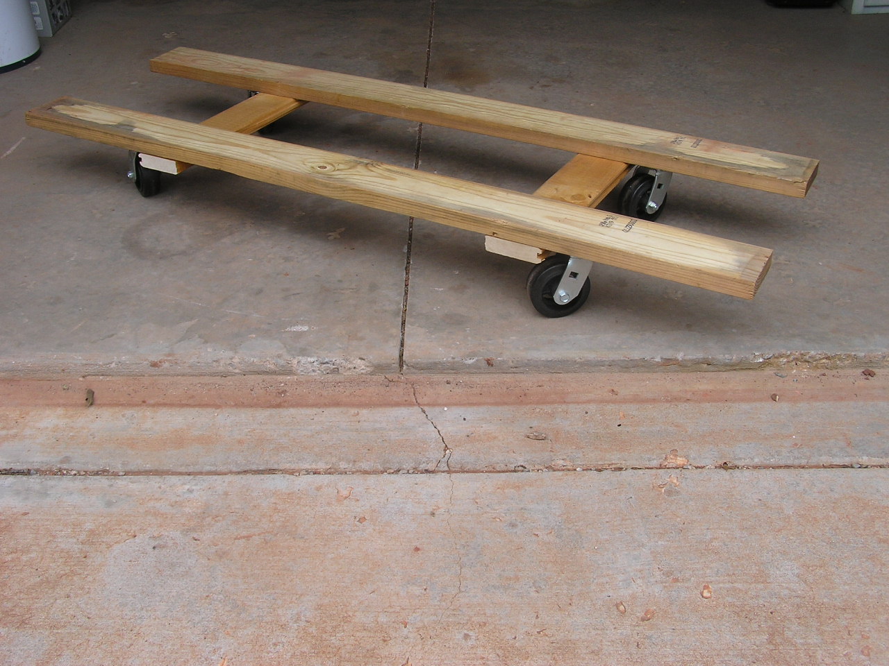

I made dollies for all my implements except my rear finish mower, which has 4 wheels. I used 2x6s (I think 2x8s for the rotary cutter) and castor wheels. I can now hook up or unhook an implement in 2 minutes or less. They can also be rearranged easily in my corncrib. I can post a pic if you want to see one.

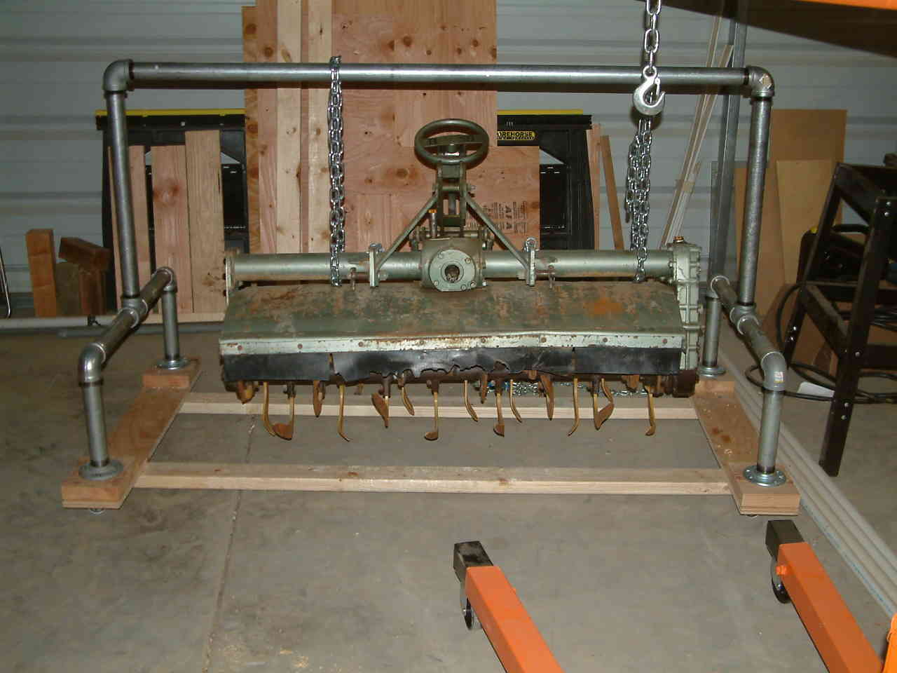

Here's the dolly I built for my 4-ft wide Yanmar RS-1200 rototiller. Works fine if you have a garage/shop with a concrete floor. Wheel the rototiller into place and hook it up to the 3pt in about 2 minutes time.
Used metal casters from Home Depot ($4.50ea) and some 1-1/4" pipe/fittings that I had lying around.

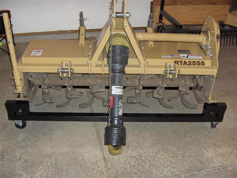

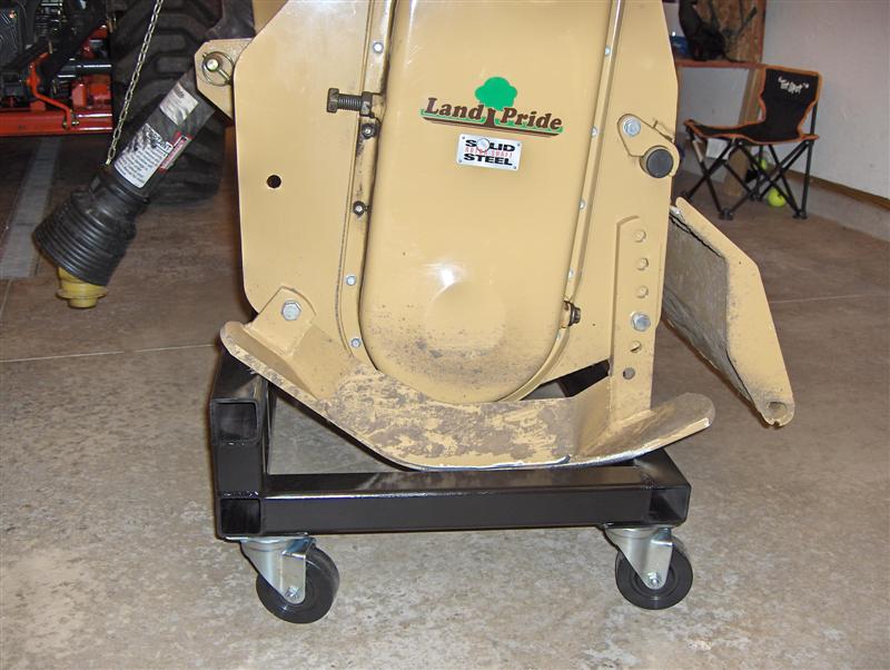

I made a tiller dolly for my LP 55" tiller. Its made with 2" square tube and some caster wheels. Here is some pics.
