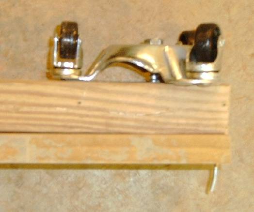

I bought a couple of TSC castors that a like mini 3-wheeled dollies. I'll attach them to a 2x4 and join the 2x4s with a 1 by to keep them at the right distance apart. The dolly plus 2x4 plus 1 by will be near the height of a 4x4 that JD recommends putting the 4' brush hog onto in storage.

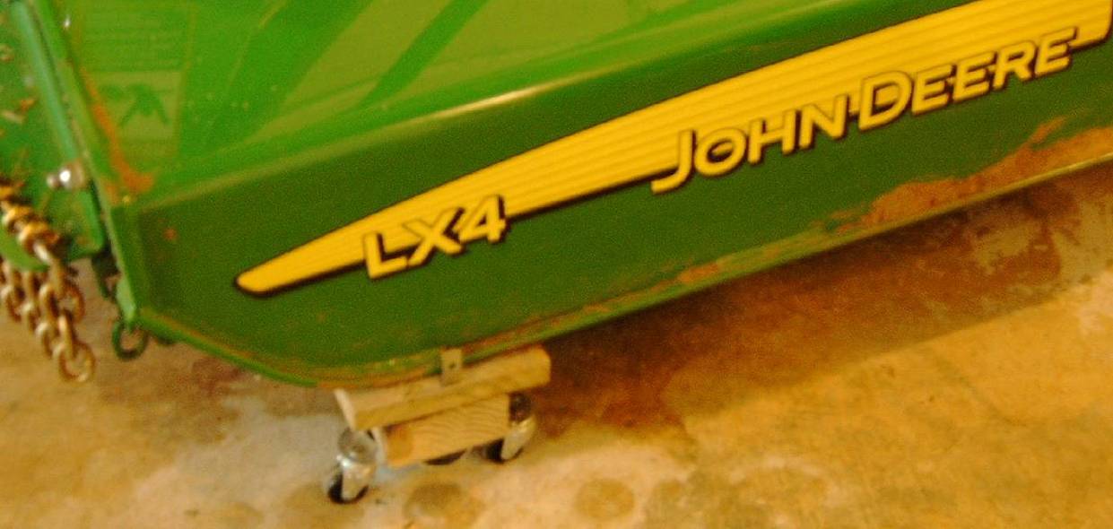

Here's a picture of the dolly underneath my cutter.

Here's a picture of the dolly attached to a 2x4 which is attached to a 1x6 that extends out about 1/2" beyond the outer side of the cutter. Note the little "L" that is one the end to keep from offsetting the dolly too far under the cutter. There's one on each side.

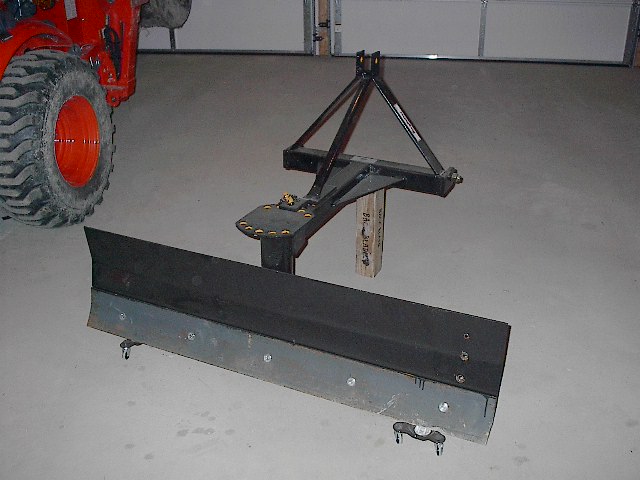

Those casters are like the furniture casters I bought to use with my back blade. They work great. Gerard

Would have preferred the cast iron caster wheels of about 2", but TSC was out of them. Also, I could have only put a 1 by between them and the cutter or the 3 1/2" would have been exceeded. My draft arms only lift it about 4" off the floor.
The little wheels underneath my 420# cutter roll fine. They won't work in dirt or gravel though.
