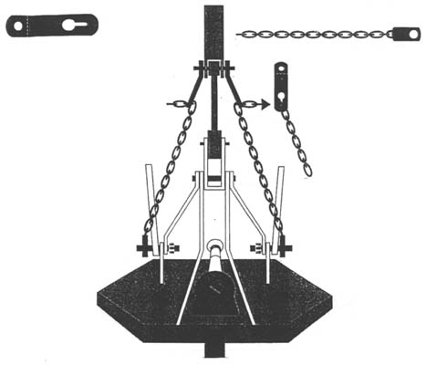

If I may, I believe that he is referencing to the third arm bracket on the tractor end, as carrying the load. The chains attach to the 3/4" pin on the tractor and then, the 7/8" pins on the implement. (Cat 1)

OkieG I'm with you, I would like to see a picture as I can't make a visualization of the set up.

<font color="blue">I would like to see a picture</font>
Picture Above.

Please excuse my ignorance, but what a peculiar looking set-up. Somebody put a lot of time in to figure that out. Does the bar with the pins on top connect to the toplink tractor mount?
Just when I think I'm starting to get a handle on things, something comes along that throws me. I appreciate the picture (and yours too Jerry). I think I have a little better idea of what you're talking about, but I've never seen anything like that at the tractor stores I've been to.
Remind me,...what does that set-up do for you?? Thanks again.
OkieG
/ Does your 3-point take a hydraulic beating #37
You won't see it in stores as it's an industrial cutter used in maintaining utility, etc, right of ways. Closest thing I've seen is BH406. The beast is rated for 4"dia, has 165hp gearbox and has 1/4" deck.
It is very heavy, hence the need for the lower link relief. The front of cutter is essentially carried by the chains instead of lift arms while mowing.

OkieG, I'm attaching a photo of my old Ford Jubilee with the setup Jerry showed. In principle, it works just like the one MMM posted. MMMs setup is adjustable in height by moving up and down the toplink whereas the chain setup is adjustable by taking up more or less links in the chain on each of the sidelinks.
In this photo I was also experimenting with using chain instead of a toplink because I was mowing on some very tough terrain. Some folks say this is dangerous if you hit something with the front lower lip of the mower and cause it to flip forward. /forums/images/graemlins/shocked.gif I never had that problem. /forums/images/graemlins/grin.gif
Both of these setups are especially good if you have a 3PH that leaks down and you constantly have to correct for that leakage during mowing. It can also be used to relieve any pressure on your 3PH during mowing.
