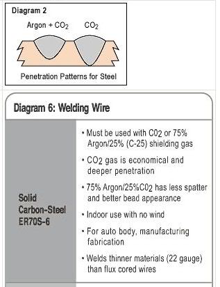

Been thinking about upgrading my welder. I have a century 90 amp mig that is run off of 20a/120v that I've had for 15 years. Thing is convenient being small compact and able to do small repairs. Works great on small gauge steel and stock up to about 1/8". After that it seems I can still get good penetration if I crank the amps up to max and take it slow but it seems the welds aren't as strong as they should be. Will doing conventional Mig w/ a shielding gas get me better results or is looking at getting a new mig with more amps the answer? Would like to be able to be able to weld up to 1/4" stock.
The welder is capable of running a shielding gas but all I have ever ran through it is core flux.

I'm all for flux core, spent a life time running it. You should get more penetration with flux core than with Mig. Have you done any destructive testing to see your weld results? I should add here I've only run one 120-volt wire feed in my life, and I couldn't get away from it fast enough!
If you have your heart set on running gas, I suggest 100% CO2 for the best penetration.

all things being equal fluxcore penetrates deeper than mig.a 220 would better than a 110. i have used a lincoln 135 it would be better than your 90 amp.90 amp machines just is not enough for a 1/4.
