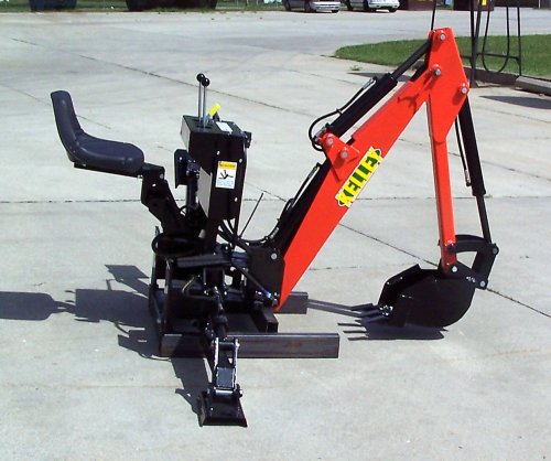

I have been looking for a backhoe attachment for my New Holland/Ford 1715.
Does anybody know of one that will work?

seems like a woods 6500 might fit?
/ Does one exist? #4
Kelley B600 or B750
I have a B600 for my Case DX33, which is actually a descendent of your Ford. You will have to call them if to see if they have a subframe mount. They did not have one for my tractor, so it mounts on the 3 pt hitch and also has a bracket that mounts to the drawbar. Two top links connect from this drawbar bracket to the backhoe. It basically creates a "5 point" hitch for the backhoe.

if no subframe.. fab one.. i id that for a woods 6500 on my old ford 850.. works good!

I have a Woods 7500 on my 1715 with a factory sub-frame and it works great. For some reason there seems to be quite a few used backhoe attachments for sale on my local craigslist.
/ Does one exist? #11
i have a 6500 on my old ford 850, i made a short subframe for it.. digs great.. has a pto pump.. can dig at mid idle..e tc..
