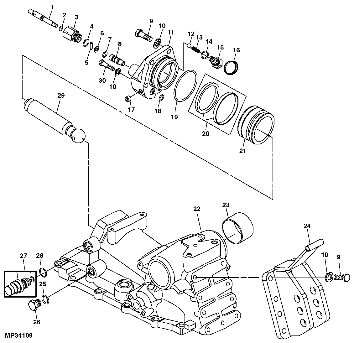

I have a new jd4066r and just bought a new two row planter and they asked me if I have draft control, where the implement flows with the ground...not sure if I do or not?

I don't know your tractor, but do you have two 3PH levers?

No just one

My tractor with draft control (TN55) has two levers -- one for position control and one for draft control. I'm no expert, but I thought draft control requires a separate lever/control.

Hmm...I wonder if I can add it as an option
   / does my tractor have draft control?? #6
I think it would be easier to add gauge wheels to planter than draft control to tractor hyd system.
I do know mybtractor comes with down pressure
   / does my tractor have draft control?? #8
The 4 series do not have draft control
But I would like to know more about the down pressure option. How does it work?
   / does my tractor have draft control?? #9
I too would like to know how a 4520 has down pressure on 3 pt seeing that RS piston rod isn't attached to RS piston. I bet with 3 pt hitch lowered with nothing attached one can lift 3 pt draft arms.
   / does my tractor have draft control?? #10
I've been sorta guessing that it is basically 2 hydraulic side links, and a way to lock the rockshaft in place. I've been wanting to see some pictures since they came out with the option.
