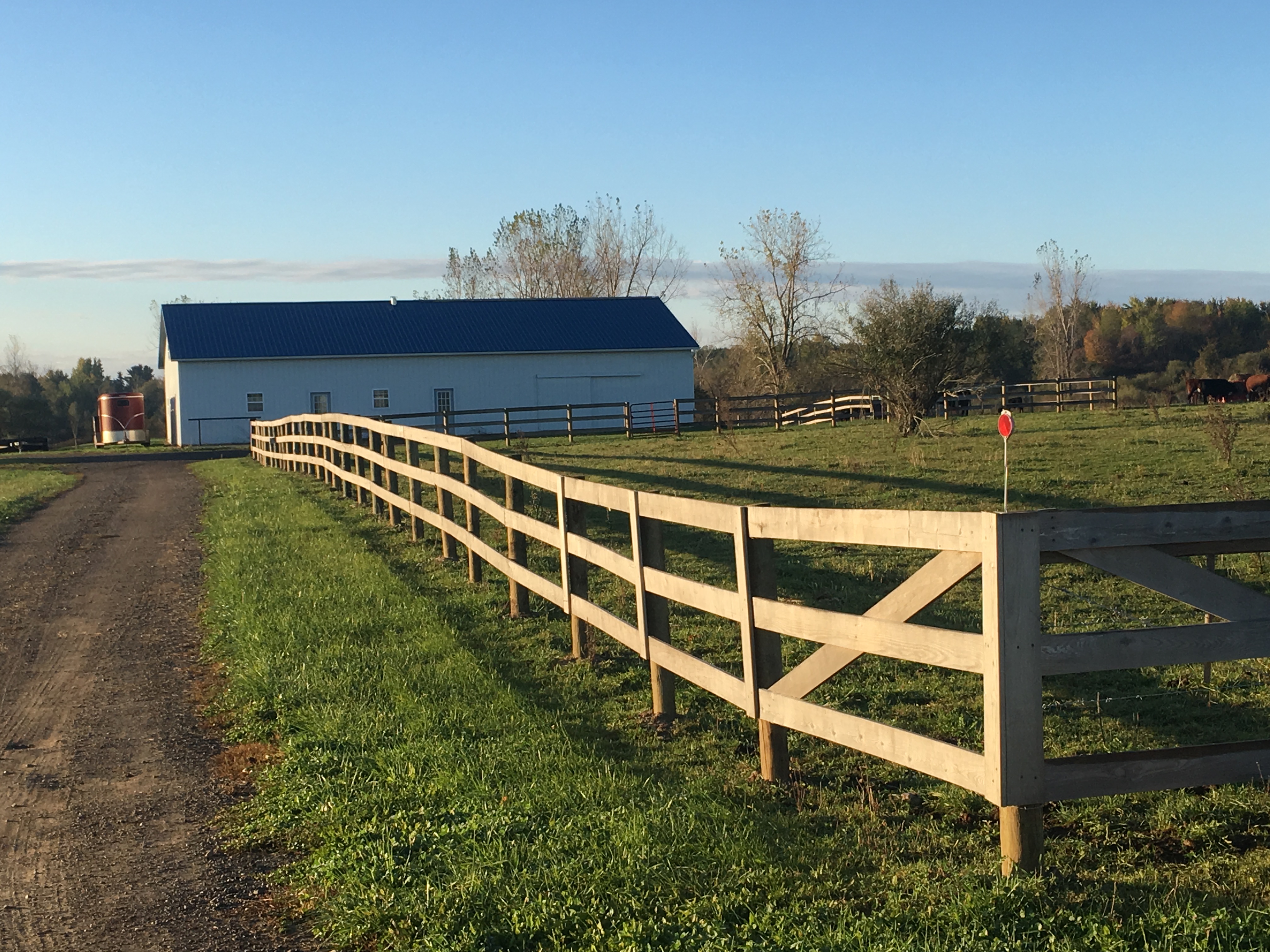

Tcreeley has a good point. I have used utility poles and railroad ties for corner posts for years now with good results. You cant buy a treated post today that will last as well - no doubt the ones that lasted better were bad for the environment or something. That's not to say i don't use modern posts as i have set probably at least 100 new ones in the last few years for anything from a round pen to board fence or barb wire. There are some good posts available. I get mine form an Amish man that lives up state from us. The posts are 8'1" long and average 6 " in diameter with some larger yet. IMG_3780.JPG Included is a photo of last falls project down at the new place
