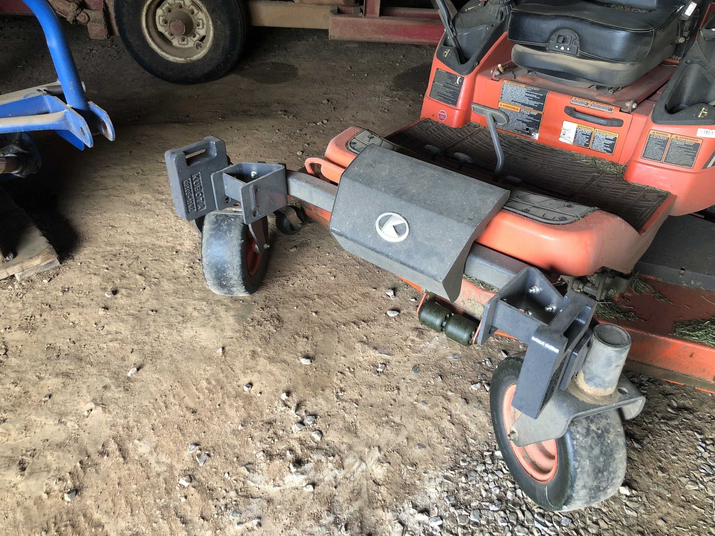

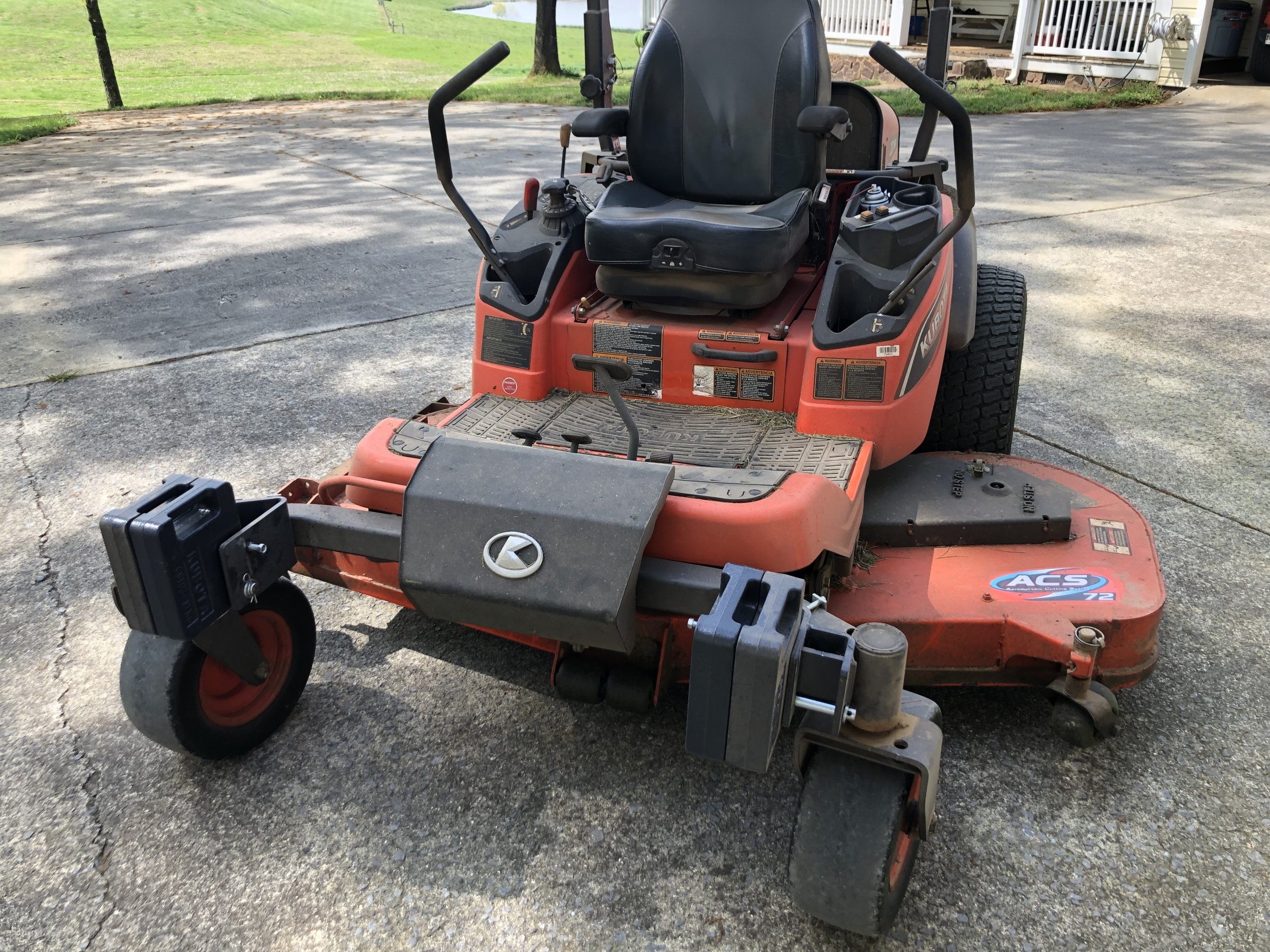

I made some changes to my ZD326 backup mower for mowing banks, and front weights would be a good addition.
I spread the rear wheels out with spacers and have filled ag style tires. Going up hill the unintended consequence of the great traction is the front end coming up very quickly.

The brackets & all hardware was $380 with shipping.
I’m not real sure on the 25lb suitcase weight yet as they haven’t came in.
Id guess the brackets weighs 20lbs per side with bolts & pins. So that’ll help too.
I have my rears fluid filled too & it makes a HUGE DIFFERENCE in Traction but it does rob HP climbing hills.
It Doesn’t spin near as bad.

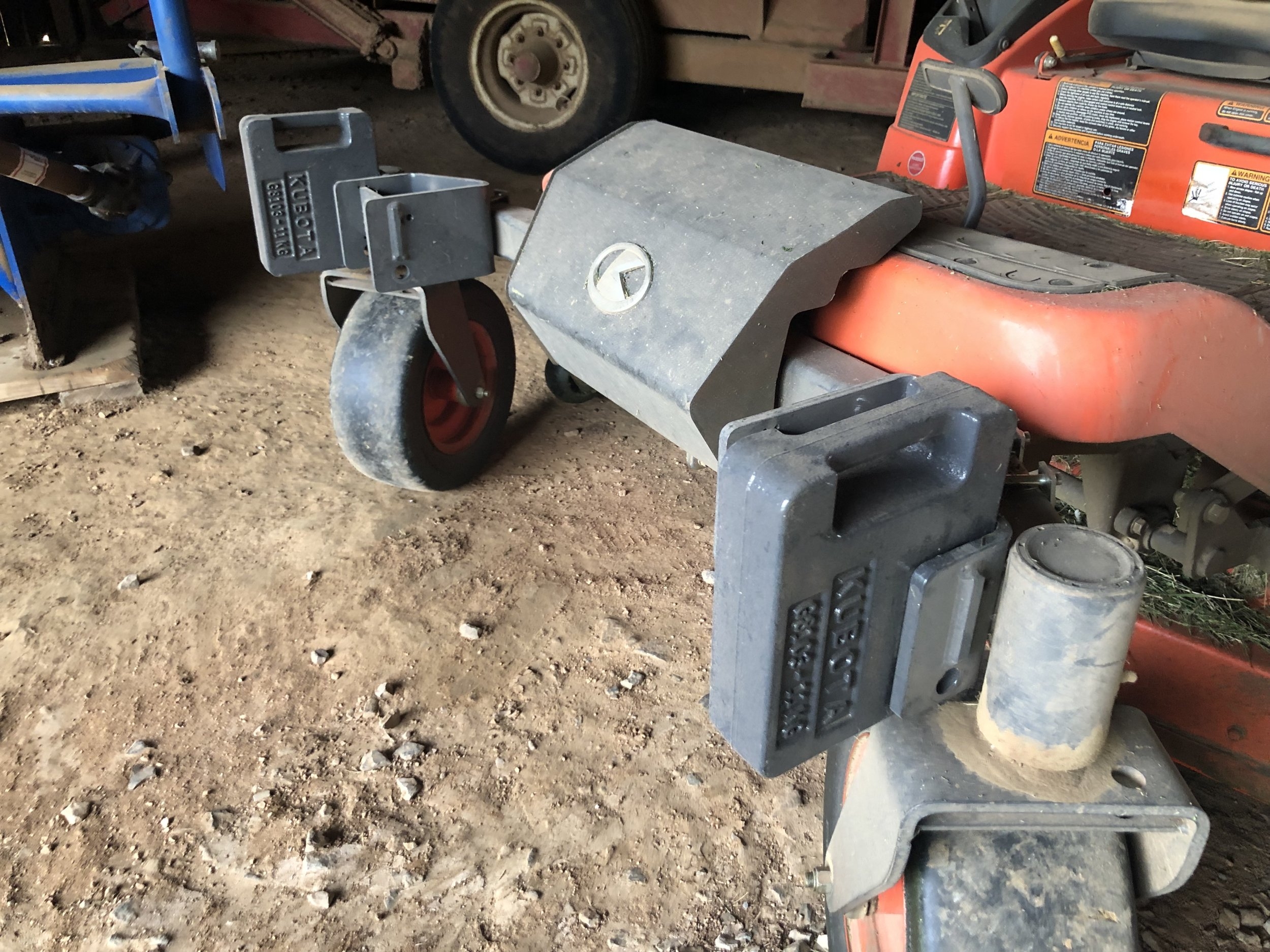

Finally got around to adding 2 suitcase weights.
It Helped but I need 2 more which I have 6, to keep front end on the ground while mowing my steep bank.
Each side will accept 3.
With 2 weights I still had to slide the seat all the way forward on the steeper areas so I’ll be adding 2 more weights.
It Rides So much better on my rough farm ground now.

4 weights today : mowed 4hrs on rolling hills. It Did great.
I’ll put it back on the steep bank in a few days.

I might try that. Do the weights “clang” a lot? Any drawbacks?
Wonder if they hasten the demise of the front axle pivot bearing?
Definitely have to remove weights to clean deck???
   / Does Kubota offer front weights for ZD12/11 / ZD1511 ? #20
I'm surprised they aren't drilled for a through bolt. You could always wrap a bungee around them. They appear to be pretty tight though.
