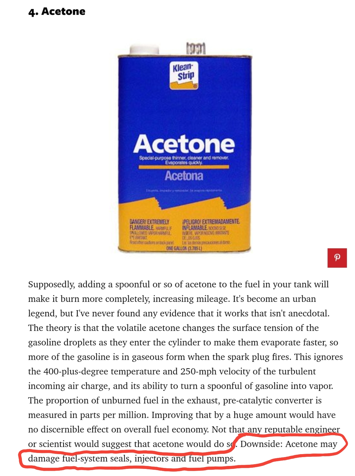

Old gas definitely goes bad. Faster in poly or vented containers. Many inexpensive to expensive 2 stroke oils have stabilizers and can explain the longevity in the original post.
As for acetone additive that's an internet myth. No advantage and a possible big negative issue. Buy a good stabilizer rated for ethanol and use in all low use or stored engines.
From Popular Mechanics magazine:
